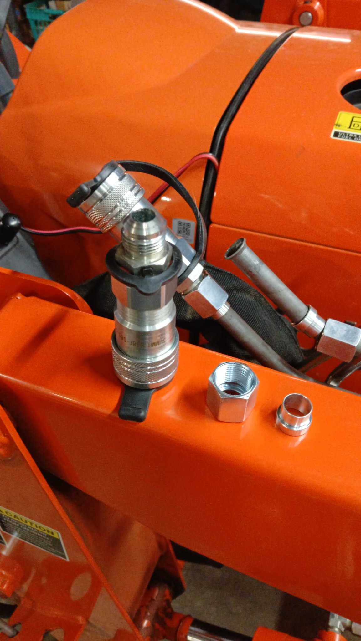

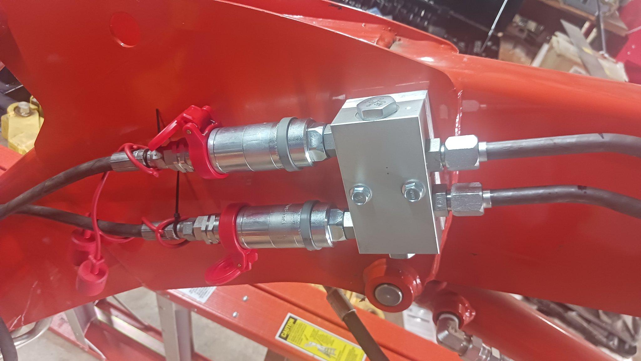

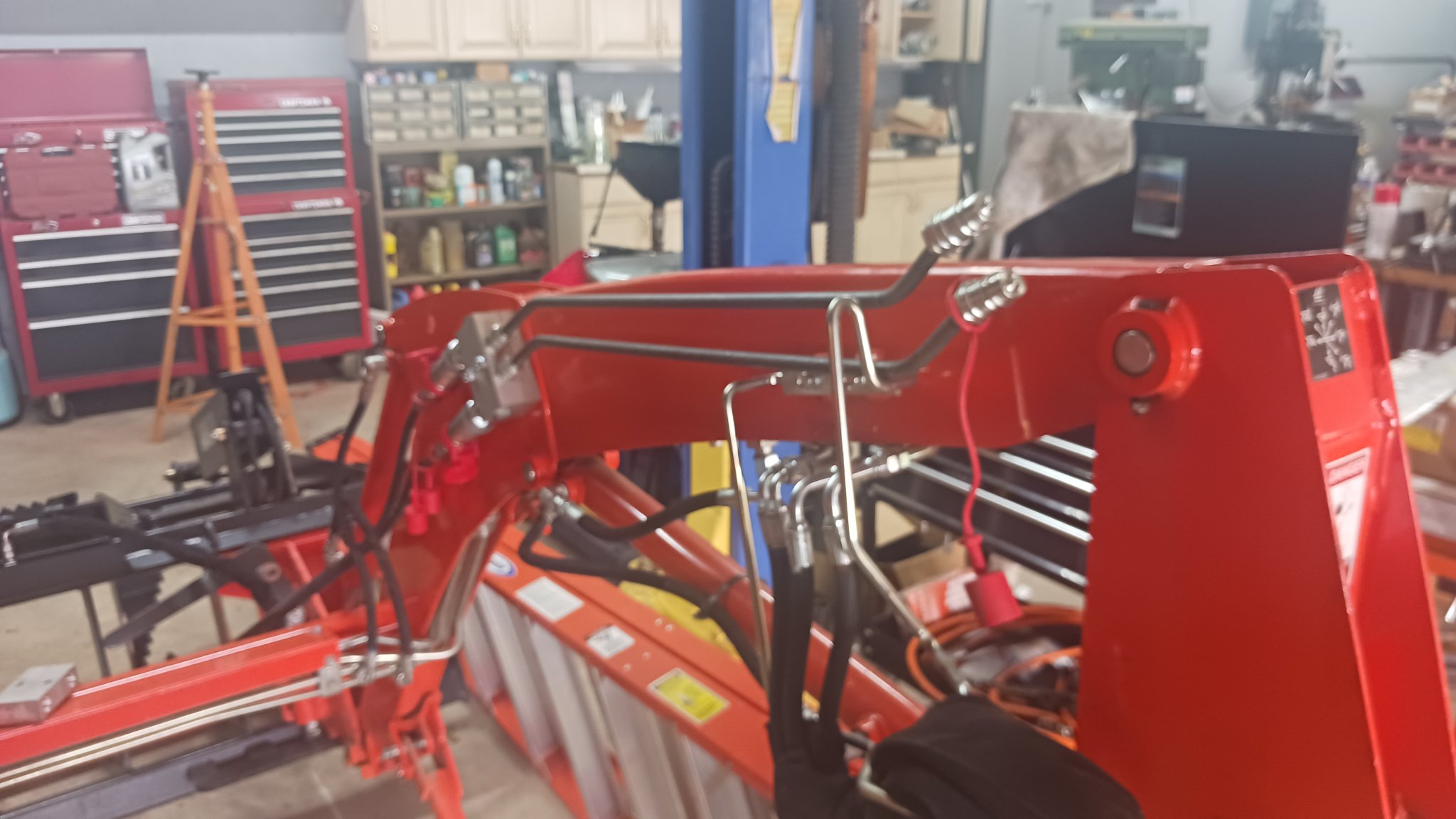

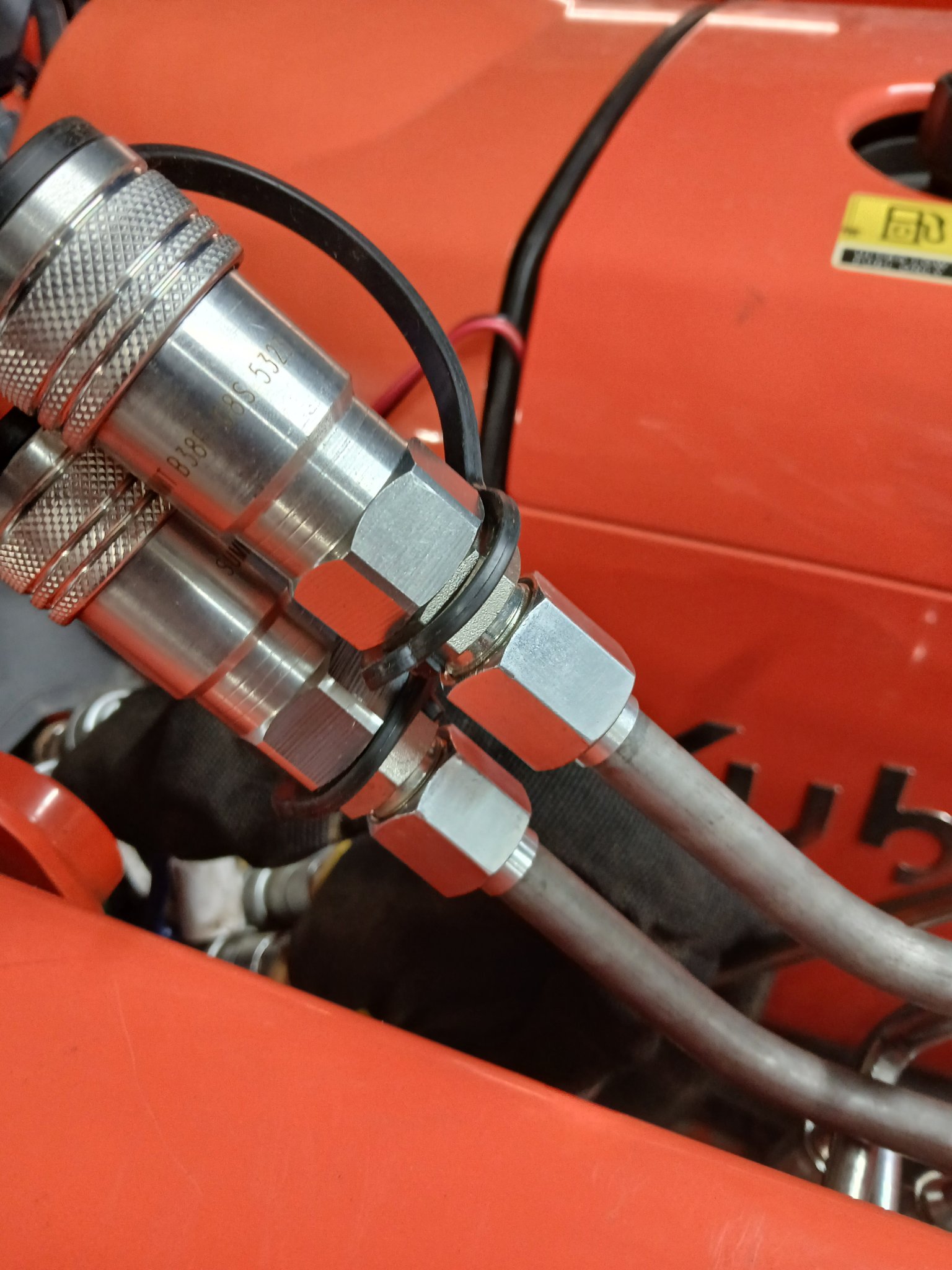

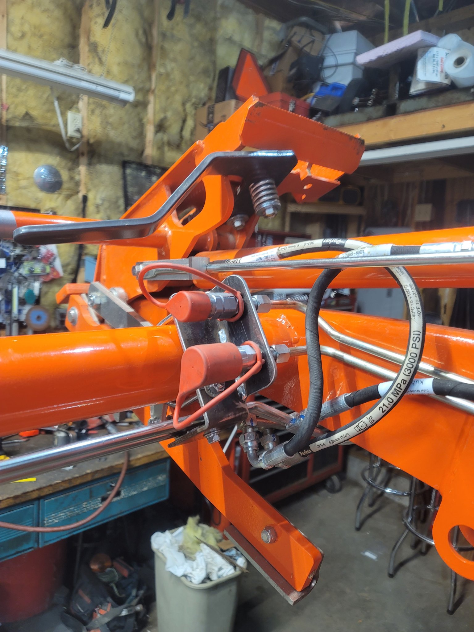

Yet another third function outlet. I am in the process of adding this to the LA525. Would have finished it today but I ran put of tube nuts and sleeves....
Two things that are a little different on this one are the one hand push/pull connect under pressure couplers which are mounted on a DPOCV.

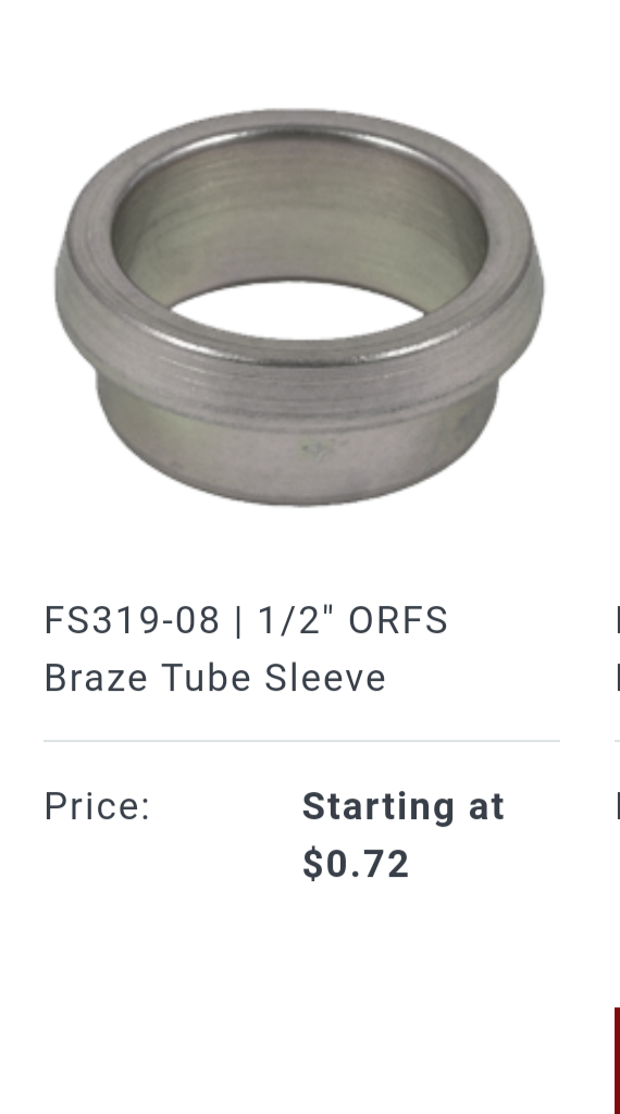

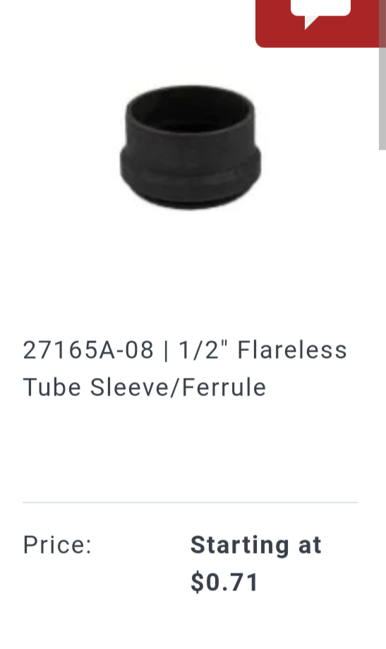

What kind of ferrule/nut arrangement is this? Screenshot_20240411-144517-774.png I was looking on Discount Hydraulic's website and saw some nuts and braze-on ferrules, but I couldn't figure out what fittings they mate to.
I have this grand plan to run 3rd function hard lines down my loader arms. I have the four for the FEL I took off that were all bent up where they went across the cross tube. So I was thinking about cutting the bottoms off of two of them and brazing something on to install QC's. The tops already have #6 JIC, so I can run short hoses to my valve.
I like the mounting block you have. I might can do something similar. It's pretty crowded down there with the lines, hoses, and bucket leveling linkage. And I still need to be able to swing the grill guard down.

Those are standard JIC 37 degree flare tube nuts and sleeves. They mate to male JIC fittings.
OK, that would be the 27165 right? All I found before was the FS319 ORFS, which I couldn't figure out. If I wanted a male JIC like the existing, could I drill the threads out of a 1/4" FPT adapter and braze it ok? Thanks Screenshot_20240411-154929-206.png

OK, thanks. I see them now. I didn't realize my flare tool might handle steel line.
I handled miles of process and power piping in my first career, considerable sanitary tubing in my second, and flared, double-flared and compression mixed in, but hydraulic is kinda new for me.
You need a 37^ flaring tool - specific to hydraulic applications. Most commercial and automotive is 45".
Watch out for the cheap ones with conical anvils - thet dont handle steel tube well. You want one with an eccentric anvil - much better flares with a lot less muscle. Here is whst I have. It works great on 1/2" and smaller. Have not tried anything larger.
Thanks, probably back to brazing.

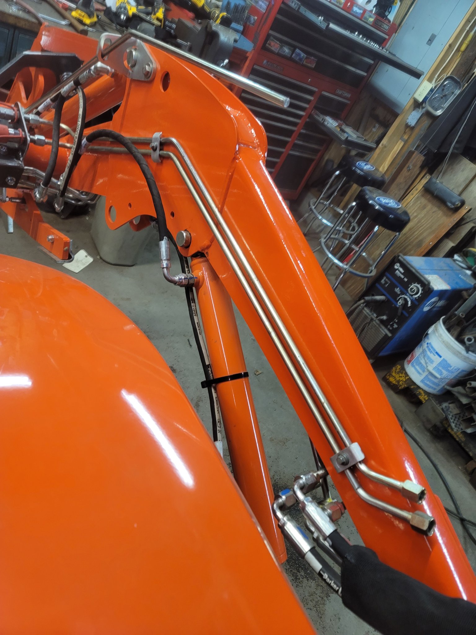

Seems we're on the same wave-length Dan. Mine's not as sophisticated as yours though.

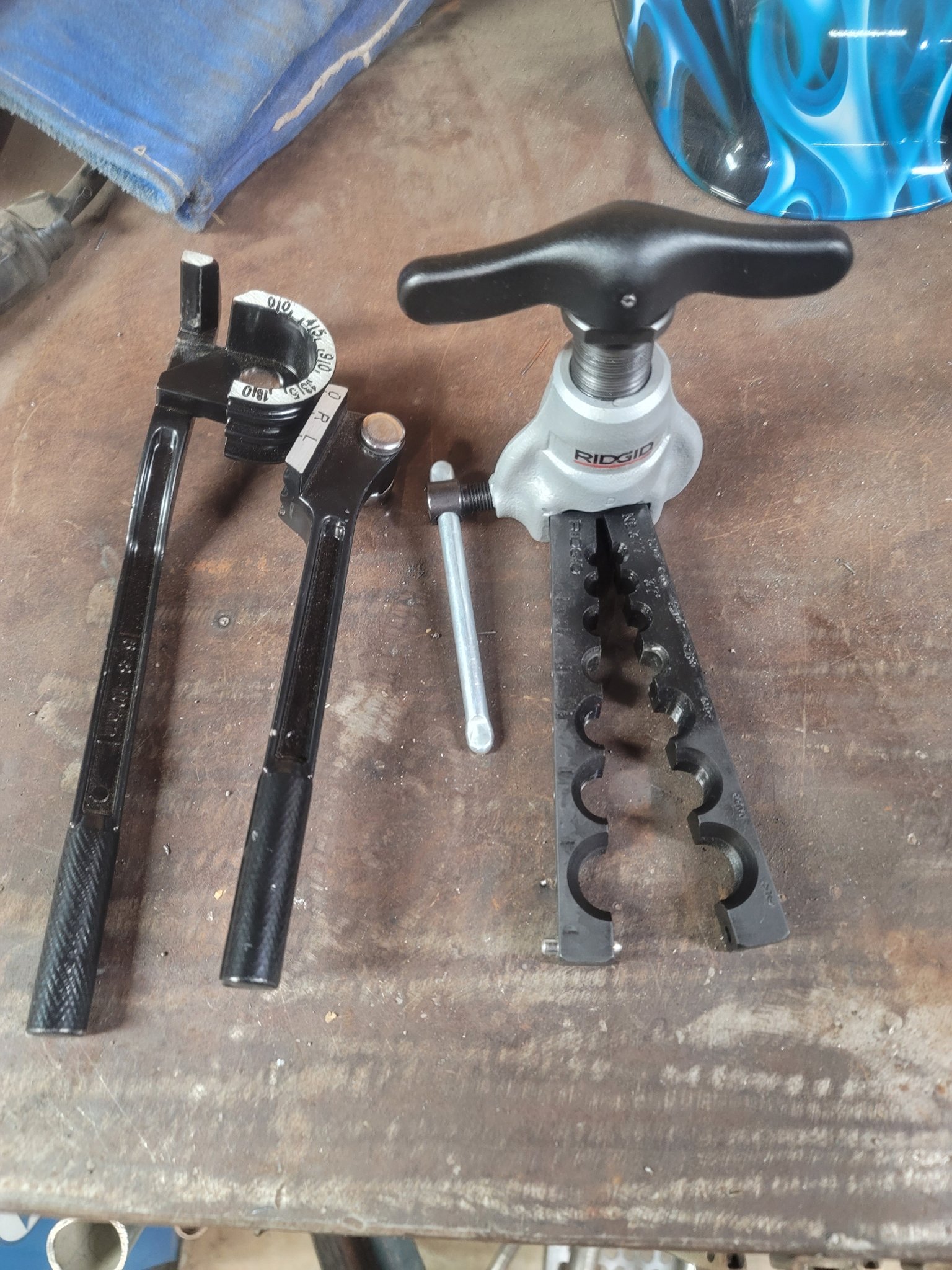

I went with the Rigid flaring tool and a HF bender.
Had this all laid out with hoses then remembered the bunch of scrap tubes I had laying around.
Steel tubes down the loader arm and from the solenoid valve behind the loader valve to the QDs near the loader connection.
It would have been easier to just run hoses but what's the fun in that!
View attachment 126208 View attachment 126207 View attachment 126209
Sophisticated schumisticated. Looks nice to me and IMO worth the effort. I had hoses initially and not nearly as tidy.
Hope you got your flaring tool before the price went north. I was flabbergasted when I saw the current ransom....

Hard line looks good.
FYI you can find a 37* flairing tool for less than the link Hokie shared.
Have you used that tool? Keep in mind you are not flaring soft copper water or NiCu brake lines.
As I said earlier there are two different flaring technologies.
The ones like the Speedway have.a traditional plumbing/brake line cone style anvil that is centered in the tubing and forced straight down by the screw. They are less expensive and there are plenty of them around.
The Rigid type tools have an offset anvil that rotates around the circumference in a single point of contact as the screw is turned. They are less readily available and more expensive.
When you start flaring larger and heavier wall carbon steel or especially stainless steel hydrauluc tube the force required to force that conical anvil into into the middle of the tube becomes an issue. They are physically hard to operate and the quality of the flare produced by the process degrades.
The eccentric tools require much less force, can handle larger diameter and heavier wall tube, and produce much better quality flares by rolling the edge.
Know the difference and consider your prospective usage and how they work before buying....

I got my Rigid 377 from Zoro a month ago for $125ish shipped to my door. It's 100 times the tool that SpeedwayMotors tool will ever be!
Not sure how I've been around 60 years without knowing about eccentric flaring tools. The Rigid tool works flawlessly, even with a newbie using it. I'm right at about $8 per flare now but I own the tool and can do many more. Now I just need a hose crimper!

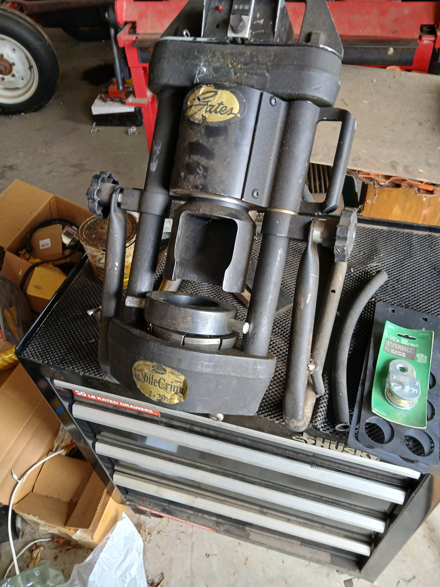

"Affordable" hose crimpers are very hard to find. I lucked out on this used one. It came off a mobil service truck and I got a complete crimper package with 3 dies and the air over hydraulic pump for $1200. It has paid for itself both in time and money.

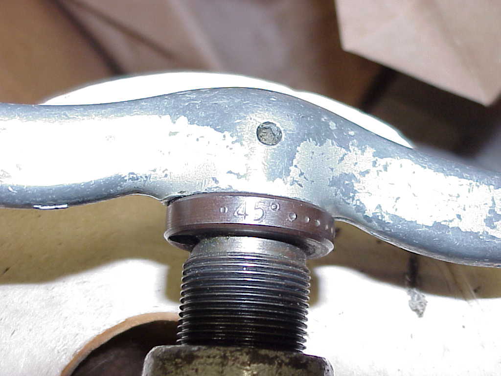

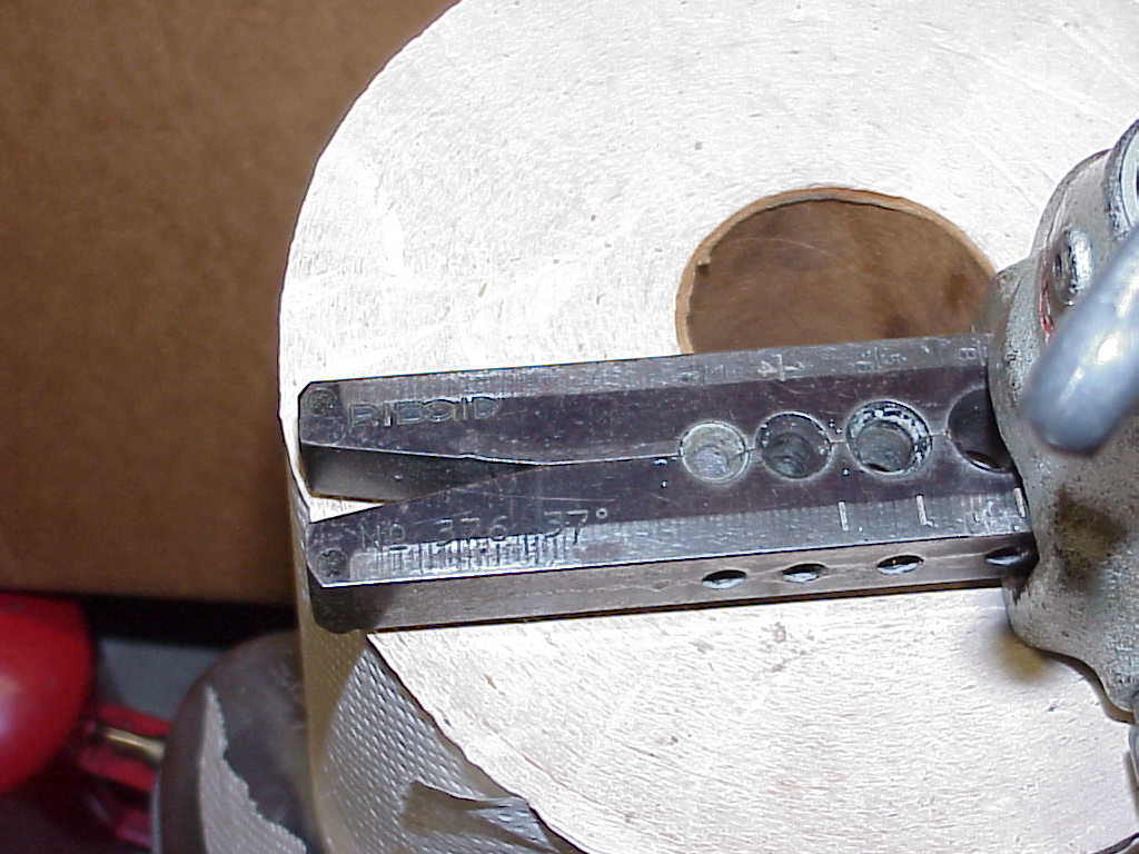

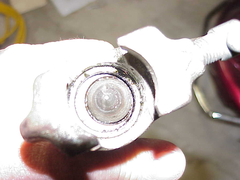

I picked up a Rigid flaring tool at a swap meet a few weeks ago, and just got around to looking it over. The bar shows that it is 37 degrees, and the upper part is marked 45 degrees. I closely examined the pointed part of the flaring tool and it appears that the pointed part rolls around the sides of the tube that you are flaring. Is this a mismatch of parts? MVC-010L.JPG MVC-011L.JPG MVC-012L.JPG
