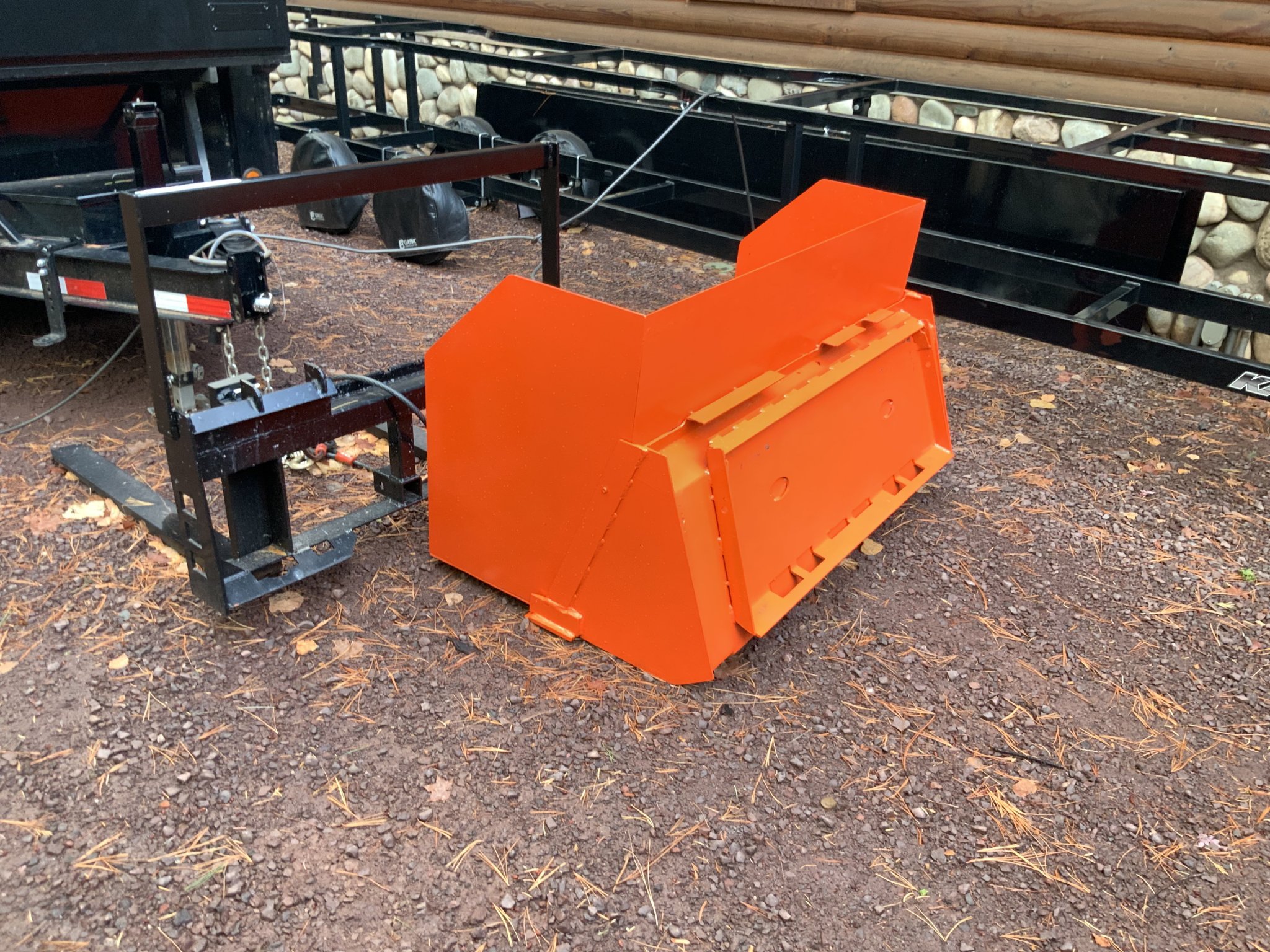

How do you like it? Use it much?
I have about an acre and a half that I clean once a year of pine needles, dead drops and crap from a lot of very big trees. I fill my 6x14’ dump trailer up 4-6 times just to clean up each spring. So it pays for itself each year! Like I mentioned...I had the bucket as I replaced it with a QA set up...so I cut the ears off and welded up the sheet metal to make it structurally sound. The bottom plate is 3/16” so that it won’t bend or buckle under load.
Yeh, that's pretty much my application as well. You're also making me feel good as I've got ~2.5 acres and some folks think an L is too much machine, but I like everything it does :)
