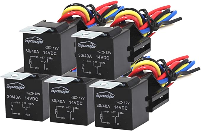

Flip and others: I found that many times OEMs use very common 40A automotive relays for a lot of items and even at local parts-stores FULL RETAIL they are much less expensive than from the OEM.
Then, one day I found THIS FIVE-PACK of genuine BOSCH common auto-relays for $12: https://www.amazon.com/gp/product/B017VDI0GY/ref=ppx_yo_dt_b_asin_title_o03_s00?ie=UTF8&psc=1 D8A0FAA3-4A90-44C0-B1B7-EB994E6104F2.jpeg
Then, one day I found THIS FIVE-PACK of genuine BOSCH common auto-relays for $12: https://www.amazon.com/gp/product/B017VDI0GY/ref=ppx_yo_dt_b_asin_title_o03_s00?ie=UTF8&psc=1 View attachment 49683
