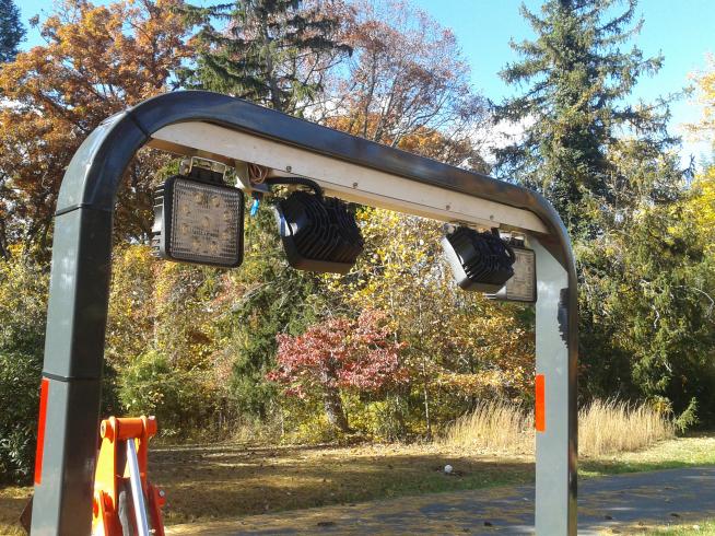

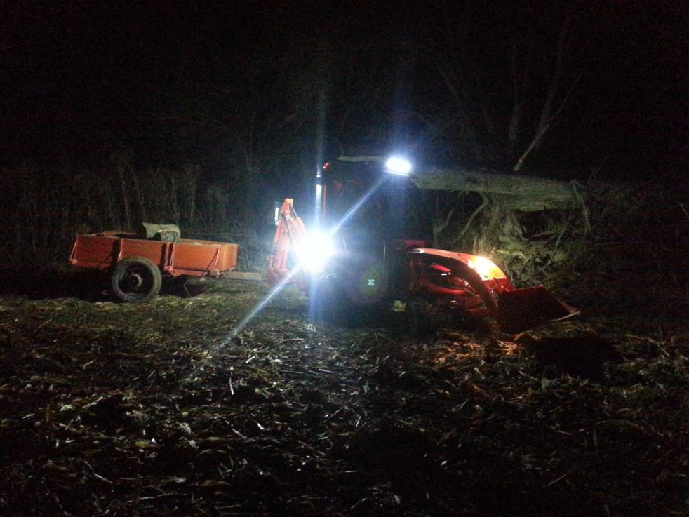

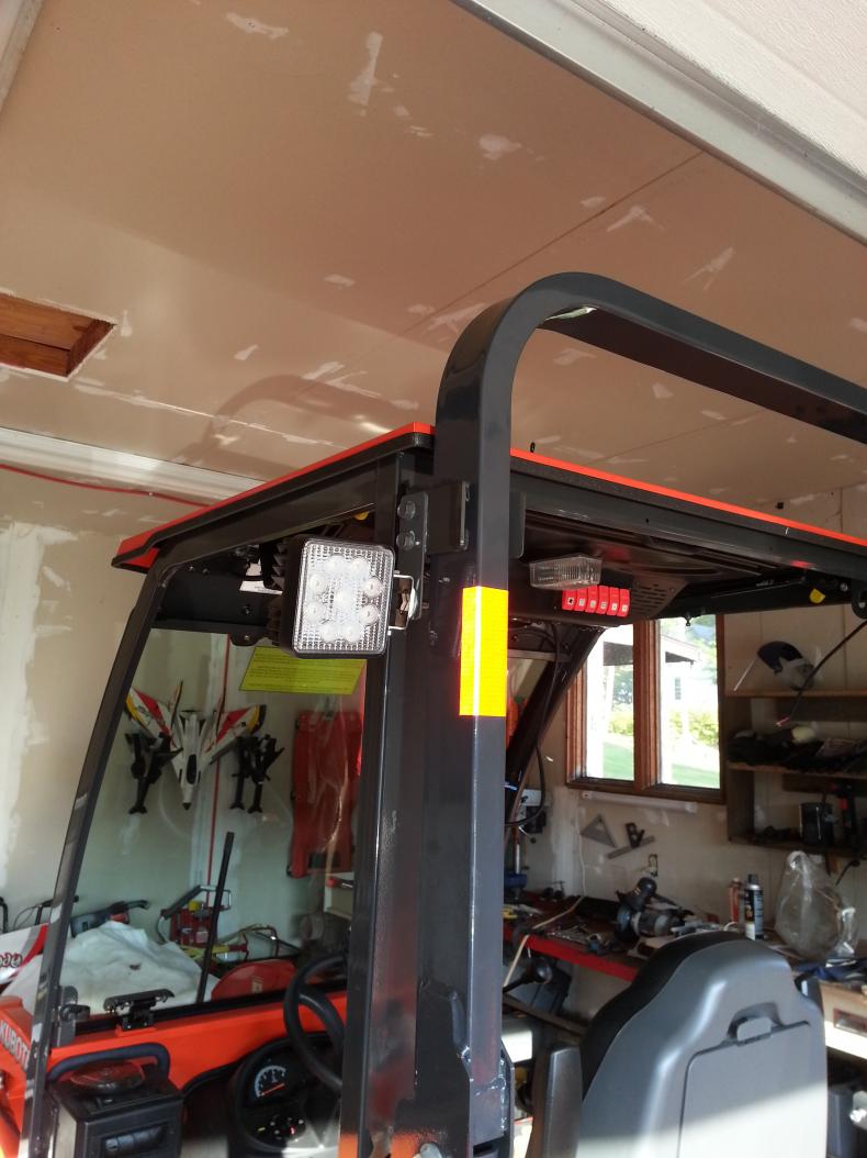

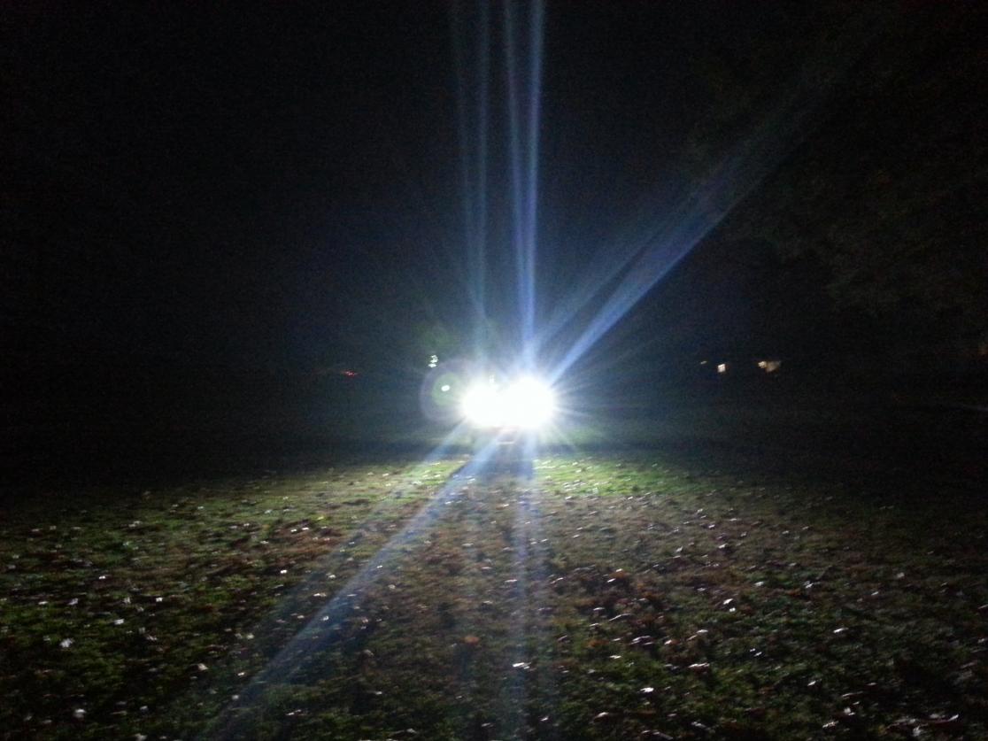

Bandaidmd, that pattern looks fine in the picture. When I did quick and dirty mounts for the forward-facing lights they were strictly for mowing and in much the same position as yours and lsmurphy's. When we put the cab back on Saturday the forward lights were relocated to the brackets above the windshield. That made a big difference in the illuminated area.
Two rear lights are mounted on the inboard sides of the ROPS. They are aimed "crosseyed" so they light opposite sides on the ground.
I don't think murphy has done his lights yet, that's my tractor in his post.

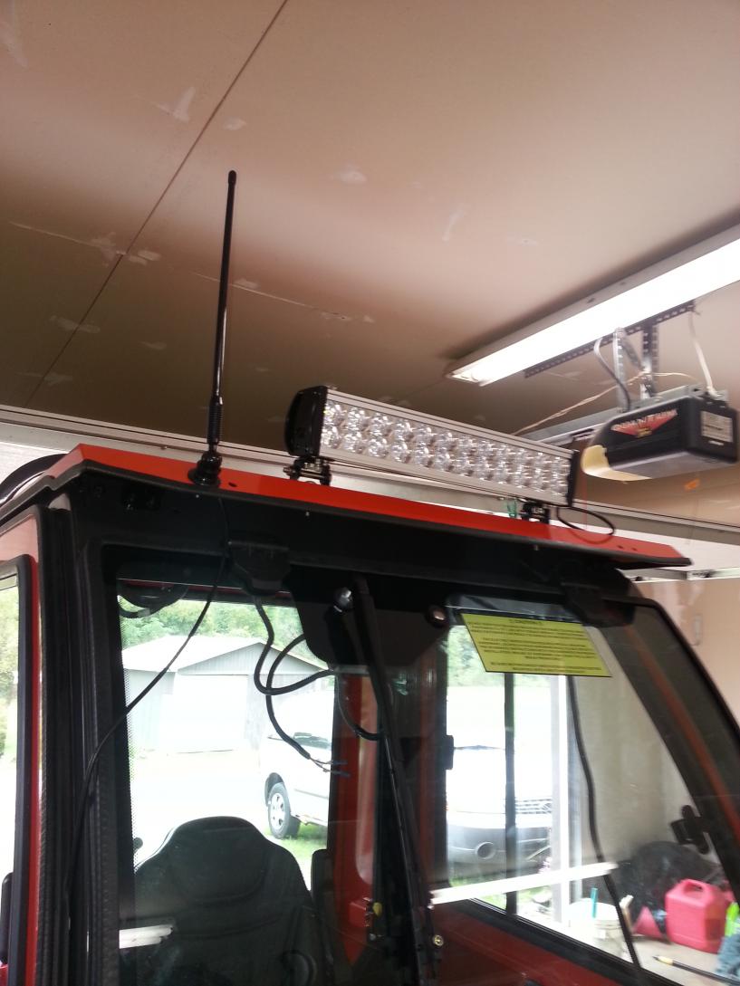

I put a 20 LED, 4000 LUM., light bar on top, to light up the front when the FEL is in the up position.
Added two 9 LED, 1450 LUM , FLOOD work lights on the rear.
Added two 4 LED 750 LUM , SPOT lights on the side, did not like having dark areas when working at night.
