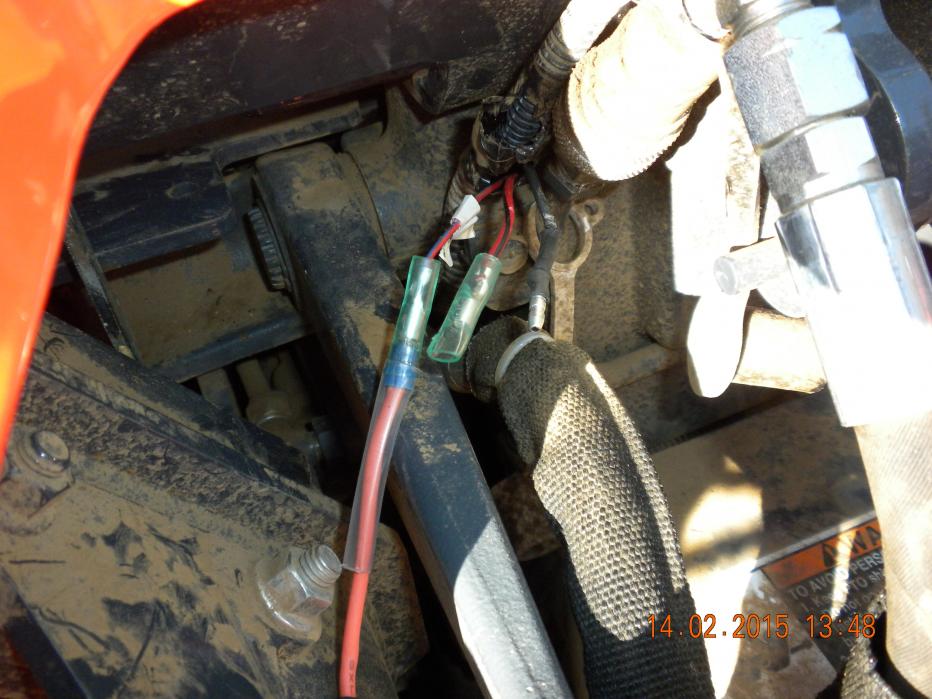

Glad you are wiring some lights to the BX25D, there are many posts here on OTT about ROPS lights. I have recently found 3 wires under the rear left fender near the 3pt as shown in the attacted picture. Black wire with male pin is ground, red with black stripe (female pin) is always hot even with key off, and the red with the blue stripe (female pin) has a factory white tape with the letters (RL) is only on when the key is on. I assume the latter means ROPS lights. Hope this helps some BX25D owners out there who would like to install some LED lights.
The ones I am using are bright, very bright and are connected to the constant hot wire with a switch box so can put them on before having to start the engine or accessory switch (mostly in a dark garage).
Will be glad to help with any questions.
