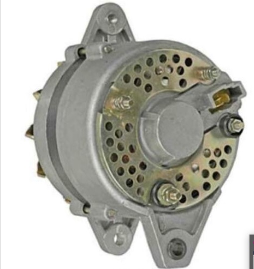

Yes it does from what I can see when I look at the picture. My alternator has a 3 terminal plug in at the top. The top terminal is horizontal and has the letter (E) above it. The bottom 2 terminals are horizontal. The left one has the letter (F) next to it and the right one has the letter (N) next to it. One the far right side of the alternator is a bolt terminal with the letter (B) next to it. I assume your pictured alternator is the same? This is an MCR brand and model # 12068N.
I too am stumped. Thanks Chuck

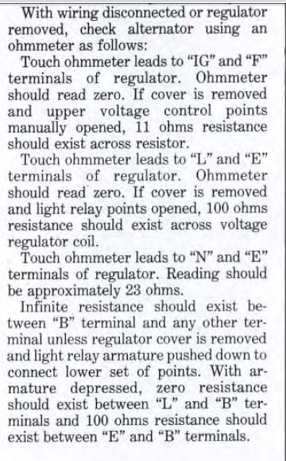

I know you measured the output voltage. Can you do the resistance test I provided on the regulator?

Dave since my regulator has no (L) how do I do this resistance test?
Thanks Chuck
Chuck

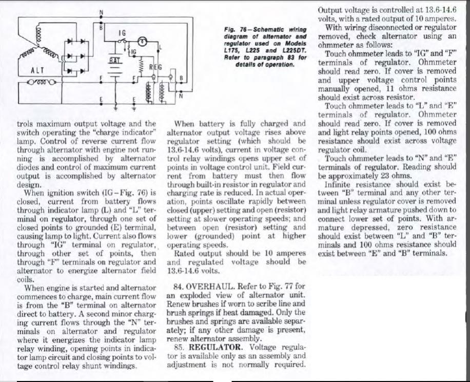

I have attached more wiring info. It is difficult for me to tell from the diagram except that L is the wire for the no charge light.
One of the two contacts in the regulator is to turn on the no charge light.
Does the new alternator have an amp rating on it? The system was designed for an alternator with an output of only 10 amps and the regulator has no provision to control the amp output. If the new alternator is a greater output, it is concerning. The wiring will not have been sized for more amps. The battery may not be adequately protected.

Hi Dave. More confusion on my part. I am unable to do the resistance tests you sent me the info on.. My regulator only has 3 terminals IG, F and E. Your info shows an L terminal used for testing which I don't have. After again going over the manuals regulator alternator info so so kindly sent me I am confused. The manual says the non-charge indicator lamp system has 3 terminals just like mine. The manual also shows the charge lamp indicator system as having 6 terminals. That is where my confusion comes in. Before my alternator went bad the charge lamp indicator was working on my tractor. Can you make any sense of this?

The MCR 12068N is a replacement for a Denso 121000-0980. That is rated for 35 amps.
Thanks for the info on the MCR alt.
It is because the WSM I found says the original alternator was only rated for 10 amps that I am concerned about just connecting it to the tractor's wiring and its regulator.
The eBay seller's product description was possibly misleading when it said the product was for an L175. Perhaps physically but not in other aspects.
