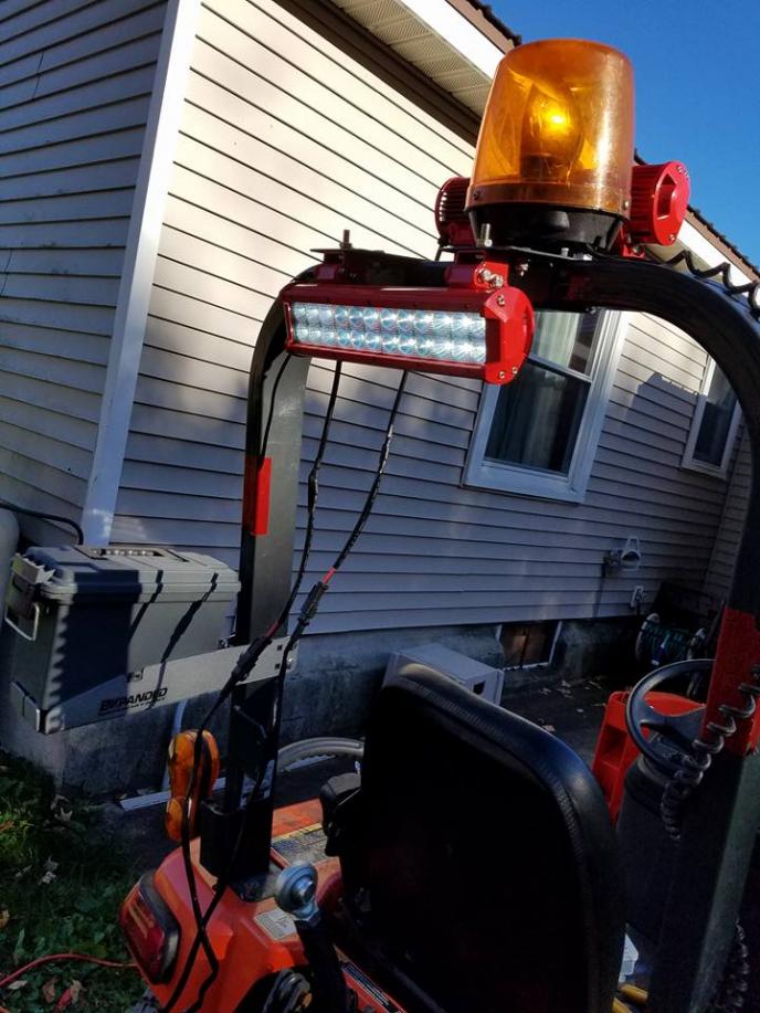

Look at the bolt-on stake pockets. They fit perfectly around my rops.
I ordered the bolt on stake pockets and they're perfect for the ROPS on the BX2350. I am going to make the flat brackets to bolt up to the stake pockets. I decided to go with two 12inch LED light bars instead of four 18watt cube style lights. I figured it would be easier to wire up.
http://www.ebay.com/itm/201637993135?_trksid=p2057872.m2749.l2649&ssPageName=STRK:MEBIDX:IT
I painted the stake pockets ROPS grey and will do the same with the mount brackets.
I'm still going to use the wireless remote wiring harness. Found a nice one that should work well. Waiting for the lights and harness to arrive.

Got the wiring harness mocked up and my LED light bars mounted to the ROPS. I think they look pretty good so far.
