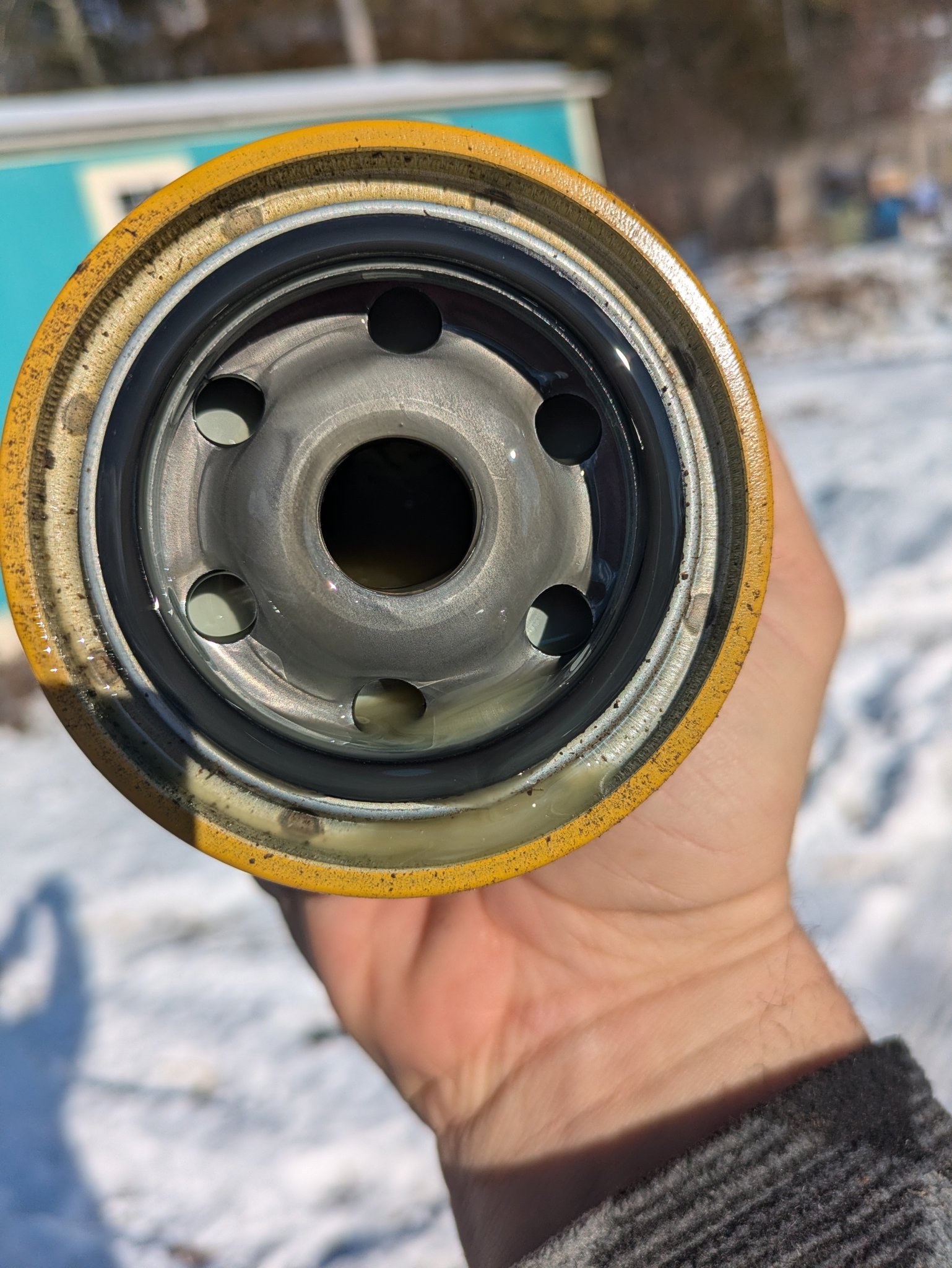

Well here is what the hat filter looks like. I'm not seeing ice crystals. It's 30 degrees today so maybe I waited too long as it was a lot colder yesterday and most of the week for that matter
That said, I fired it up and...the pedal still ain't moving the tractor and the stick still ain't moving the bucket. What are the odds that both pumps failed simultaneously on a tractor with 200 hours on it? How do I test that?
Also, could there be an ice crystals clog upstream of the filter somewhere?

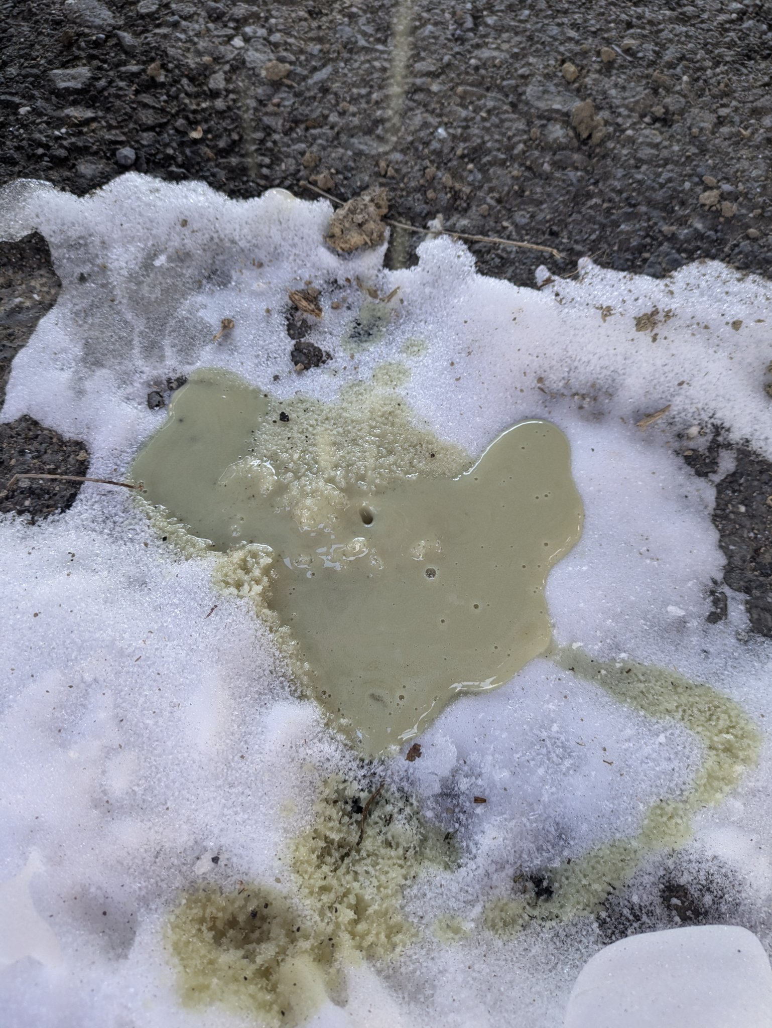

Attached is a picture of the oil that dropped out after I shut the machine back off and pulled the filter off a second time

that 'oil' sure looks like it's mixed with water, to me....
hopefully you can get it into a garage, get tractor real warm, drain all oil.
It'll day a day or 2 ,as 'internal' will be frozen even though 'shell' is warm.

Yep, plenty of water mixed in there. I'd pull the plug where it sits and let it drain into a bucket for weeks on end, if needed, until it warms up.
Pure speculation here but just pushing that type of viscosity (icy water-flavored SUDT2) is likely every bit the issue as an ice crystal in a tight nook or cranny. The resulting backpressure from that goo must be tremendous.

Like others have said the fluid looks packed with water.
If you want validation drain into a container and warm it up and look for separation of the fluid.

Update: today is started draining the fluid. Man is it goopy. Nice smooth stream and then a few pasty white chunks. I can only assume those are ice chunks. We're right around 32 today and below freezIng nights but we've got a stretch of several days of high 30s to low 40s coming at the end of this next week so I'm leaving this open for the next ten days or so.
More to follow then
