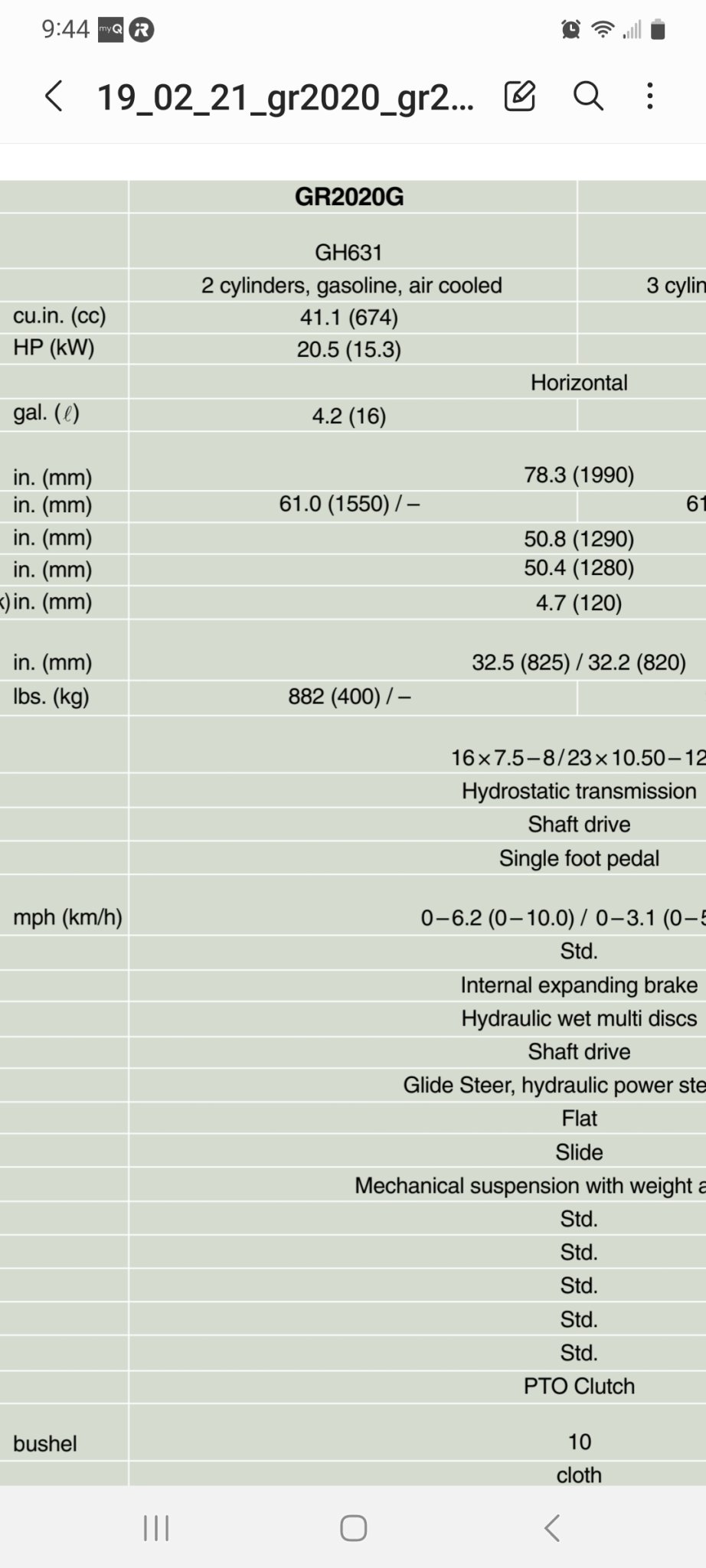

12,817
5,592
Kub CDA offers BOTH gas and diesel engines....
Also for winter storage, I suggest getting tires off the ground and adding 2-5 PSI.
I've seen far too many tires with GREAT tread and sidewalls cracked
