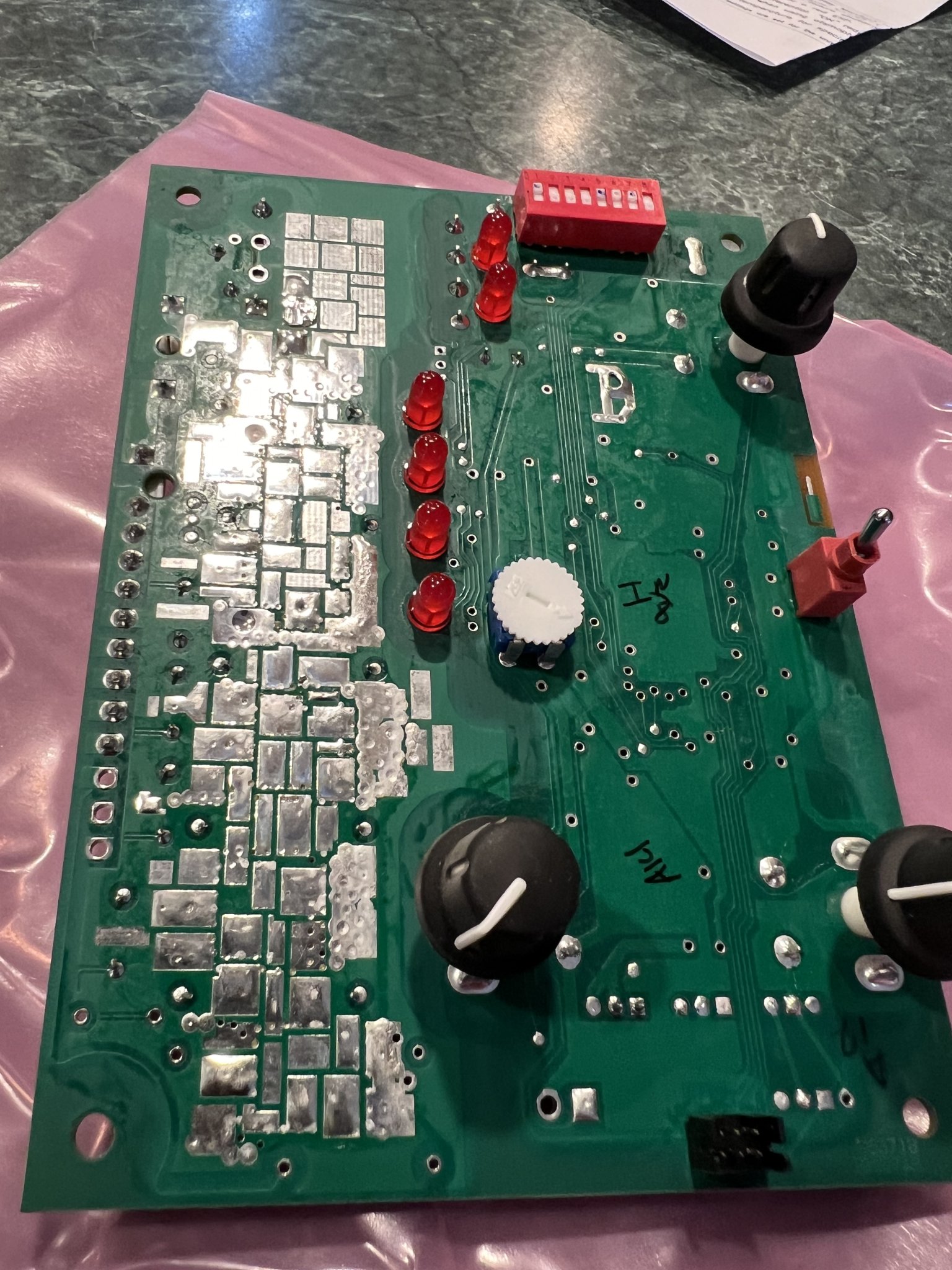

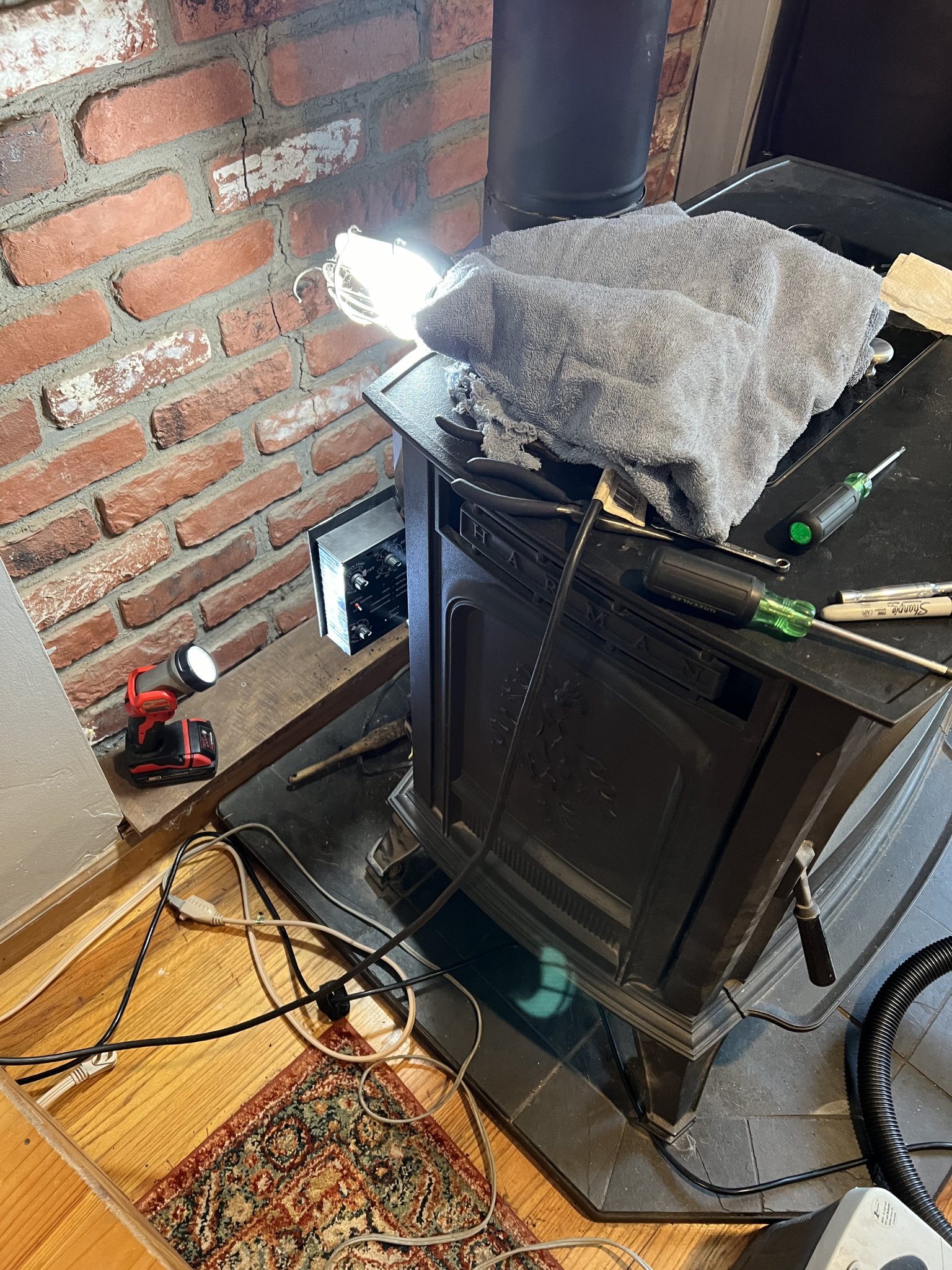

I've replaced the circuit board twice already in the Fall of 2024?!?!?! :mad:
Started to get stove ready. It blew a fuse on the circuit board this spring - right at the tail end of heating season. Replaced fuse this spring, but didn't need heat anymore.
Last week acted like board was shot - - stove would not power up at all and fuse did not blow.
No worries - - one on the shelf since 2021. OEM and current superseded part #.
While all the components of the stove ran, NONE of the controls on that board worked right?!?!? Dipswitches were all set properly.
Also threw a code of a bad exhaust sensor probe (which probably wasn't bad - but for $12 replaced it:(). That sensor is a pain in the neck to get to and took some patience. That was self-inflicted - I should have left it in. Still have another on the shelf.
Got another 1-00-05886 circuit board in 2 days - also OEM. All's good so far but haven't test fired yet.
