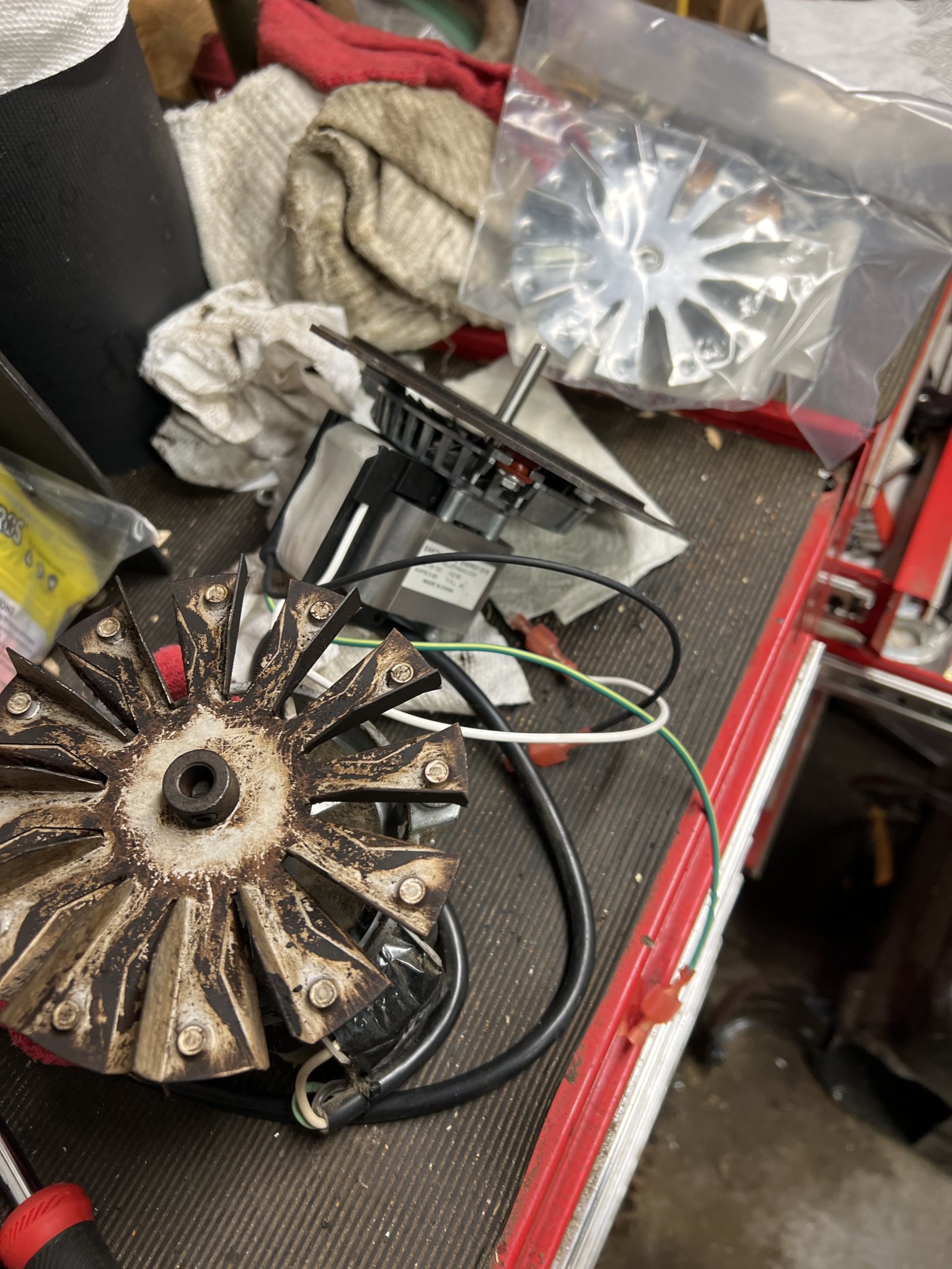

Seems like July 4th was last week.
Have pellet stove torn apart for preventive maintenance stuff. We burn 5 tons per season.
Only use about 20 gallons of heating oil through our boiler and hot water baseboard system.
Igniter blew during power outage April 19-23.
Generator was only running 107-111 volts. Fixed the generator since, but still need to replace igniter.
Hoping it didn’t fry the circuit board too.:confused:
Figured I’d change out combustion blower too. Motor feels a little “gritty” and is a couple years old.
Same Harman XXV Pellet stove we’ve had for years. I know a few guys here on OTT have experience with them. Great stoves. I keep most of the parts on hand anymore.

I clean the combustion fan blade with Spray-9 and hose off works great on cleaning the glass as well.
