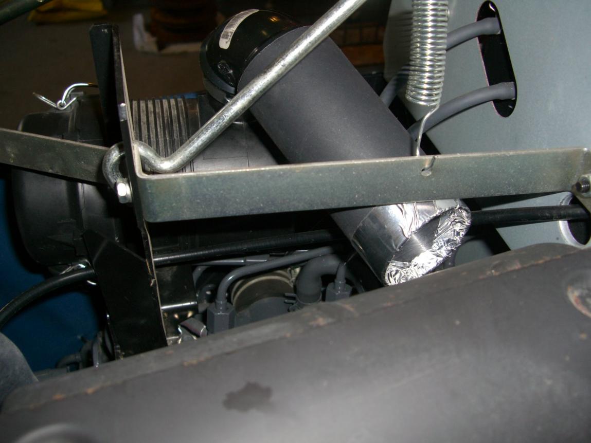

Well, following on from the posted issue of black smoke due to the air filter being blocked with snow I thought I would have a look at a mod.
I have not altered or damaged any of the existing items and will reinstall the standard intake come grass cutting season.
As the problem stemmed from light blown snow entering the intake at the front and causing the blockage. So I though that an intake close to the exhaust and pointed slightly back might be a simple fix.

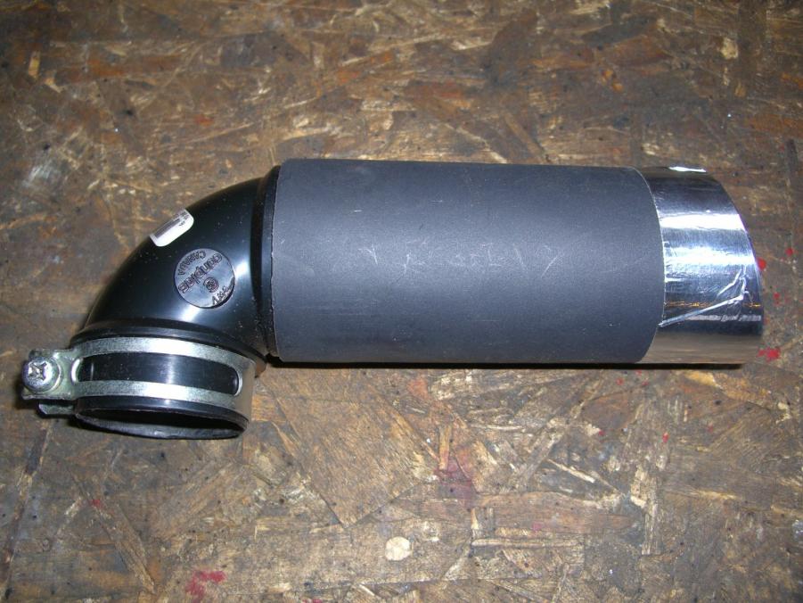

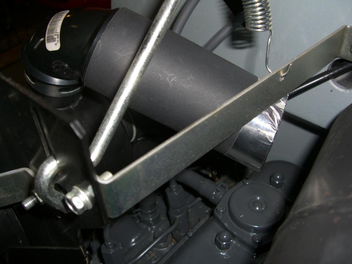

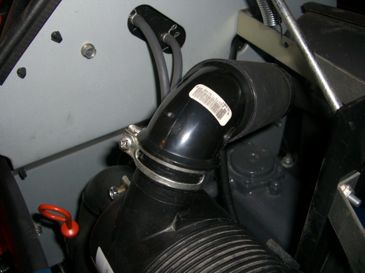

I used a standard 1.5 inch 90 plumbing bend with a male/ female end, I used a Dremel with a sanding drum to increase the inside diameter to fit snugly over the air cleaner spigot, added a short section of 2 inch thin walled tube , cut a slight angle to allow for clearance to the exhaust, it is about 1.25 inches from the exhaust and covered the end with aluminium tape to add a small level or heat protection.
I cannot forsee any issue with heat and as the air temp is generally cold when in use. There should be no issue with combustion intake temp.
some images. Oh, cost $1.49 slightly less than a Kubota part I am sure.

That looks great, I thought about putting a 90 and having it point down the engine bay, but I like yours better.
I was concerned about pulling in excessive heat from the engine, but since kubota recommended removing the intake pipe altogether on the 3350 in the winter, this is going to work well.

When I considered the route and position I also looked at the intake opening which in the case of the B series is flattened out from the 1.5-inch pipe.
I used the same ID bend which is about the same radius as the Kubota but took the intake tube as the OD of the bend which upped the size to 2 inches. I appreciate there is a reduction at the transition but nowhere on the run is the diameter less than stock.
Length wise, I am not concerned.

Well, we had another ice event last night so it was out with the ice ripper and the full intake cover set up and new pipe.
Tractor ran without issue, and the temp for the first time since I got this machine lifted off C.
I ran it for about 30 minutes and called it a success.
I have no idea how I would have turned 3/4 of an inch of ice into anything other than a skating pond without the ripper, it did a great jub.
