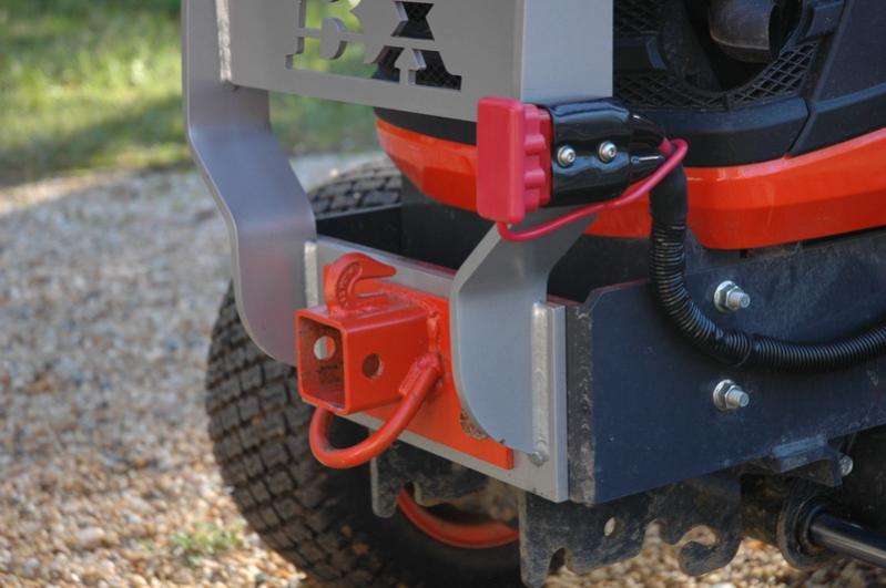

I bought a Warn 4700 Utility winch. I got that one because it works with the Warn Wireless remote (supposed 90' range). I have the winch mounted on a 2" receiver plate and put a mount on the front of my BX. I also bought a bunch of Andersen connectors, installing one on the front of the BX and one at the bumper of my PU.
I have run the winch for extended periods (enough to get the motor hot enough to burn my hand) and not had a battery issue.
