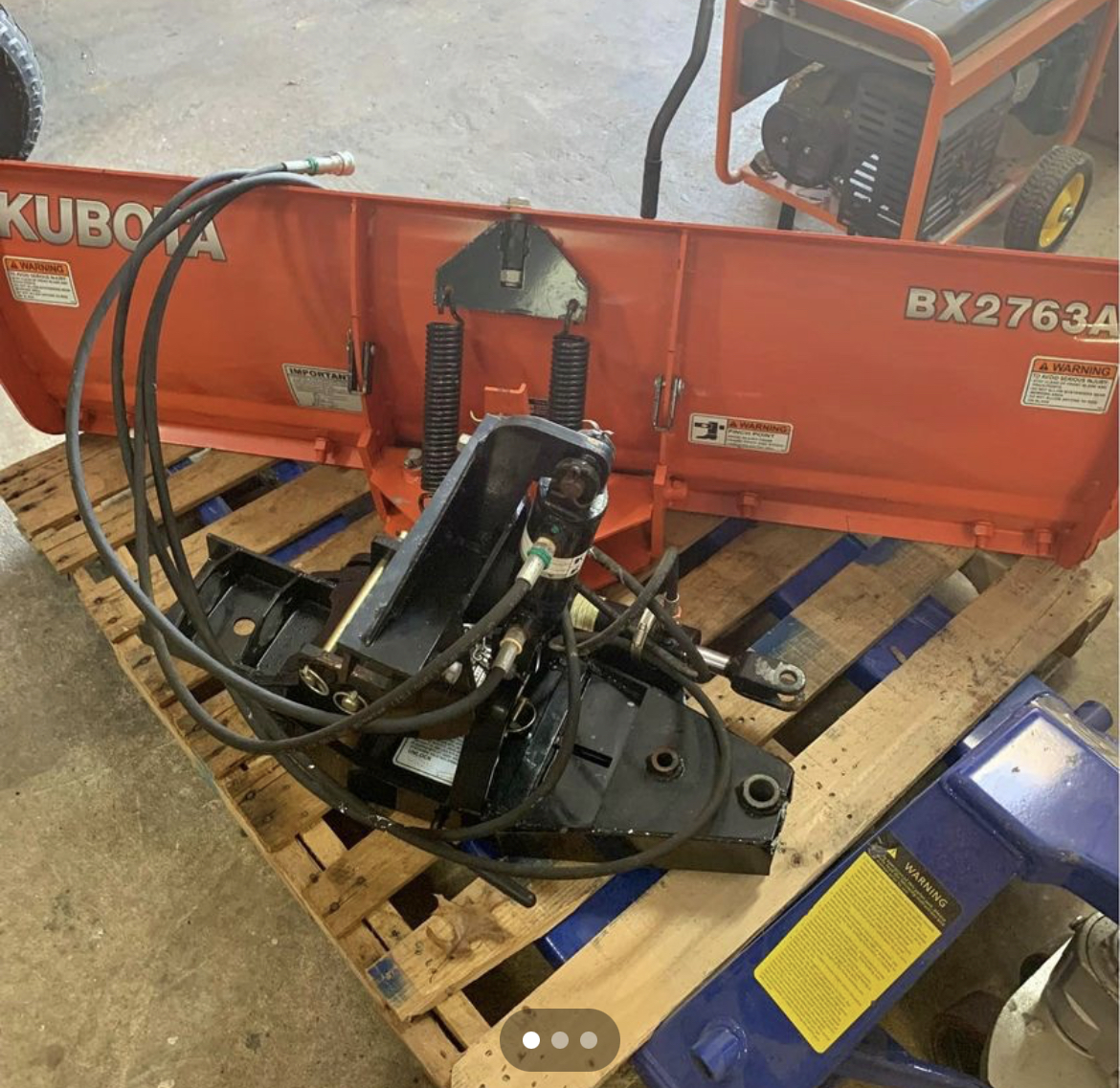

I just ran across a posting for a bx2763A front plow with the bx2751 front quick attach. Posting says it’s from a 2019 tractor, but not what model. It does not appear to be the more updated curved plow blade. From what I can find both of these will fit my tractor, though I’d have to remove the grill guard, and swap the hydraulic connectors to flat face (yes I know some people hate the flats)
questions:
-do these in fact fit my machine?
-is there another piece which gets installed on the tractor, or does it just lock up to the same plate on the front which the MMM hooks onto?
-does it seem this QA is missing the T-pins with the wedges on them in favor of just bolts?
-what’s a good price for this combo to be offered for?

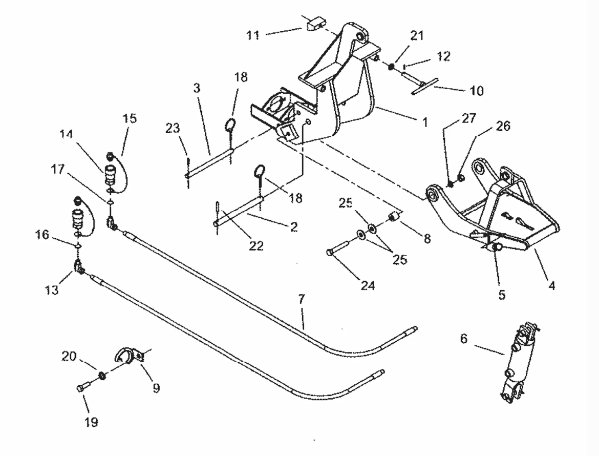

that’s what I’m having trouble finding. The subframe exploded view on messicks appears to be all included (plus the listing has the plow portion of the connection attached to the subframe vs the blade) minus the T-pins/wedges. Those are about $70-80 to replace them if they are indeed missing (parts 10, 11, 12, & 21)
I found a video of someone connecting the older style (not the four point quick attach) snowblower with the same subframe. It looked like it just slipped over the weight carrier, and then the pins slid through the bracket where the MMM connects at the front. Messicks doesn’t list a different part they looks like it would attach there.

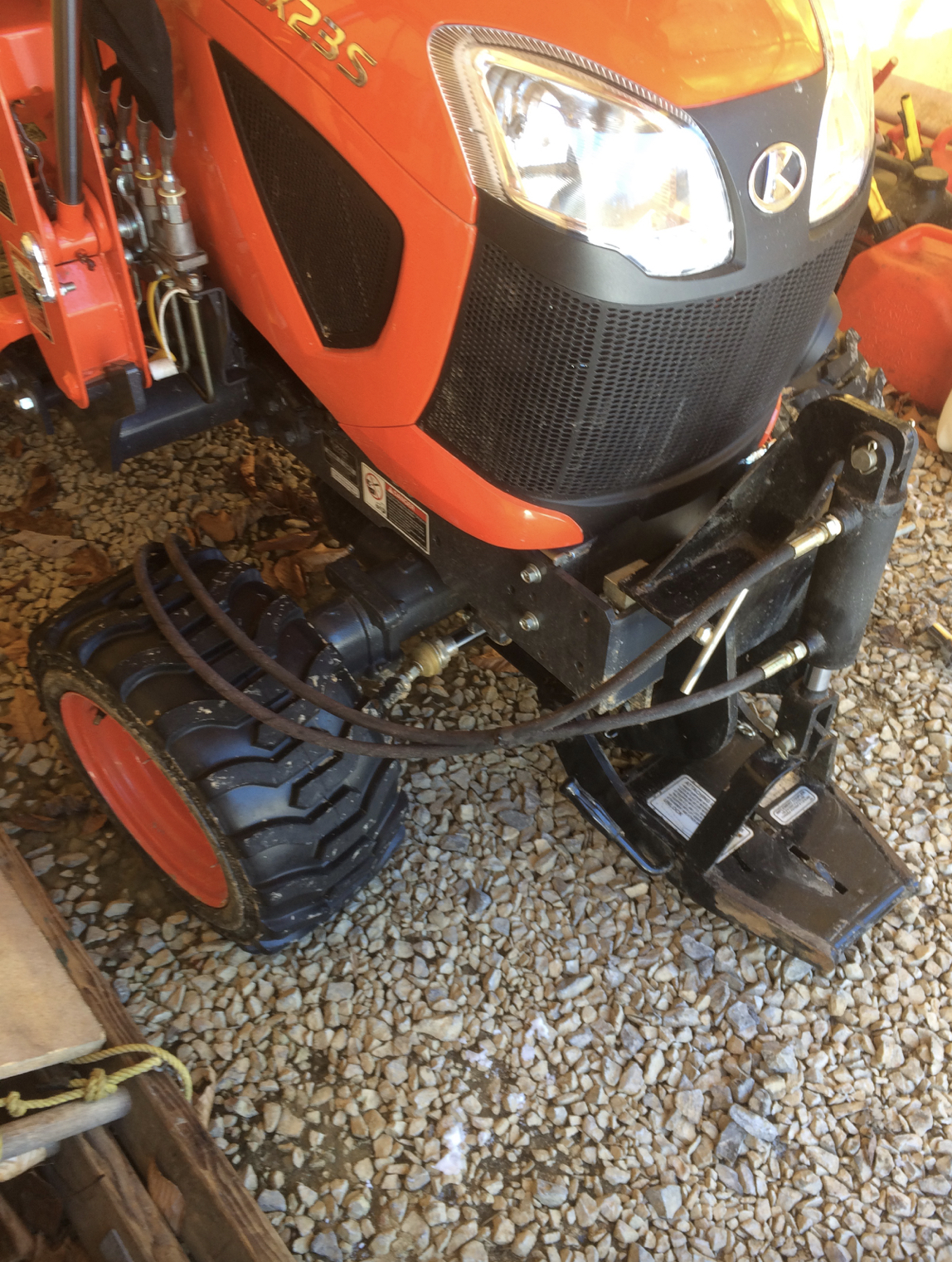

And here’s a pic from a different forum on a 23s. User said it just slipped over the drone and locked on with nothing else required.

What you are looking at is the quick hitch for tractors before the present 80 series tractors, and it will fit the 80 series tractors. You will need to buy the wedges and tee bolts, or you could save a few dollars and buy just regular bolts and weld a piece of solid steel to the bolt head. That is exactly what the manufacturer did. If it were complete $2000 would be a reasonable price. A lot depends on where you are and how hot the market is. Yesterday I posted a complete unit with the newer K connect system in PA that is selling for $1700, and it is a steal at that price. Your Kubota will push snow if you have enough weight on the rear of the tractor. I have a weight box on the rear of mine with 600+ pounds of weight in it. I also plow and snow blow with turf tires and have never had a need for chains.
Thanks. The posts I found on tractor by net included people trading in older models while they owned these QA and plow models, then doing a test on a floor model new 80 series and it working fine.
The original price was $2,000. Dropped down to $1,700 last night. Me thinks I’m sending them a message.

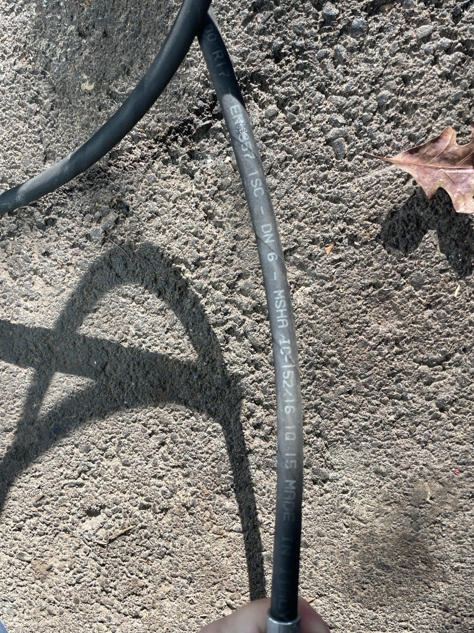

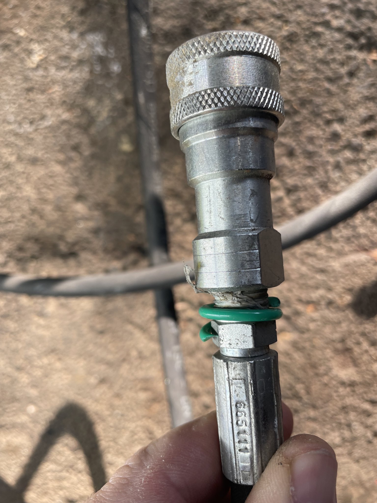

The hoses are standard NPT (national pipe thread) and the best place to buy the couplers is on Amazon. Buy these.. https://www.amazon.com/Thread-Hydra...quick+connect+coupler,tools,83&sr=1-2-catcorr
1/4" NPT Thread 1/4" Body Size Flat Face Hydraulic Quick Disconnect Coupler Coupling Set with Dust Caps $26.50
It is less expensive to buy them in pairs than to buy them individually. If you are going to need new hoses, then buy your hose online for the best price. My local supplier is no longer close to being competitive with hose prices.
11,021
6,077
Real quick followup. Picked up the blade and mount the other day. I have lots of time to get it ready, but about to order parts/pieces. Really just need the wedges/bolts, and the couplers swapped. For the couplers I just need female 1/4” flat face NPT to hook to the FEL block on the bx2380, correct?
Two female 1/4" FF couplers with 1/4 female NPT thread - $40 delivered. It would be helpful if you posted can good picture of the coupler and hose just to be sure that's correct.
icspots
BX2380 LA344 Loader MMM
May 10, 2023
34
20
Mid-Atlantic

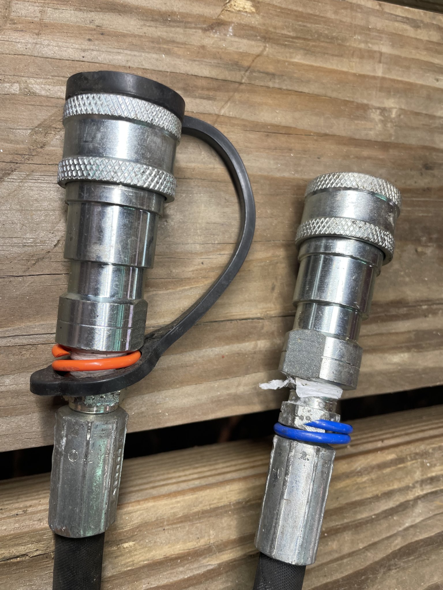

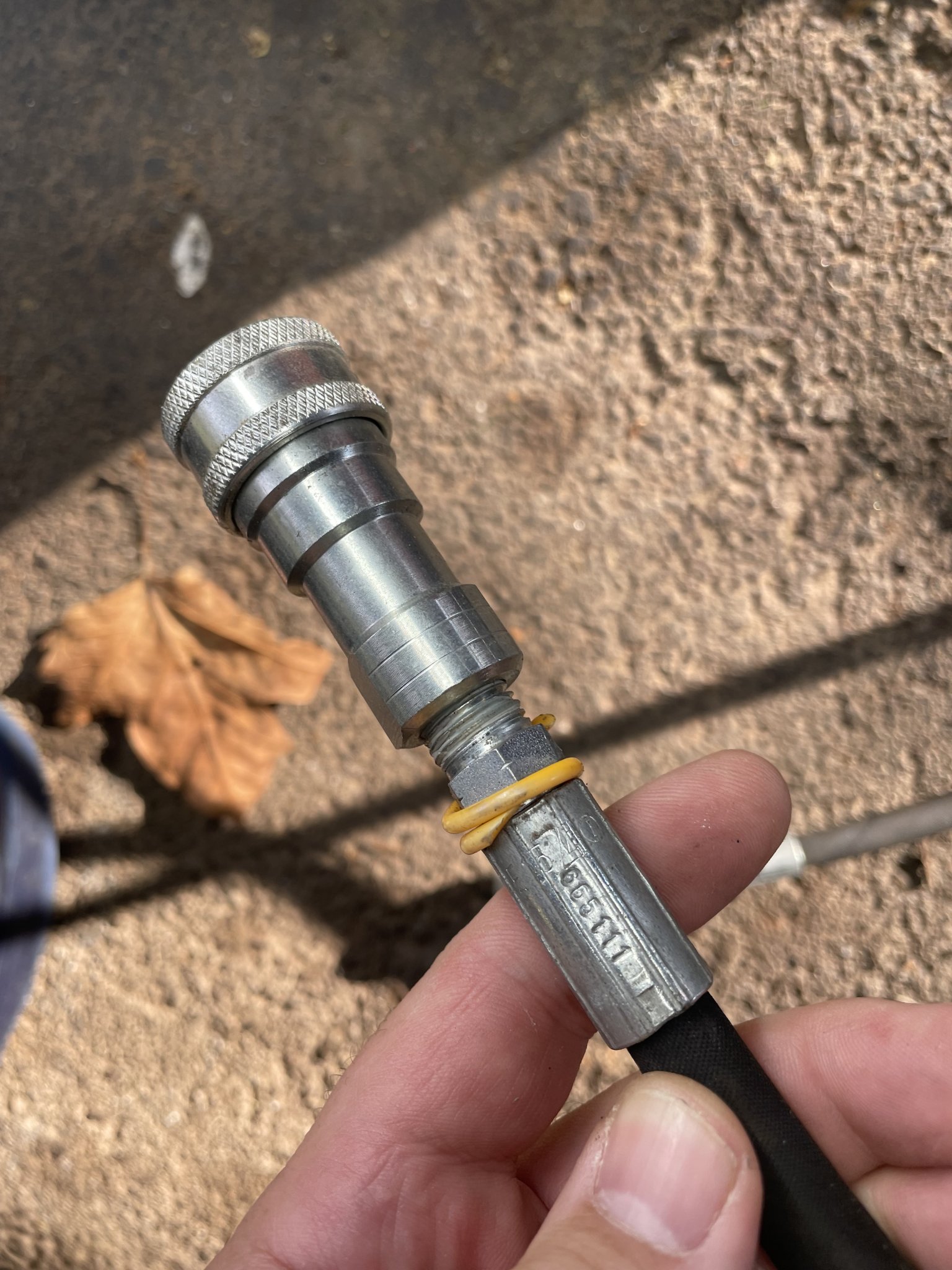

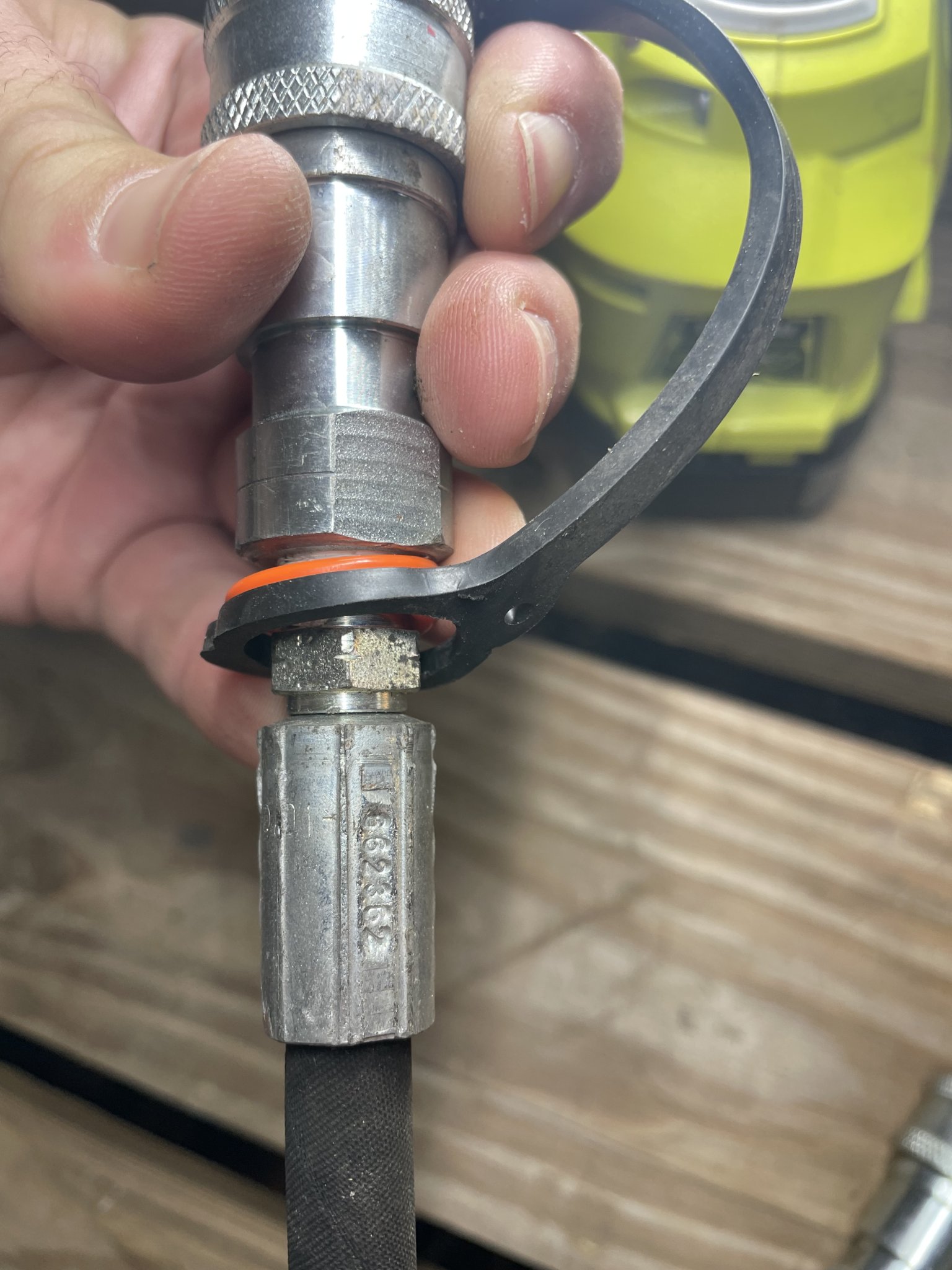

There are zero markings on the current female couplers. Yellow and Green are attached to the lift cylinder, Red and Blue to the angle cylinder. It looks like all the hoses are the same diameter and with the same threads on both ends (bigger on cylinder end), but the angle hoses are longer since they have to reach farther. Lift hoses are marked 665111, angle hoses are marked 662362.
Three out of four of them didn’t have caps and they’re filled with crud. Happily I’m replacing them.

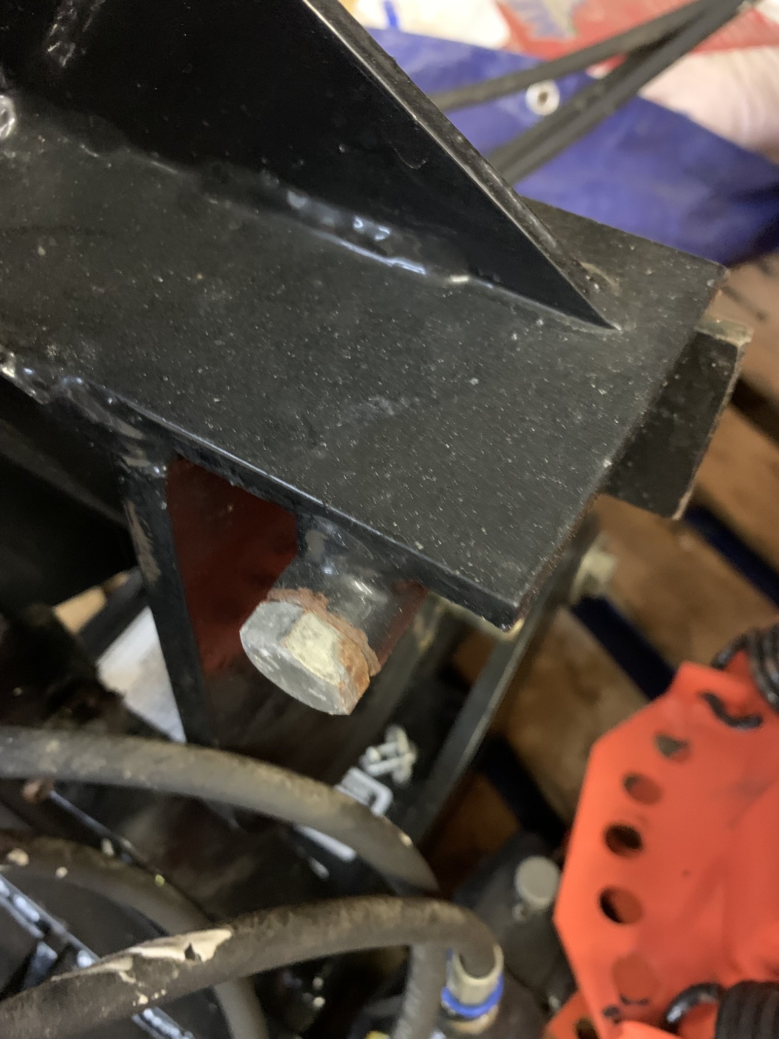

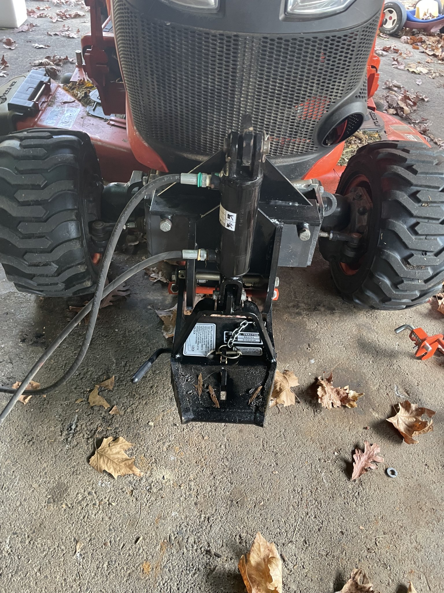

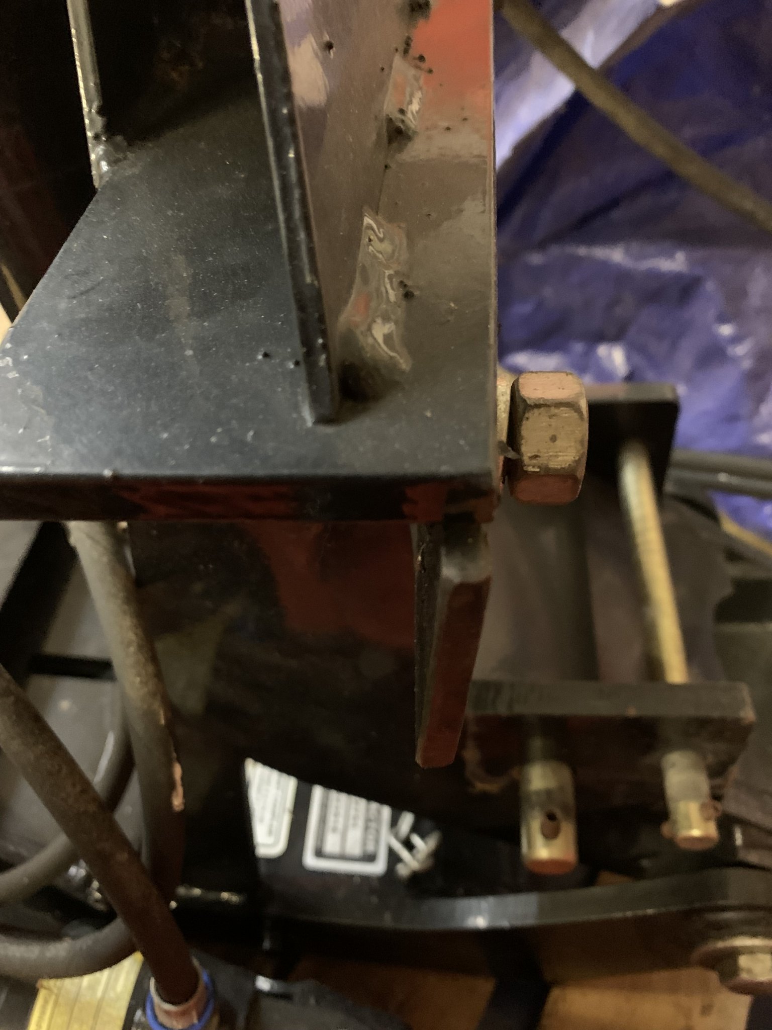

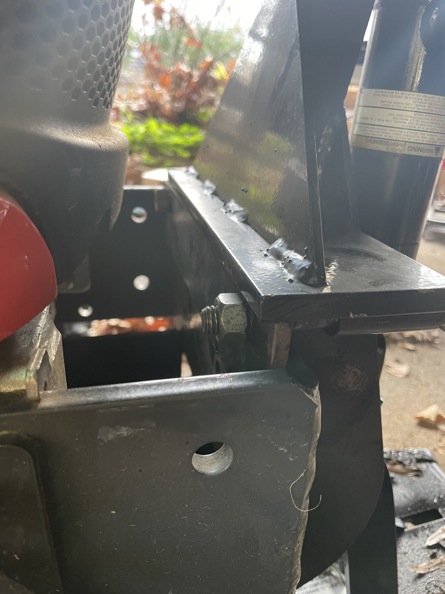

Successful test fit of the older model front quick attach. Had to drop the front of the MMM to give the pin holes space to line up because there was about a 1/8” overlap between them
It’s still lacking the actual kubota T-bolts, and mounting wedges. Previous owner used a 1/4” metal plate secured by regular bolts/nuts. It does hold it in place, but obviously takes a little more work to mount vs. the wedges. I didn’t tighten it all the way up, so it isn’t perfectly flush with the frame of the tractor. I may still go ahead and order the real parts just for ease of mounting, but I’m guessing this is actually good enough unless someone tells me it isn’t. I didn’t throw the lock washers on there during the test fit, but there would be some when mounted For use
