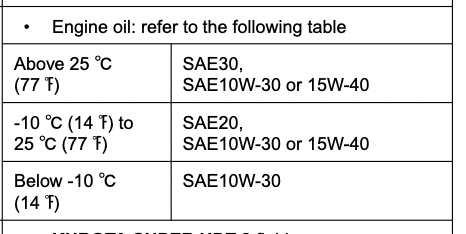

I have struggled to fully understand the Engine Oil classifications table from the L2501 Op Manual.
That being said...now that I actually have the tractor, I will follow the viscosity and classification specifications in the manual as closely as possible based on my expected ambient temperatures here in northern NV...at least through the Warranty period.
With Rotella T6 not available in 10W-30, I will be using Mobil Delvac Extreme 10W-30, which also seems to have the correct API Classifications. Using only Kubota filters never was a concern...

what's in the book
lx3310
I was about to post this information. 10w30 (or 5w30 or 0w30) fits for all temperatures. xxw40 is only specified for above 77 F. Actually, all oils in our water cooled engines "see" 190 F coolant as set by thermostat. They do not "see" the outside temp. Think those upper temps are for air cooled engines.

well, they see the OAT when we start them cold, but I think following what is in the book makes the most sense (for me). It doesnt get that cold in NJ often, but it's not unseen either. It seems weird running 10w-30 in a diesel, but I tend to follow instructions rather than re-invent. The LX engine runs so smooth it seems happy with the 10w-30, no funny noises on start up.
The oil in your water cooled engine "sees" ambient temps as low as -40C(-40F) at cold startup and operating temps around 150C (300F) inside a hot running engine.
Identifying an oil that can perform in a specific ambient range is the whole purpose of the xxWyy grade designations. Any 5Wxx oil will outperform any 10Wxx oil at low startup temperatures.

That cold ambient is all the manual is concerned with. It could have included many other grade combinations but the list would have been even more confusing. Bad enough they included SAE 2O. You will look long and hard to find someone making that.
