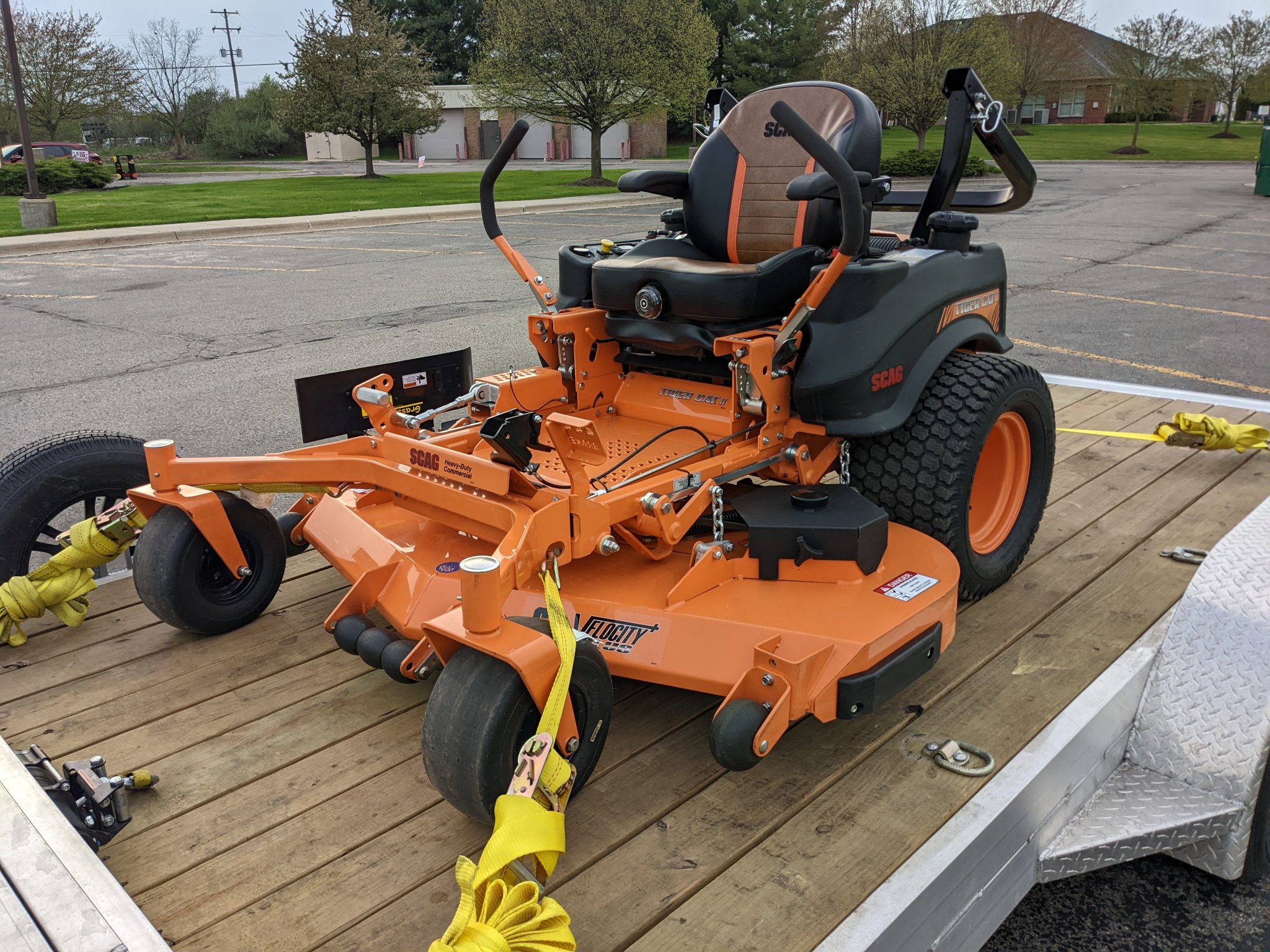

Just a thought for you to consider... If you are using the tractor just for mowing with the 60" MMM. Have you thought about a quality zero turn? I have a 10 acre lot but only mow about 2.5 acres of it. The rest is woods. I used to have a B7510 with a 60" MMM but I do a lot of loader work and the mower deck was just in the way when mowing. I bought a Cub Cadet Zero Turn and cut the mowing time in half. (I have a lot of trees to mow around) I sold the B7510 last year and got a LX2610 but without a mower. and gave the Cub Cadet mower to one of my kids.
I have since gotten a Scag Tiger Cat 2 with a 61" deck & the Kawasaki FT730 motor and it is perhaps overkill for as much as I mow but it is more heavy duty than the Kubota decks that you can get on a tractor. Another mower to look at but it's costs as much as my LX did is the Scag Turf Tiger 2 with either the Kawasaki FD water cooled gas motor or for a bit more the Kubota diesel motor. The advantage with the Turf Tiger is the mower deck is shaft not belt driven. Both mowers have cast iron spindles that are greaseable and the top of the mower deck is laminated with 3 layers and is 1/2" thick.
Now if your using the tractor for things other than mowing that may override the advantage a zero turn offers. As the zero turn pretty much can only mow but they do that better than anything else.
+++++ For the SCAG family of zero turns.
I have three tractors, none of which has a mower (I do have a PTO brush hog).
MY SCAG is a delight to mow with!
