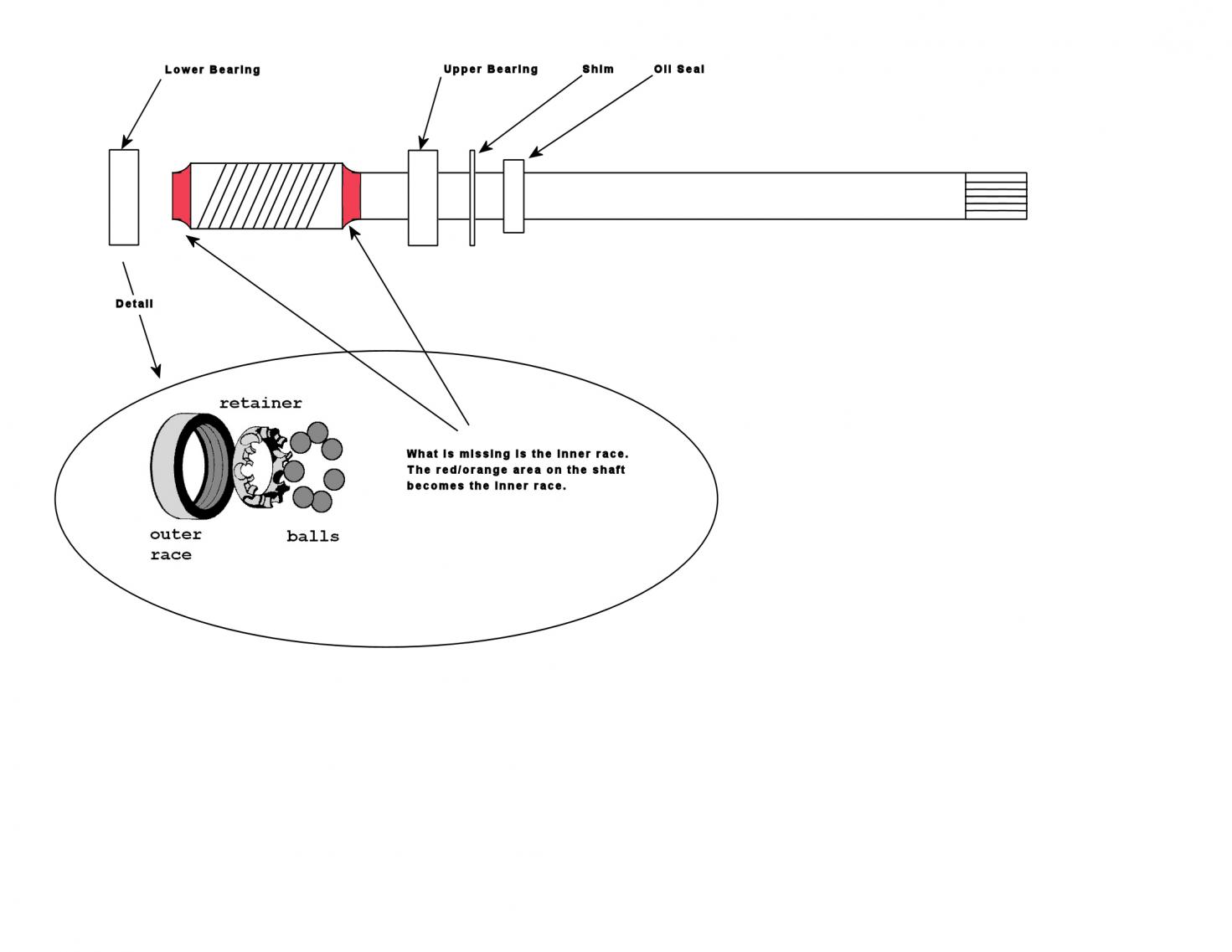

I have included a drawing that sort of details what is going on as concerns the shaft and the bearings.
What I hope you get from this is that the lower outer race and the upper outer race are pressed into the lower case and the upper steering tube.

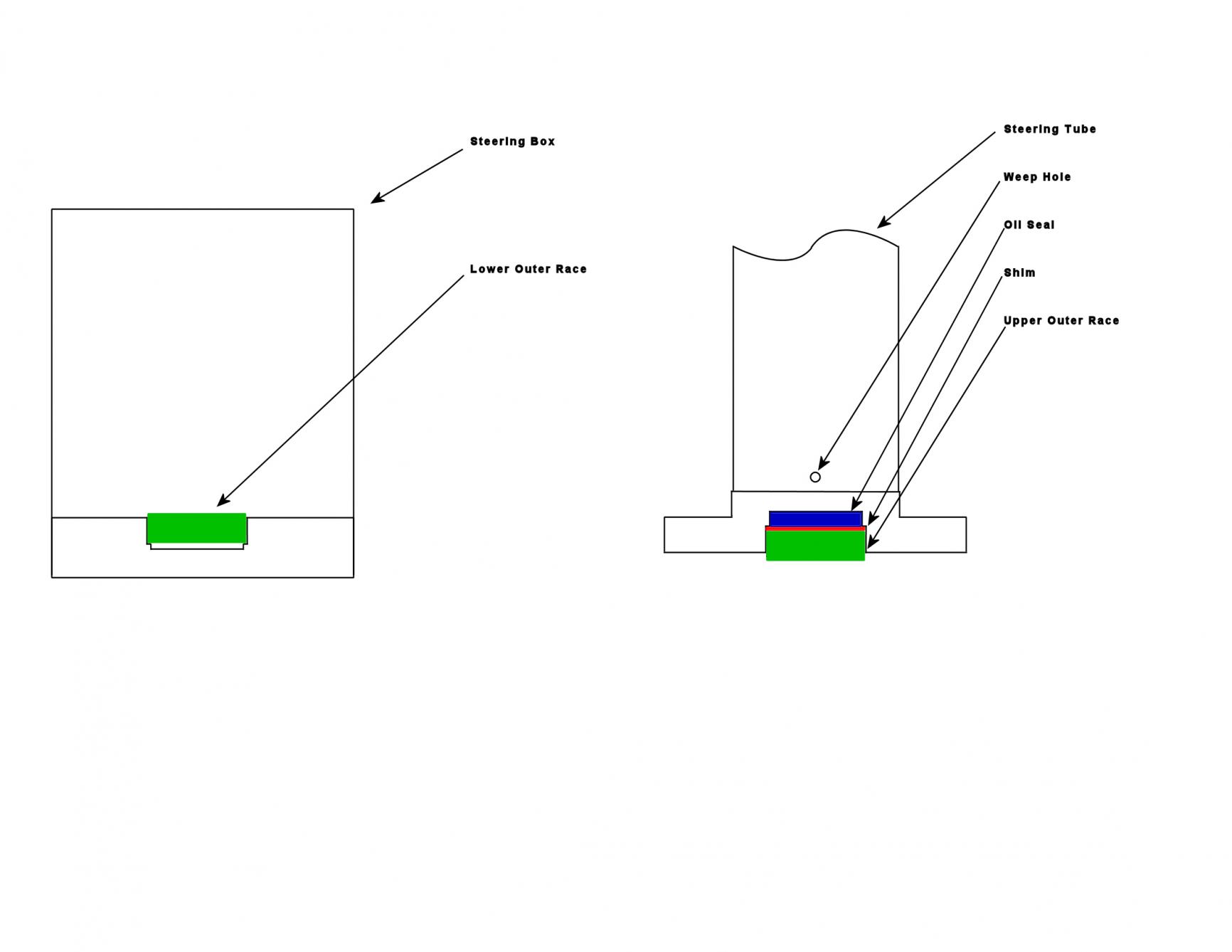

The second drawing shows in general what I think is going on with your steering tube. I am thinking you need to get the old outer race, shim(s), and oil seal out of the steering tube before you can put the new ones back in.
I am kind of guessing on the shims(s), because mine are done differently.

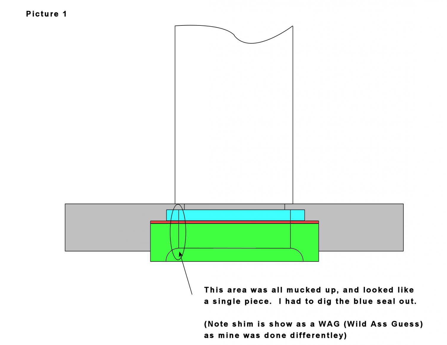

Here is a little more detail.
In Picture 1 I show that the oil seal and outer race were all mucked up, and I was convinced it was one piece.

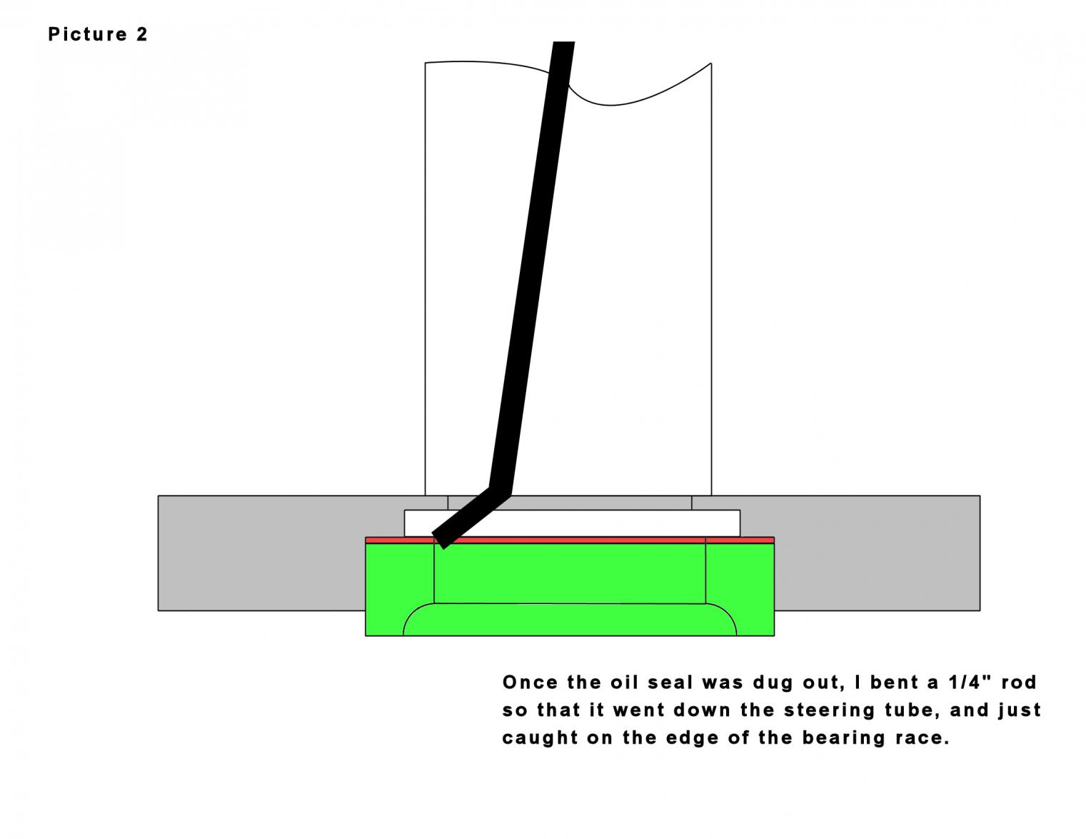

Once the seal was out, see picture 2, I bent a rod to the right angle, and was able to tap on the rod to get the bearing race out.
As I recall, the bearing resisted my every effort, and then once the seal was dug out, and the rod placed against it, it popped out with no effort with a single tap of the hammer.
Please Note!!!! Mine is a B6200. For all I know the B6000 were different. However, I have looked at the kits, and I am pretty convinced the upper race comes out like all other versions.
