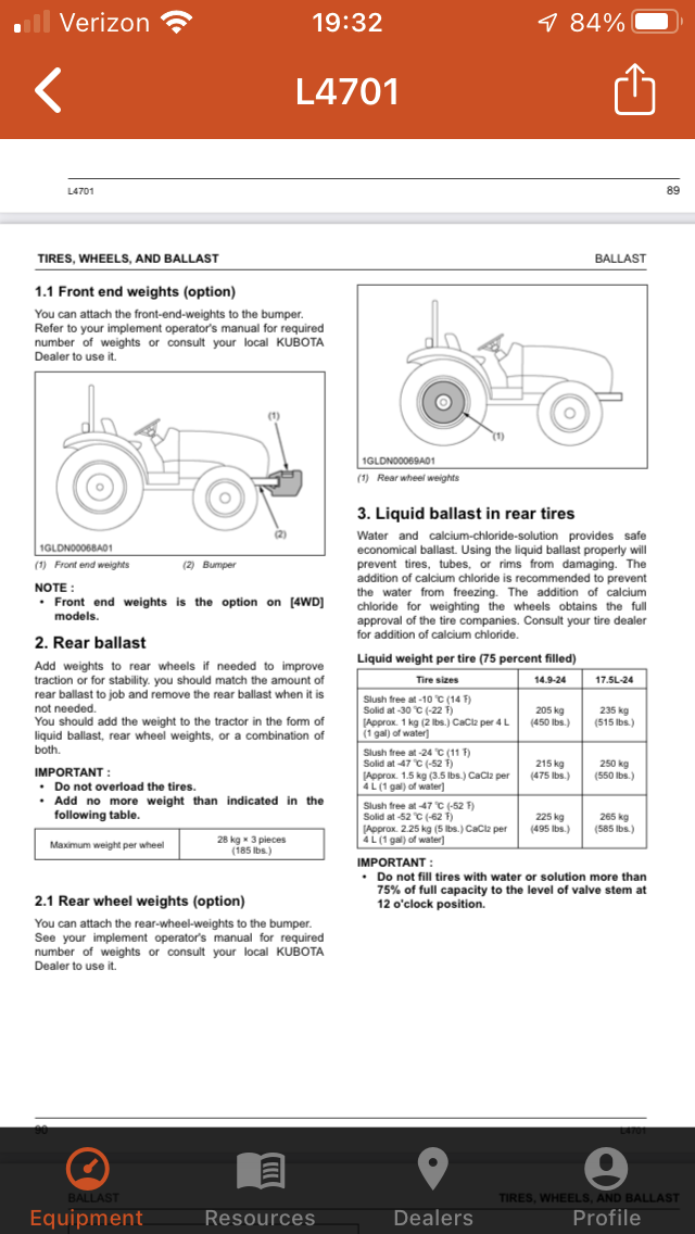

This is the page out of the Operator Manual that addresses iron weights and liquid ballast for the L4701. I don’t know the impetus for the limitation.
Edit: And yes, I’m aware there’s a typo that instructs to add rear wheel weights to some mystery bumper somewhere immediately prior to the illustration showing wheel weights added to the wheel where they’re always added.
Apparently they do stack. 3 each per wheel = 185lb per wheel per the OM.

The L4901 manual page is pretty clear - Kubota is fine with 185 lbs (3 x 62# weights) of iron weight and 580 pounds of liquid ballast per wheel.
The L3901 manual is identical except that the tires are smaller and you max out on volume well before 580# of liquid.
Puzzled by 185 Lb./wheel weight restriction in section 2 and suspect yet another mistake in manual like the obvious one in section 2.1. I have found numerous mistakes in operator's manuals.
I have the maximum recommended number of 3, 106 Lb (IIRC) weights on each wheel of my L6060. So far as I know, the L4701 uses the same rear weights as does the 6060. No, I did not verify.
Yes, Kubota allows more liquid ballast than cast ballast but I expect that the lower cast ballast limitation has more to do with attachment limitations and overall width than total weight.

I think the limit was based on the weight of the available cast weights for sale. Some can be stacked, but the difference between cast weights and liquid ballast is why I went with the liquid.
