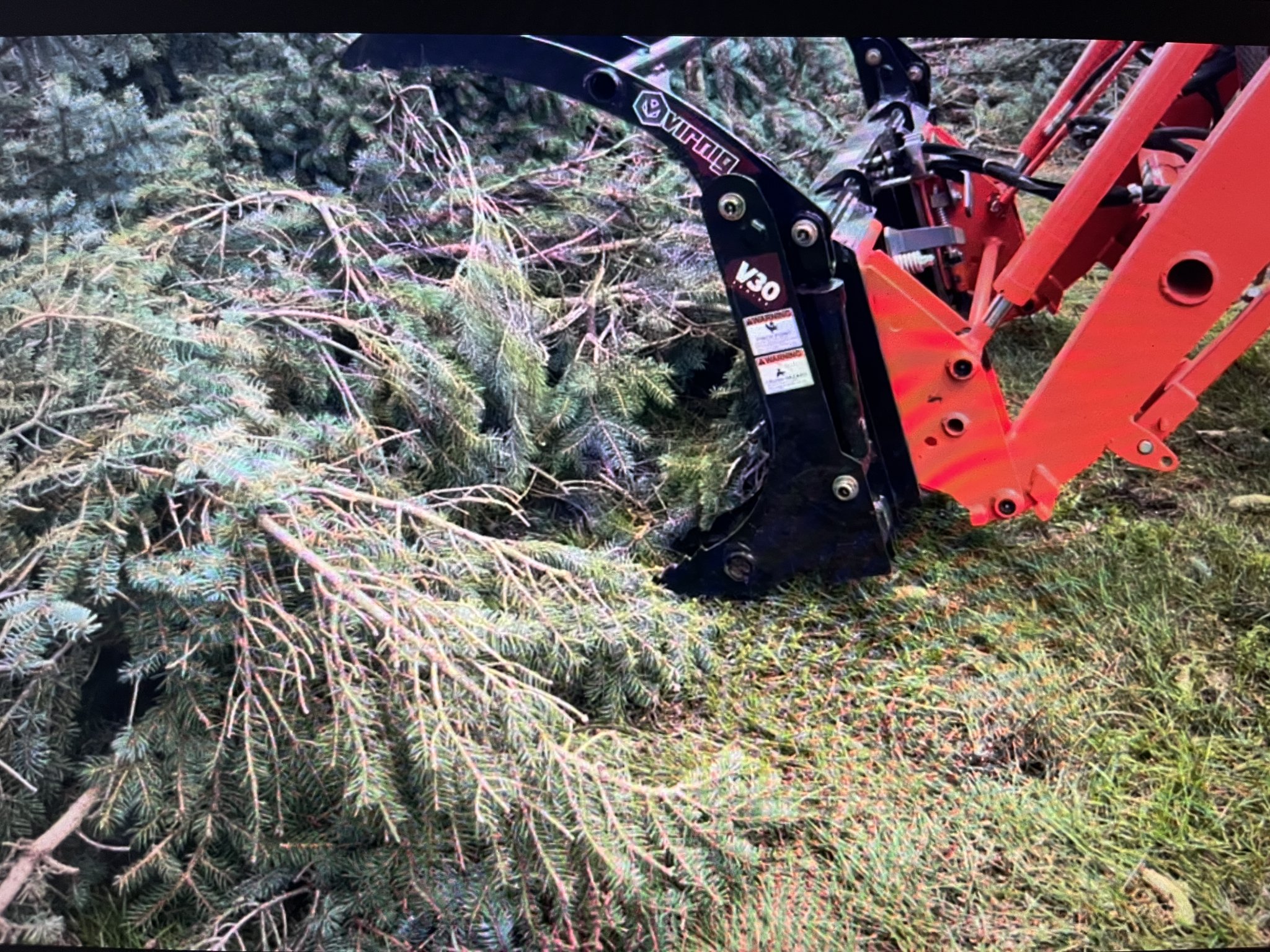

i know my ride isn’t orange. My concern is the grapple. Anyone know anything about Carolina Attachments? Similar heavy but light weight design to EA Wicked
