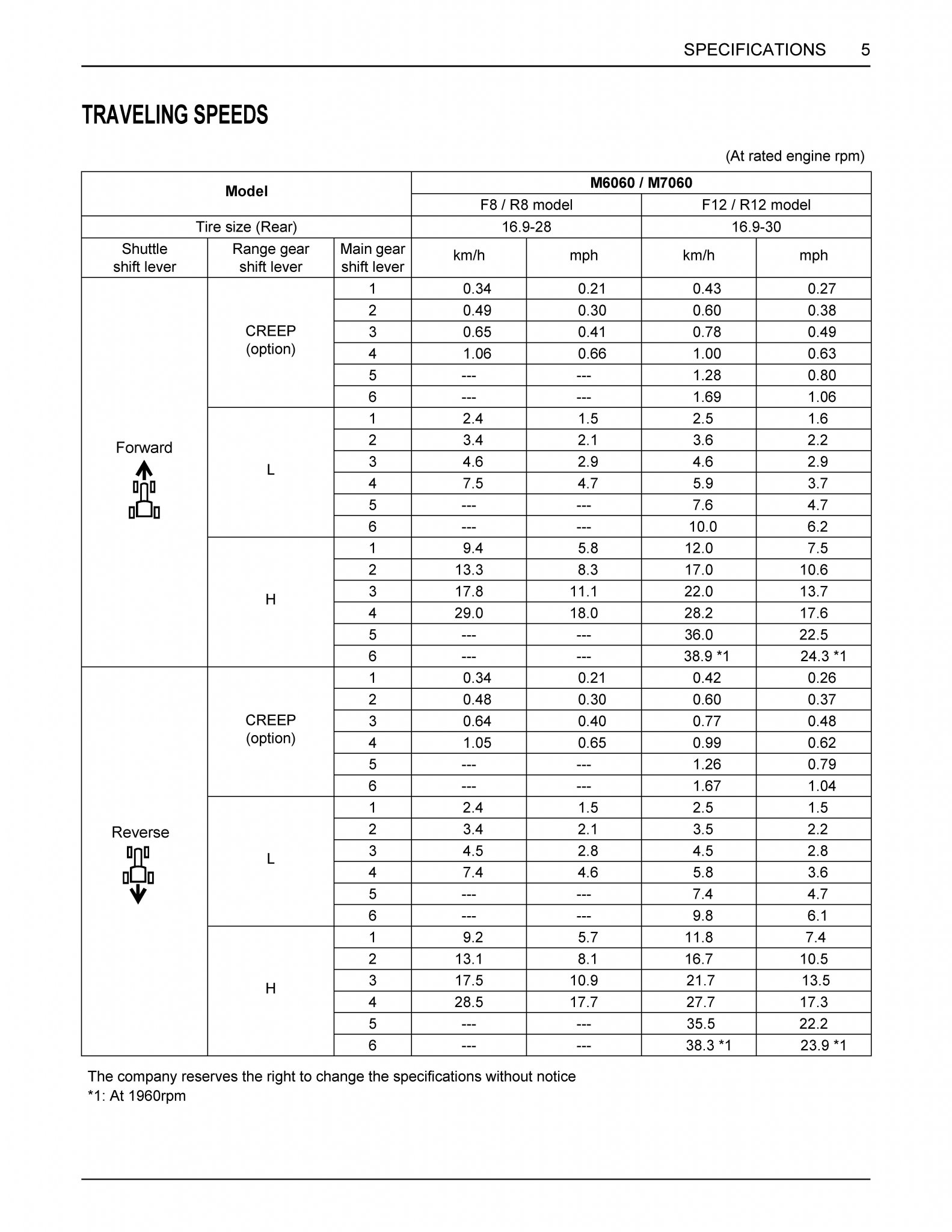

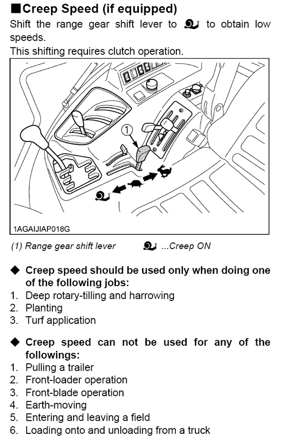

I'm dropping the M6060 off at the dealer this Friday to have some upgrades added including Creep Speed. The M6060 manual provides the information shown below. I have a fairly good idea as to what deep rotary tilling, harrowing and planting are but what does the vague term "turf application" refer to?
It's a bit disappointing that Creep Speed can't be used to load the tractor onto a trailer. It wasn't much fun backing onto the trailer in Sheridan last week in L1. Would have been nice to be able to be in C1 but I guess that's a no no.
Thanks.
