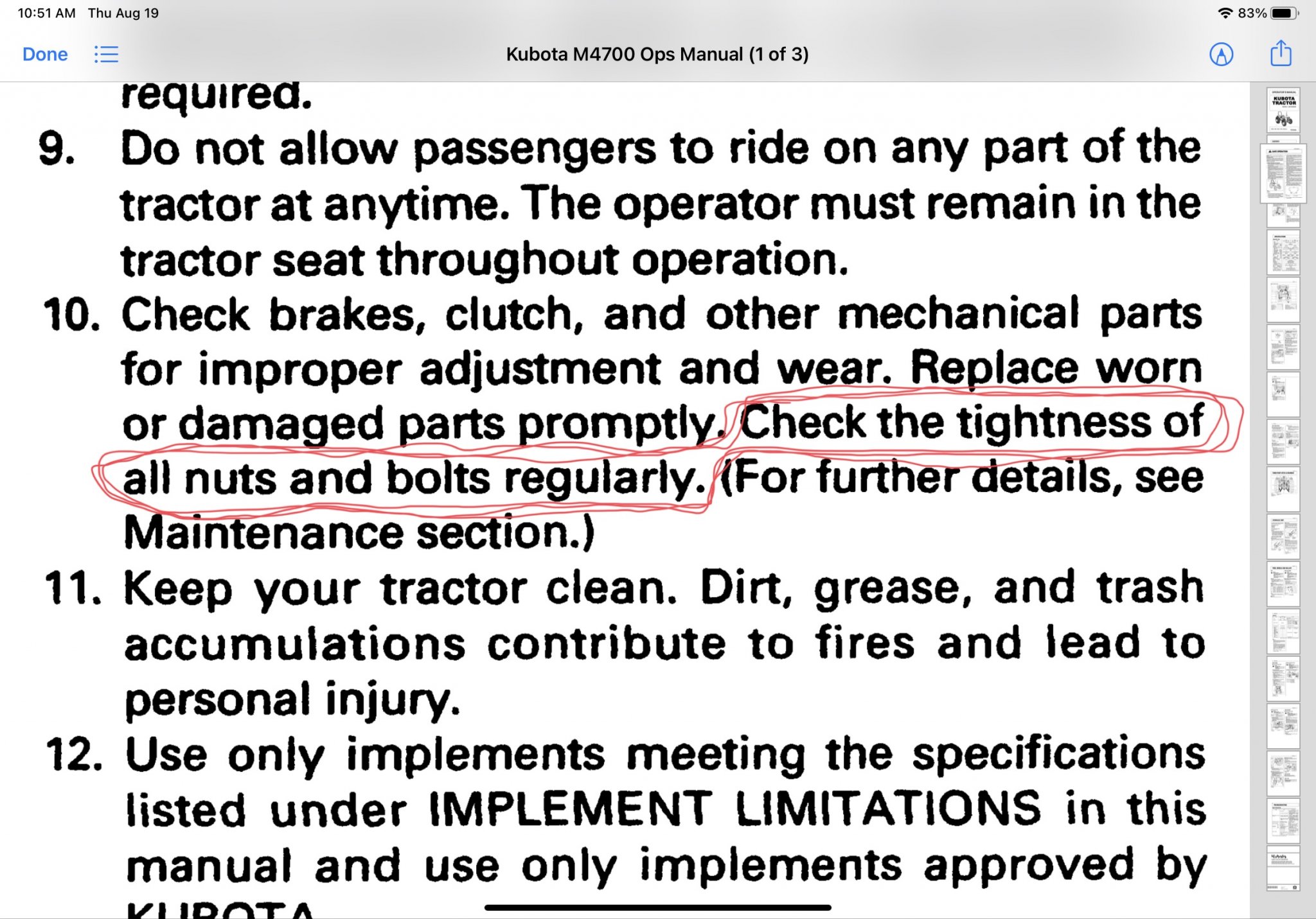

Engineers can only design things according to the specifications. If the problem isn’t identified, reported, then added to specifications…. (but I get-i…. this seems sorta obvious)…. AND the engineer probably did identify what should be obvious to an operator…so he issued INSTRUCTIONS to be included in the Operator’s Manual …such as Item 10: (but of-course one has to READ and USE the manual for it to be effective): LOL
The intent and design of the fasteners was obvious from day 1. I am also confident they ALL had nylock nuts on them and did not vibrate loose. I have no quarrel with the basic design but I do have an issue with those on the bottom pins. The bolts were sheared off by ground contact while I was moving and grading fill. Plenty of scrape marks on the paint where they exit the pins to help confirm that. Since I do a lot of that sort of thing I have every expectation it will be a chronic issue if I continue to use the long bolts. So i will take it upon myself to re-engineer the bottom pins on my loader and eliminate those bolts. I dont expect that to be much of a strain.
