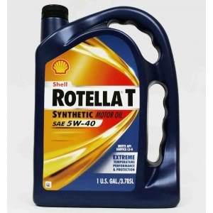

I use Rotella T6 5W-40 Fully Synthetic Oil in my B7100 & the GoldWing GL1500

I use Rotella T6 15W-40 Fully Synthetic Oil in my B7100.

Lil Foot, does your oil come on a white bottle or a blue bottle ?
Seems like it used to be in a white bottle, but now I'm pretty sure it comes in blue….. I'd check, but it's 150 miles from here….

I use the Chevron Delo 15w 40, this is a full synthetic blend. I run this in my tractor as well as my F-250. I'm well pleased with the quality and several manufacturer's contract to them for their name brand oils. It comes in a blue bottle also!
The reason I was asking is I have have several friend's who use the white bottle and thought they had the Synthetic oil.
If it's the blue bottle it is the Shell Rotella T6 5W-40 Fully Synthetic
If it is the white bottle it's Shell Rotella T 15W-40 Triple Protection
(the 15W-40 is not a Synthetic oil, the T6 5W-40 is Synthetic)
There is also a gray/silver bottle that is Shell Rotella T5 which is a Synthetic Blend. It is available in 10W-30 and 10W-40
Leave it to Shell marketing to make it easy to mix up the similar blends. I use and have used the blue bottle for several years. Great stuff.
Hoping to save someone the aggravation of grabbing the wrong bottle of oil. :D

Thanks for the heads up, I'll have to verify.
