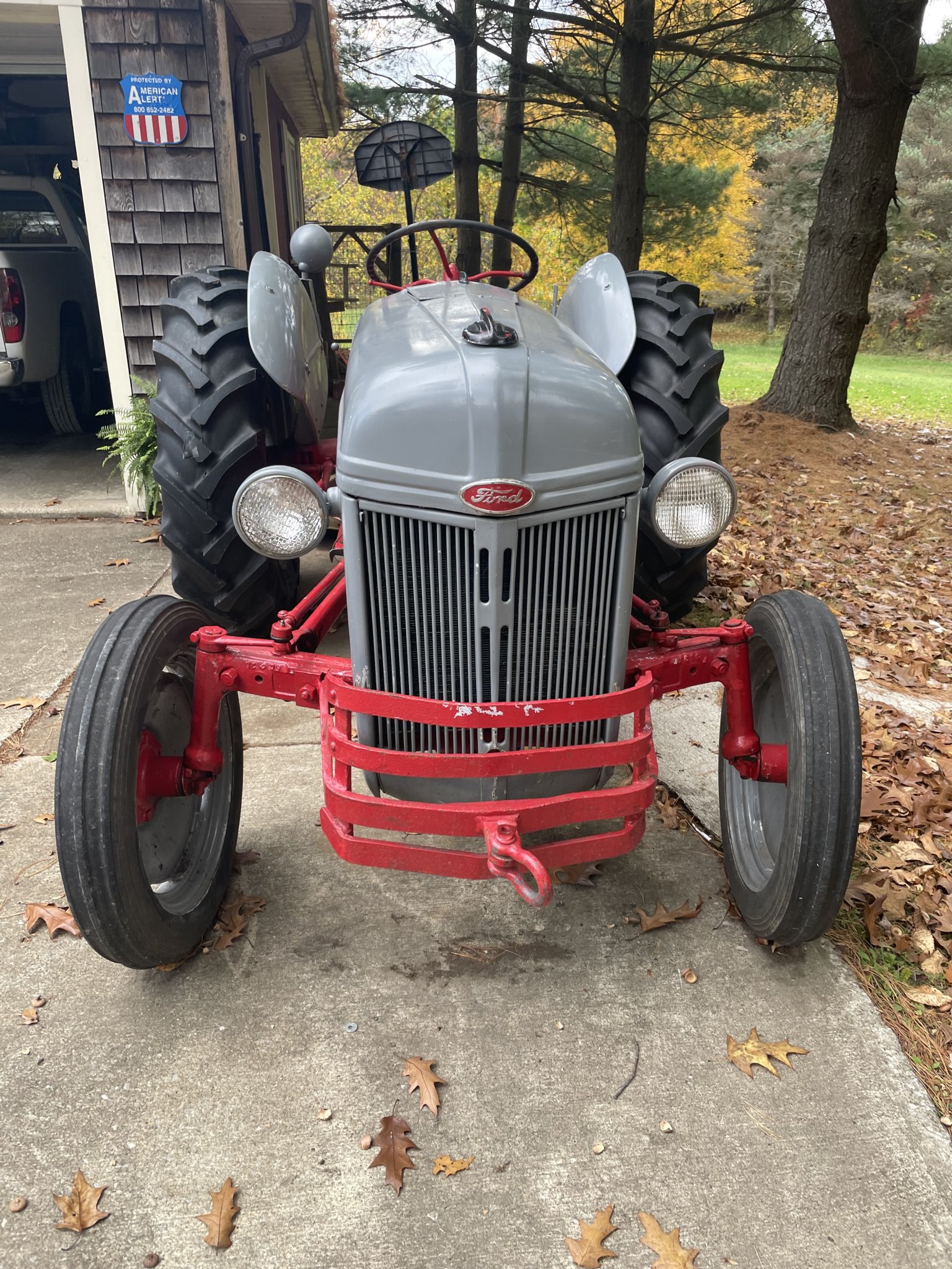

What to make out of the corrosion showing at around valve stem?

Good day….i am not sure the history of the machine (I don’t believe they are currently loaded) but i am looking for some advice on some visible corrosion around valve stem (bth L and R side look similar)…suppose that is from water collecting on the outside in the little sink / notched area of the rim and just some scale on surface? Or suppose something a bit worse coming through from the inside? Thoughts? Thanks in advance for suggestions. ☕

I will betcha that if you take a sample of the liquid from those tires and give it a little taste test it will be NaCl - good old Sodium Chloride - salt water.
Salt was use extensively in the era of old tractors, and for that matter it still is.
Cheap - heavy and easy to place and replace and does not freeze!
But given enough time it will rust a metal rim out completely - it typically starts at the valve stem.
Most that have NaCl have tubes in the tires.
Very nice looking N series tractor btw. I had a 53 jubilee that had NaCl in the rims, it too showed the ill effects of time.

Classic corrosion due to 'loaded' tires(salt water). it only gets worse, never better over time. I lost 6 rims due to it.
Whoever 'restored' the 8N didn't do it properly( check valve stem on front rim....),Also paint's flaking off the rear.
Honestly what NEEDS to done is
Remove both rear tire/rims
Remove tires and tubes from rims
Sandblast rims INSIDE and out,rinse really,really well
Epoxy primer INSIDE of rims
Paint INSIDE of rims
Buy new tubes (save old IF newish, maybe.
Wash INSIDE of tires (several times until it passes the 'lick test'
I've had lot worse rims,PITA to cut and patch and weld..makes for a very long day.
Yours aren't nearly as bad, might need patch around the valve hole,maybe.
if you do it right, your grankids will be happy you did when they use it 3 decades from now.

I think the guys have good predictions. Common spot for the corrosion to show.
My old ‘Moline wheels look similar, and I know they are loaded with calcium or sodium chloride.

Thanks. Ya’ll sort of confirming my concerns.
Here’s a little more to the story (it’s a bit of an odd situation). We bought the property (finally signed papers yesterday…been a slow process this summer and fall) across the road from our 2nd place up north. Anyway the seller would like the machine to stay there and asked me what I would give for it (we have a good relationship and it has been a very agreeable private transfer) and I don’t want to be disrespectful in any way. In my mind I need a 3rd tractor right now like I needed the additional mortgage I just took on…but I do believe it’s a good idea to have a pair and a spare😉. (The extra mortgage makes money a bit tighter). The machine runs and it comes with a fairly decent land pride brush hog…I don’t really want to pay much and I guess I am a little nervous about offering much when to me it looks like may need a little $TLC…but I also think worse case it’s some nice yard art that can be decorated at Christmas. Although I’d more likely keep using with the brush hog and maybe pulling a wagon…I think it has lots of use/life left in it. I am sort of worried if I offer 1500 (reasonable?) do I end up getting involved with something I am going to need to cough up a couple thousand more? What’s a fair price? I see prices all over the place…my thoughts are offer at low end understanding it needs some TLC or worst case new rims.
CaCl solution was just about universal in rear tractor tires until the advent of beet juice for ballast.
It's heavier than water or water/alcohol, does not freeze and cheap.
It is, however, very corrosive and will cause rim rust, very quickly if any leakage.
If yours has or has had CaCl solution (almost all do or did), it is very likely that there is contamination inside the tires as it is time consuming to properly clean such from rims and tires and few if any tire shops did so.

That wheel has a lot of live left in it. It may not be perfect but it takes a long time to rust through and need replacement steel welded in. Here's a picture of a wheel on a '66 Case 730 that I know has not had CaCl in the tires for 25 years. Notice the rust at the valve stem hole and it migrated through the wheel but it still worked fine. I rebuilt the wheel because I wanted to, not because I had to.
This tractor has power adjust wheels (clamps on the square bars that allow the wheel to be rotated in and out) that made the replacements hard to find and expensive when I did.

Like the others said, there’s lots of life left in those wheels. I’m honestly not that worried about the Moline.
Tractor tires are low pressure.
If rims are badly corroded, I would consider sandblasting to bare metal, and then lining inside of rim with resin soaked mat fibreglass.
Then use a tube for sure.
I had planned to do this for my 8N, but decided on new rims instead.
Gave my old rims to a friend in Canada ..... for him to fix/use.
