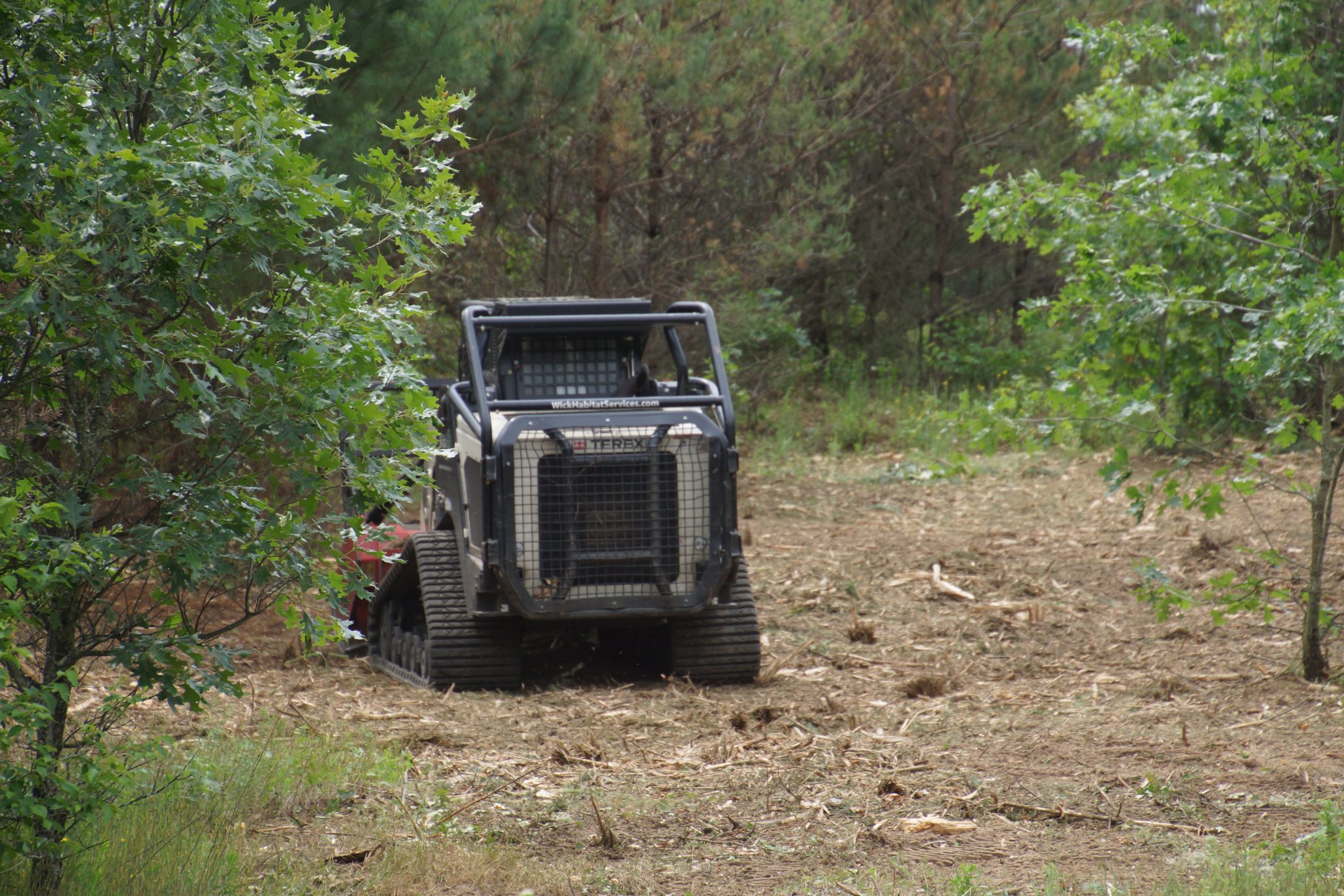

Depending on your tree removal plans and future maintenance of those areas I would consider a tracked skid steer with enough HP and flow to run a forestry head.
The head might not be in your budget initially but there are some major pro's and some con's to mulching up those 5 to 12 inch pines on site. Less soil disturbance, the roots and below ground level trunk are left in place which would serve to keep erosion to a minimum on your hill side.
In 2018 I had a contractor forestry mulch 28 acres of very dense scot pines in the size range of yours. If we had bulldozed and burned I think we would still be at it! JK, but we did a whole lot less ground disturbance. The mulch broke down in a year or two and replaced with a varied mix of native species forbs and grasses.
