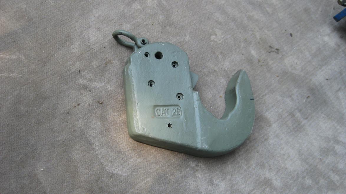

Be absolutely sure to let me know if you go with Pats QH. I will need to build the top link longer. Plus I have other alternatives to Pat's as well as to complement. :cool:

OK. Instead of using the tractor for a while then deciding, I'll go ahead and research and ask for advise on PATS and other options and let you know. I'll probably resurrect another thread or start a new one if needed. I would really like the extendable lower arms like on the Grand L and some of the B series tractors but there is not a kit and it would probably be rather expensive to piece together new. For now I'll be switching back and forth between the rotary cutter and the box blade. I see lots of advocates of PATS. At first I wasn't so excited about cutting off the eyelets and welding on PATS then I saw that there is a bolt on version, and that it does lengthen the arms. Brian can compensate for that so I need to see if there are other drawbacks. I think I would rather use a PATS type system than an attachable QA that might or might not work with any implement I can buy or borrow. I read that some of those have interference issues with the top link.

Be absolutely sure to let me know if you go with Pats QH. I will need to build the top link longer. This => Plus I have other alternatives to Pat's as well as to complement. I missed on the first read. Contacted for alternatives! :cool:
The PATS looks very popular but other options might be better.
