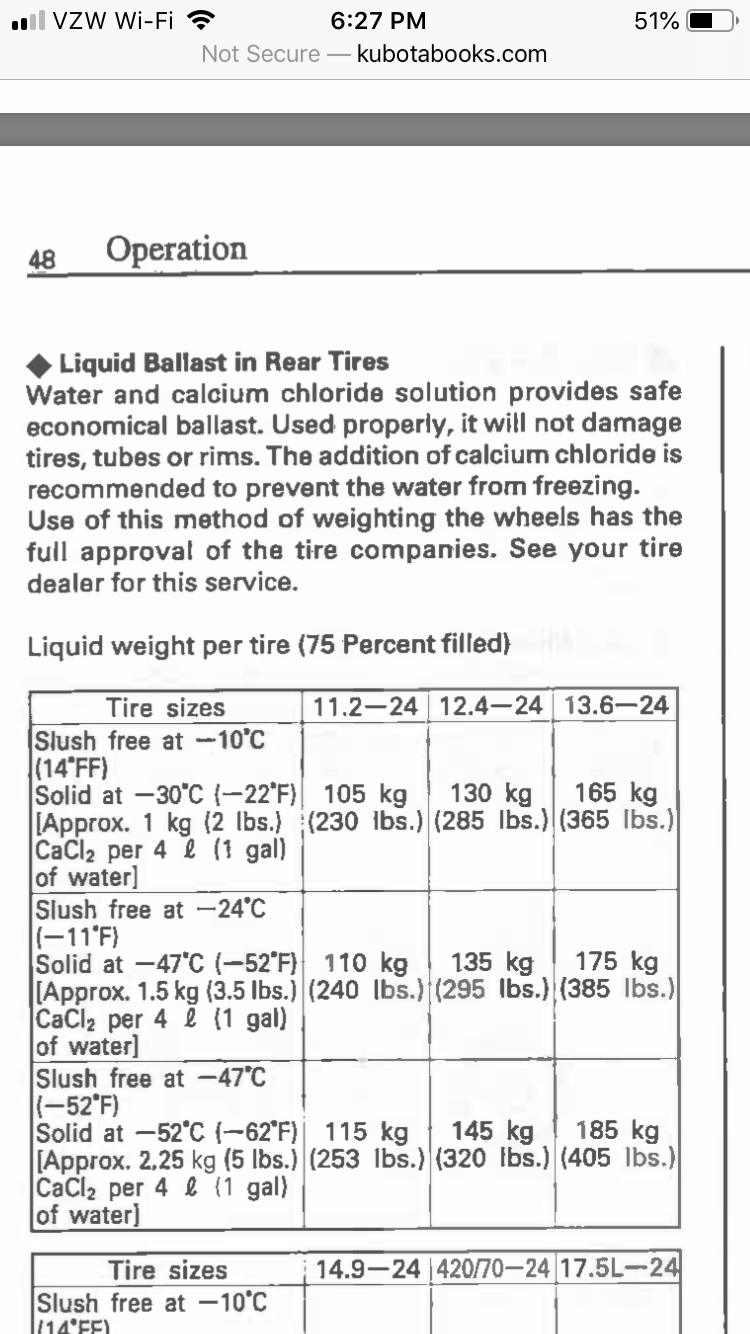

I am not sure what your question is. Nacl that they spread on the roads around here does add to the corrosive properties of water on iron. As does cacl. There is not any disputing that. Some of the spreaders have gone to plastic around here. I personally put cacl in an inner tube in my tire. It has had that for about 25 years (it was done long before I had it). There was some surface rust inside the rim and rot around the valve stem. I don’t think they were caused by the cacl. The pattern of surface rust was where the inner tube would probably trap moisture from outside. If had cacl inside the tire without and inner tube the oxidation proses does require oxygen. Once it is used up it should almost stop. I have not tried this myself.Why all our county spreader trucks have stainless boxes....

If you fill the tires your self I would use nothing but beet juice it has the most weight and is none corrosive . What ever you do don't use chloride it will eat up you valve stem and create a leak and before you know it you have a rusted rim or maybe a rim that is beyond repair. Bean there. Washer fluid will work make sure its rated for 30 belowI've also seen windshield washer fluid suggested. I do appreciate you sharing your story. It is definitely food for thought.

My initial plan was the beat juice unfortunately I could not find someone near me that would sell it to me in a container. They would only fill the tire which I was worried would be a little unruly for me to handle once filled. According to the previous owner the tractor had had cacl in it for 25 years but I am sure that had gotten a couple flat tires so I can’t say how old the inner tubes are. The tube manufacturer claims they are fine for filling with cacl but you maybe right. That maybe what goes first. I will definitely look at the windshield washer fluid next time.If you fill the tires your self I would use nothing but beet juice it has the most weight and is none corrosive . What ever you do don't use chloride it will eat up you valve stem and create a leak and before you know it you have a rusted rim or maybe a rim that is beyond repair. Bean there. Washer fluid will work make sure its rated for 30 below
