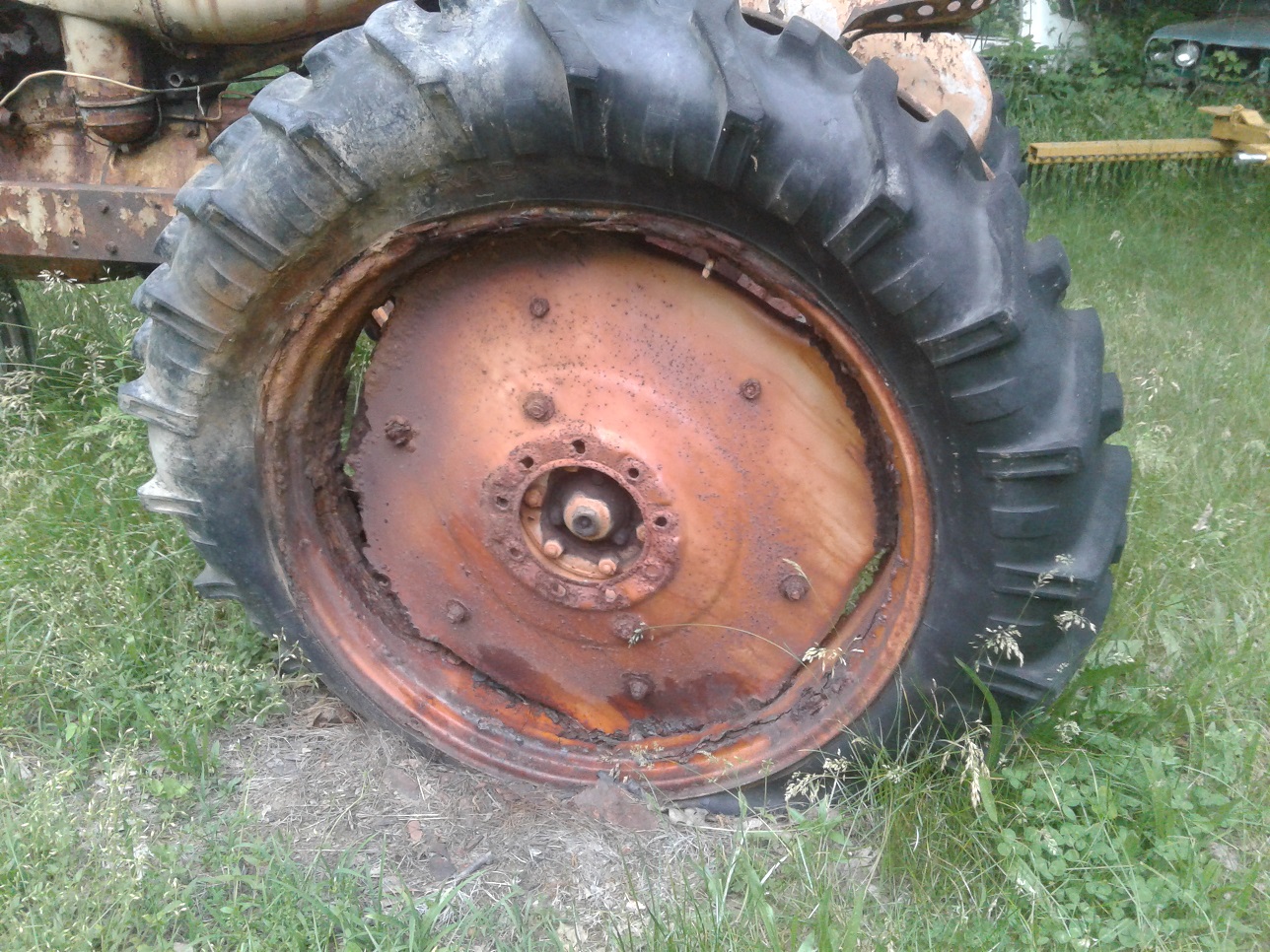

9,892
4,053
If and that's a big IF, you could get all the cacl into the tube and never, ever have 1 drop touch the rim, then maybe, just maybe the rim would survive BUT and that's the big BUT.. there's zero chance of NOT getting a drop of cacl onto the rim. Once one drop of salt water touch the rim the rot begins...
The other problem is ,'hmm.... tire needs a bit of air' ,so you grab air hose and chuck, tire's NOT at 12 oclock and pfffts..air goes in, some saltwater sprays out. The timebomb starts ticking.. the rim WILL rot, you can't stop that....
Worse is getting a flat, say a thorn or nail. Grea, NOW the saltwater's inside, sloshing between the tire and tube so the rot happens faster.
I've yet to personally see any older rim not have cacl damage to it. If I need counter balance weight, I use the 'carryall' with a box full of concrete/steel.

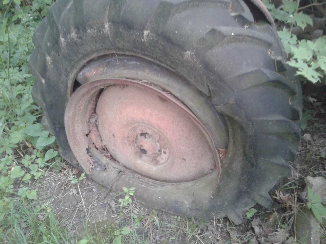

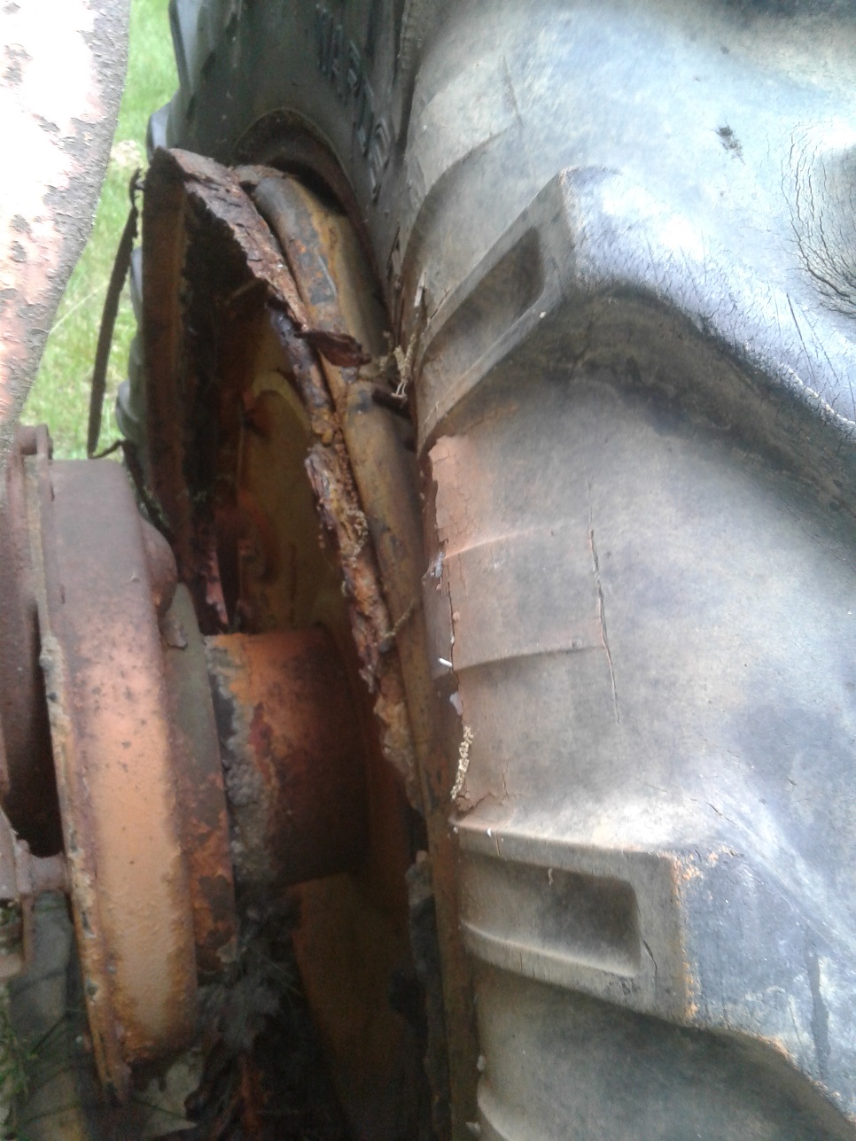

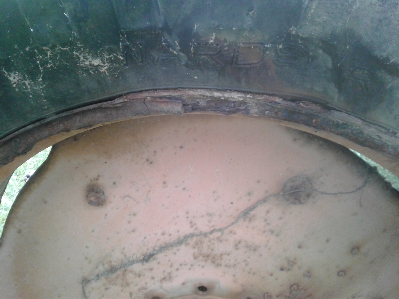

I do appreciate that rims rust but some of you pictures have rot everywhere not just where cacl would be.
Tractors have sat outside 60+ years seldom moved. Pinhole leaks and wicking action of filled tires must have caused damage. Front tires, frames, fenders don't have this level of damage. Looking forward to the day they can be hauled to scrapyard - tired of mowing around these lawn ornaments.
