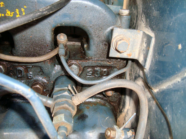

I can see some numbers on the engine block as you can see on one of the pictures below. It is D75 and 930.
The cooling is by pump and not natural circulation.
Anyone got a a clue what engine it is? Can I do more to identify it?

Looks like it could be a D650, D750, D850, D950
Under the intake manifold behind the injection pump and Hydraulic pump on the side of the block is the cast in number, give me that and I'm pretty sure I can tell you the size. ;)

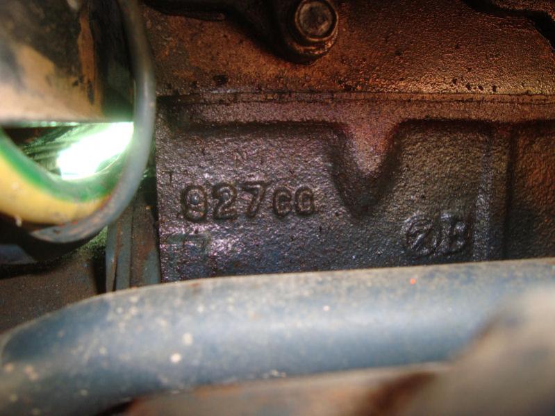

I was looking through my tractor pictures and I found one of the engines right side behind the fuel filter. There is a cast in number on the engine block and it looks like 927cc. Is that the number you ask for?
Anders
28,708
5,124
Yep that is exactly the #'s needed.
Well someone did it right, that is a D950, largest 3 cylinder of it's series!
Around 20 HP, easy to get parts for.
