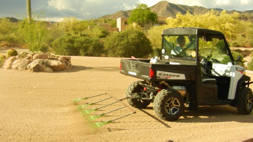

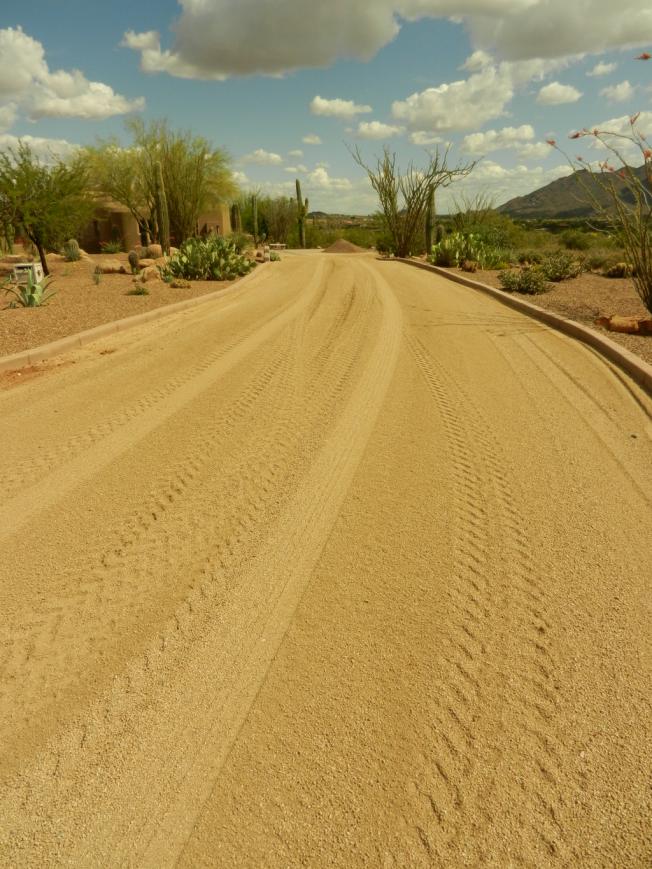

I had 60 more tons of material delivered for my driveway. The box scraper got it spread around but it never ends up "flat." So, I welded up a driveway scraper out of a livestock gate frame, some bed frames, four training wheels, and some fence runners with the stiles cut off. What could possibly go wrong?
Things I learned early on:
1. The welder works better when turned on.
2. The welder welds better with the gas on.
3. Cheapo HF welder "hemmits" suck.
This is what I made up. It has frames for three cement blocks to add weight. The next morning I welded on brackets for the training wheels. They keep the sled away from my new extruded curb.
This is what it made a bunch of bumpy material look like... My wife said it felt like she was driving on concrete the first time out.
Then, I needed to rake that down lightly, so I welded some more. A couple years back I raked my driveway and it took 3.5 hours. With this I can rake it in fifteen minutes...
Amazingly, no welds broke anywhere and I am very happy with the outcome. Instead of a $1200 Land Plane I would hardly ever use, I think I spent $12 and got as good a result. All this material was given to me or I bought it scrap from the local welding shop. He sells me anything in his scrap/recycle dumpster for pennies on the pound. I have a nice supply in my barn and I can fabricate all kinds of fun stuff. Every piece of the "Rayke" was scrap except for the fan rakes. I am going to fill the 3/4 EMT tubes that the rakes fit on with mortar when I tile my workshop bathroom. That will add a couple pounds to each rake making the weight about perfect. What is weird, all five of those EMT tubes were in the barn when I bought the place. Nothing goes to waste.

On the bed frame that goes from front to rear on your plane, what did you use for the short spikes that I see? I don't have my glasses on so I may be seeing things.

The far end in that picture is actually the front of the sled and the closer end is the rear. Hard to tell in that picture but that sled is over five feet wide and nearly eight feet long. I wanted the long dimension running fore and aft to better level out the dips in my driveway.
These are what I think you are referring to... They are my "rippers." They are fence uppers and lowers that had the verticals sawn out. I grabbed them thinking they would make nice rippers for high spots as the center of the sled slides over the peaks. They are slightly arched so the center is a tad higher. They came that way and I just incorporated that shape into my design. Three cement blocks add weight right over these teeth.
Hope that helps...

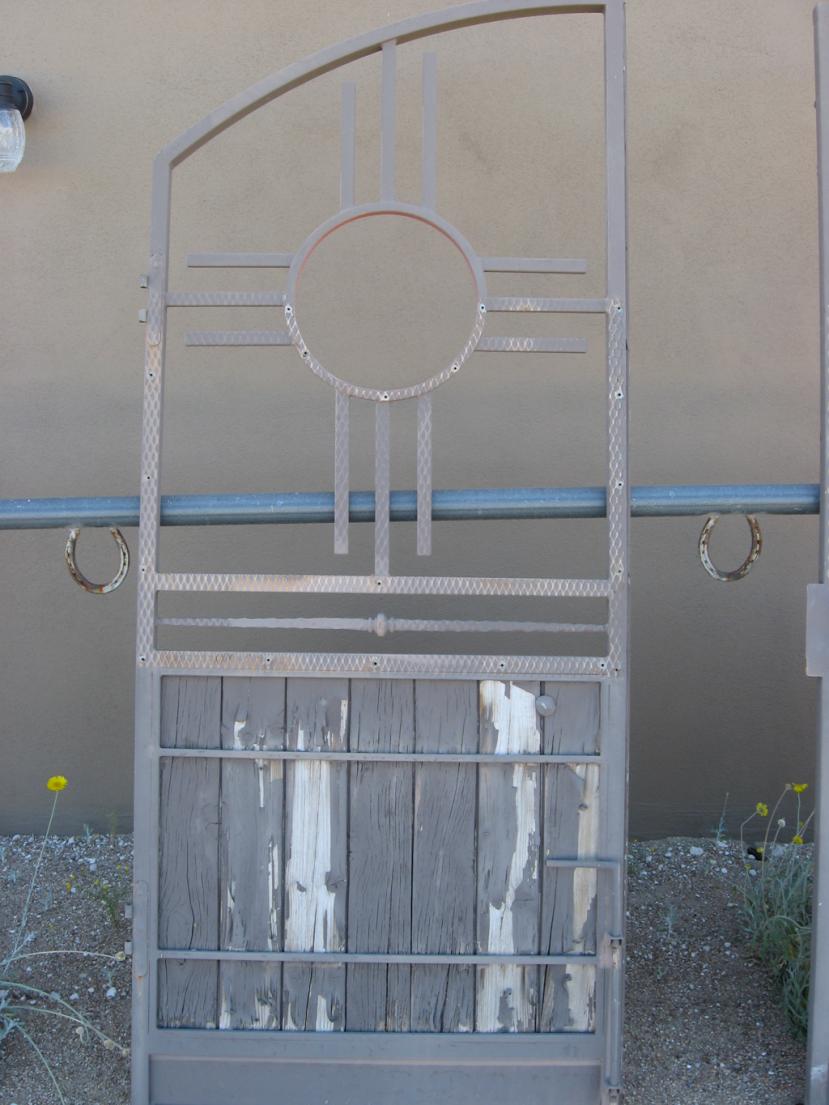

My first real attempt at "wewdin."
Here is the rather nasty gate set I started with (its a twin gate)...
Wood never lasts in Arizona and the design didn't go with the house. My wife found a gorgeous gate in a home & gardens book that she wanted. I stared at the picture for a few minutes and realized that the gates we had were almost identical in outside frame shape. That was the reason I decided to get into welding, something I have long wanted to do. Having the two gates re-worked would have run about $3000. (We had a new wrought iron single gate made almost 20 years ago and it was $1600.) I figured the time and effort to cut these up and then have them re-built would pay for my equipment. So far I am ahead....

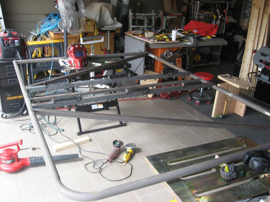

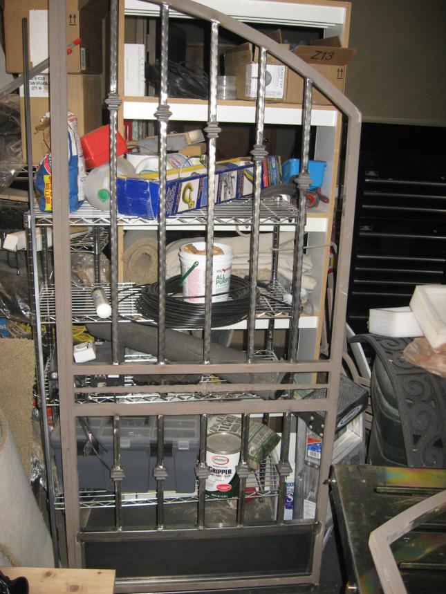

Here is what the "revised" gate looks like...
Its sister got the bottom completed this morning and I'll get the stiles in later this week. Amazingly, I am almost out of 75-25 gas. When I run for more I think I'll get the bigger bottle.
I have been a woodworker since I was in high school. Metal is a whole 'nuther animal. Getting the pieces just the right size and shape takes a little more effort. And, the assembly is done throughout the process where woodworking usually assembles at the end. Its been challenging but its always good to learn a new skill. After this gate, I have to create a new one from scratch and then modify a smaller entry gate for our back yard. Right now, I am out about $1600 in equipment and steel and have these two gates taken care of plus all the materials for the yet-to-be-created gate. At the local going rate, three gates would have run me over $4k. Momma's happy. Ray's happy. :)

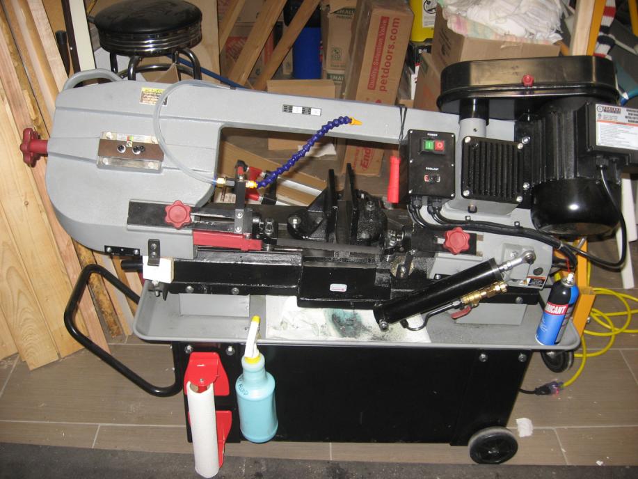

Equipment: Somebody a few months back asked about saws. This HF saw has been absolutely awesome in cutting pieces for this project. I am not sure how I would have gotten these cut without it...
I even cut an eight inch piece of 1/8" steel plate along the eight inch dimension with this thing. Coulda cut a 12" piece. Very handy.

I heard good things about the HF saw.... although it pains me to shop there....
I must say, I do own a HF portable band saw... and it works great once I put a Morse 811 blade on it.... makes a hella racket though... :LOL:
