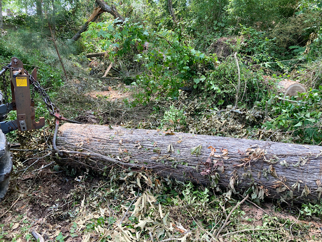

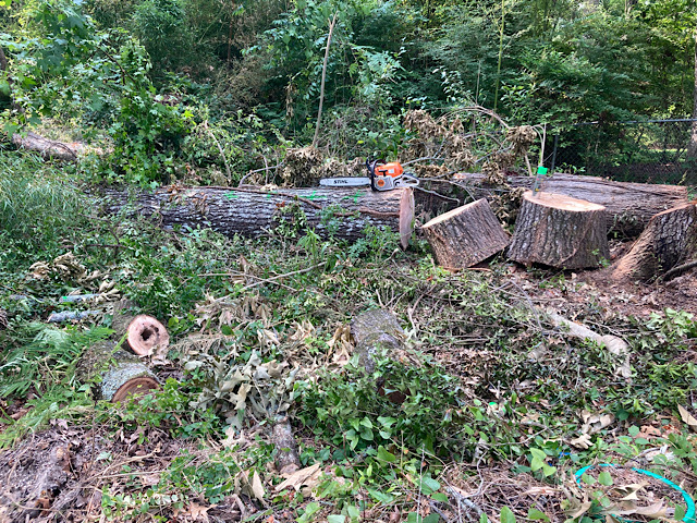

I had to remove a couple of Oak trees which gave me an opportunity to get some needed bridge lumber, etc.
This Red Oak had some rot so I had to buck a couple of firewood rounds off to get to good wood.
This is a nice Post Oak.

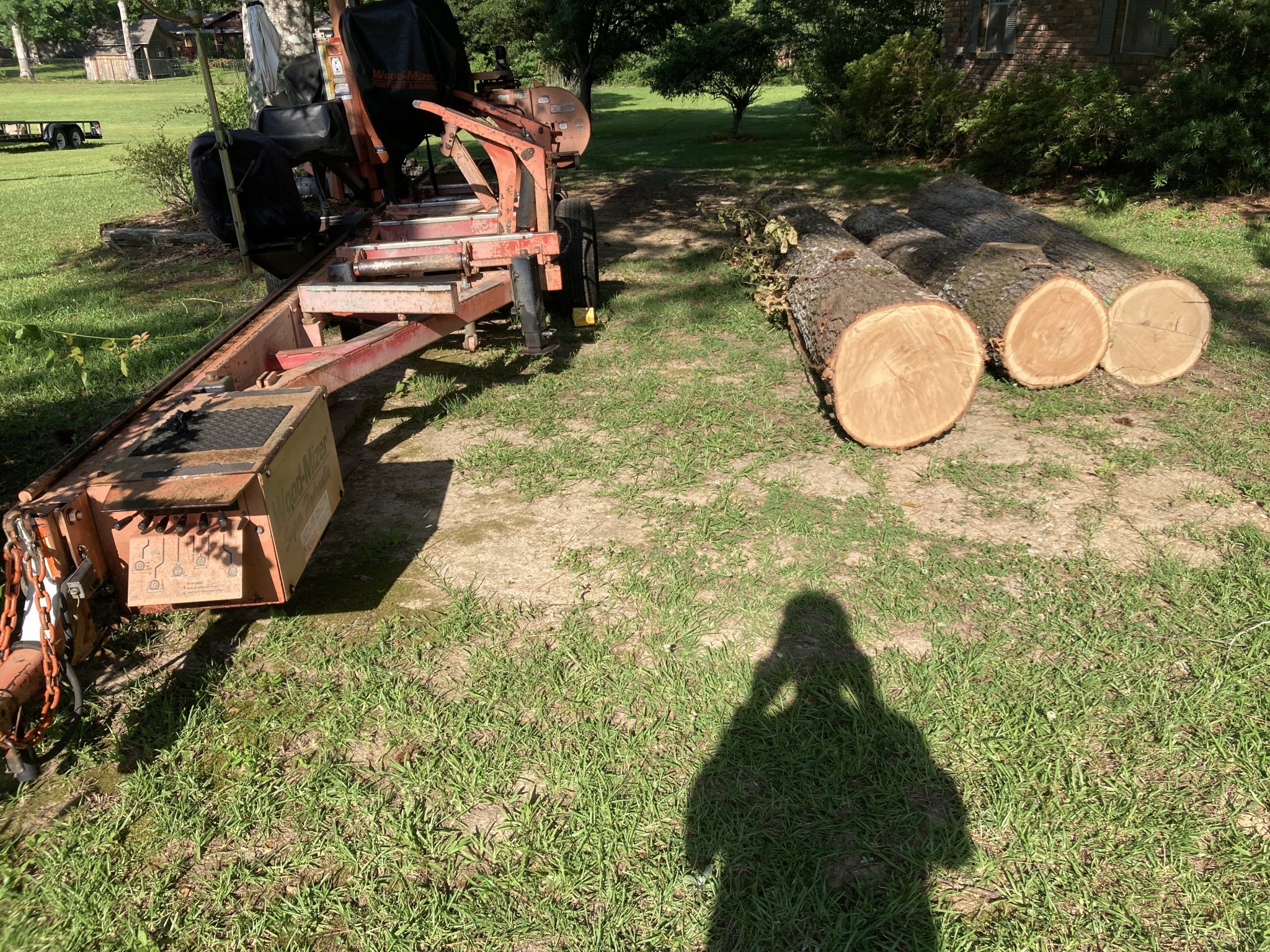

Skidding er out.
Three of the 5 logs are out to the sawmill. I will probably skid the other two out before I start sawing.

Nice logs magic. What are you going to build for a bridge ?

The Post Oak will become 2" bridge decking and the Cherrybark Oak will be the "etc". It will become the railing around my newly rebuilt back porch.

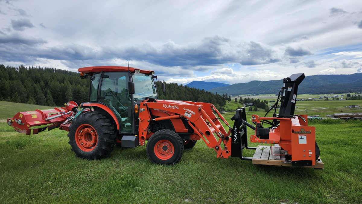

I removed a new refrigerator from the smaller dump trailer, and then moved the snow blower to its summer home.
The more observant will notice that the front guard on the flail is messed up. I ran the flail yesterday over the area where the small dump trailer had been sitting and forgot to pick up the large wooden block that I use under the jack. The grass was long enough that I didn't see it and the flail tore it up, but not before it tried to exit out of the front. The guard did it's job and prevented injury or serious damage, but I'll need to repair the bar that the guards swing on. Not a difficult fix, but annoying when we create work for ourselves.

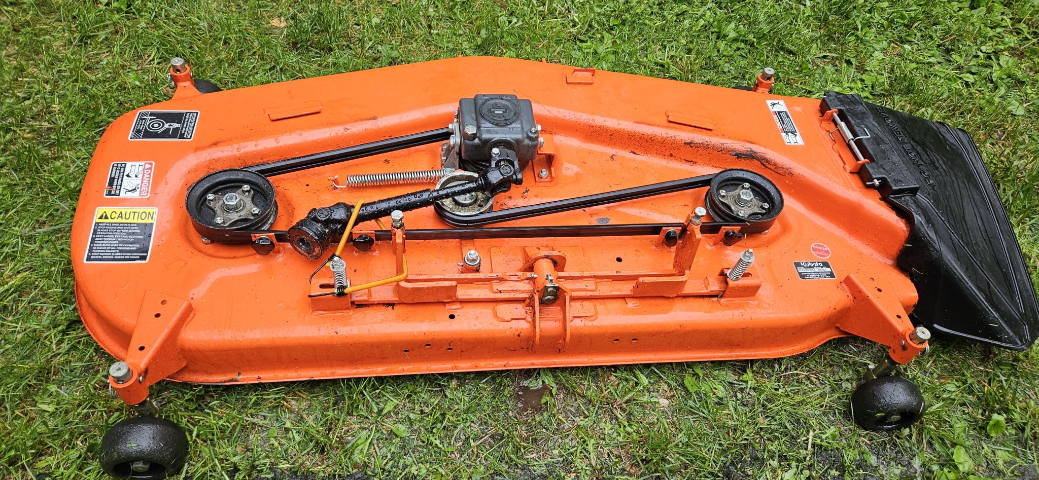

When I bought the BX2370 used the owner needed a pry bar to get the mid-PTO coupler to move forward so it would release, and it was a struggle to attach/detach it when installing/removing the mid-mount mower deck.
I cleaned the shaft and coupling with Xylene and a wire brush, let it dry, then greased liberally (and wiped away the superfluous liberals). It now takes a light pull with the tips of two fingers to lock the coupling open and a slight bump once in position for it to automatically lock closed. The slip-joint is now greased-piglet slippery.
The only down-side is my grease gun wouldn't stay on the zerks without a third hand holding it, so I went to the farm supply store and did not buy any of the cheap Asian import couplers, opting instead to order a LockNLube.
lubed, scraped, and hosed down the deck (guards removed for cleaning)

The block was moving a good clip to do that.

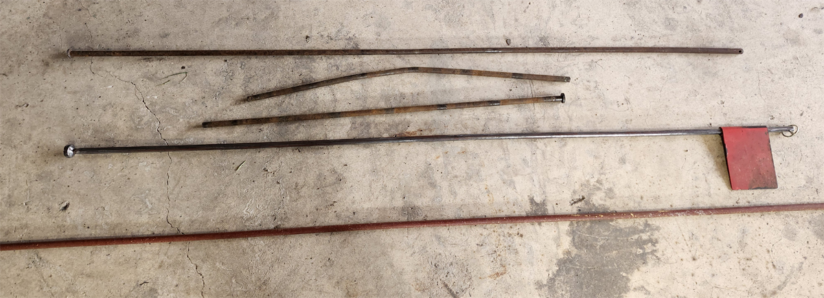

The block was about 8"x8"x12" and it mangled the 5/8" rod like it was a piece of spaghetti. I have lots of material laying around and also the original rod that was damaged during shipping. I had repaired that rod but GWTC sent me a replacement at no charge.

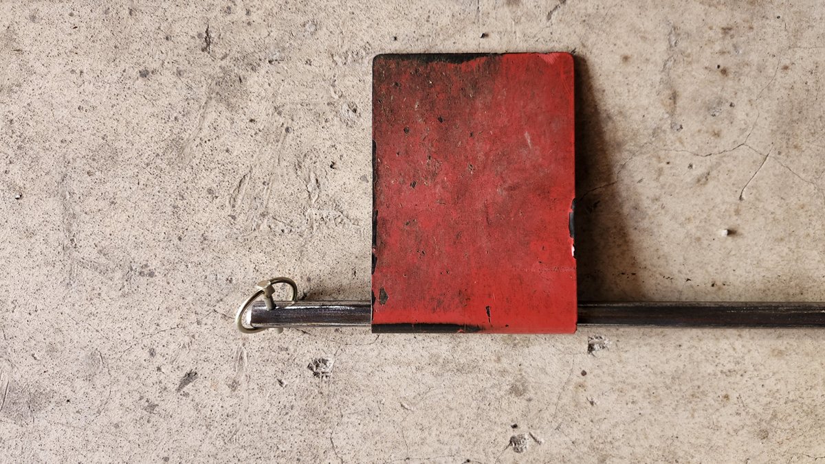

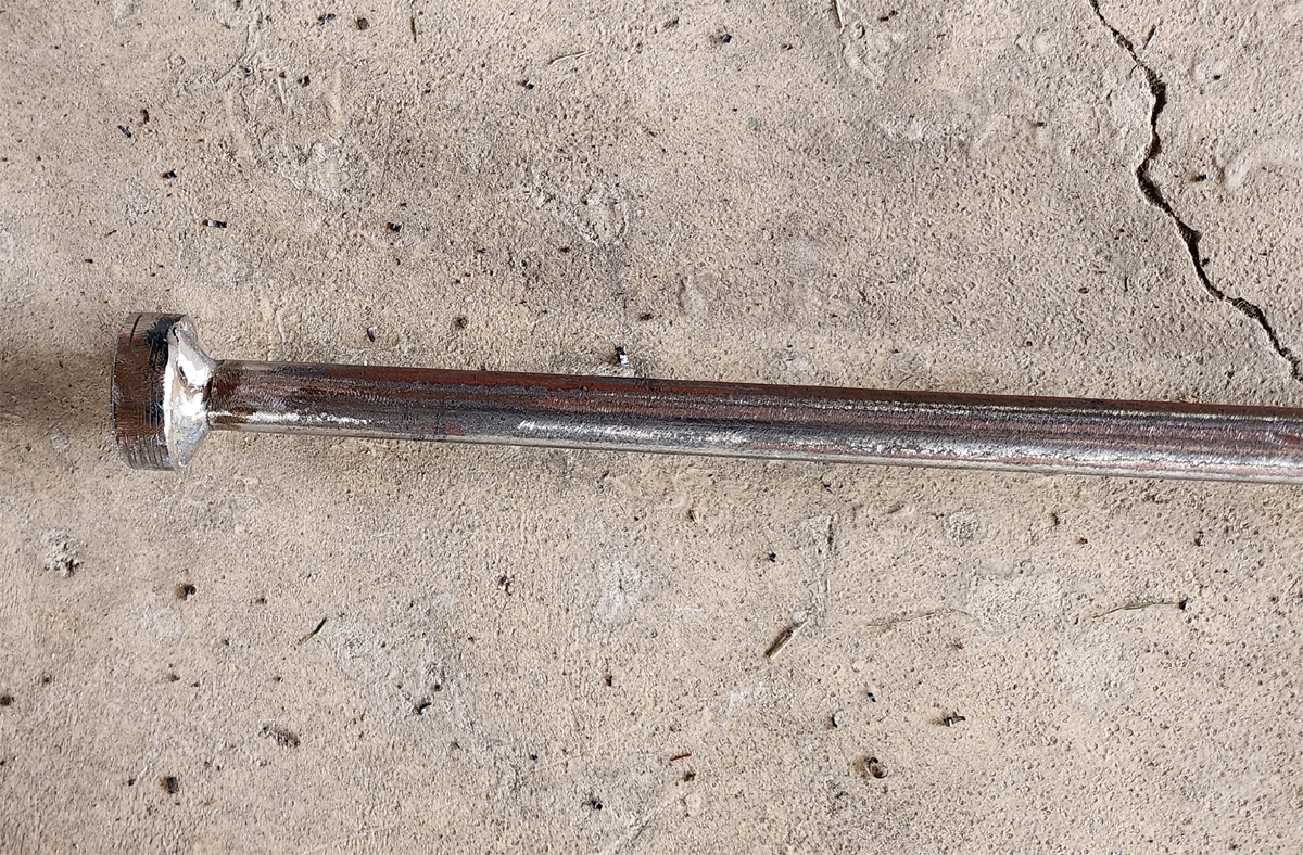

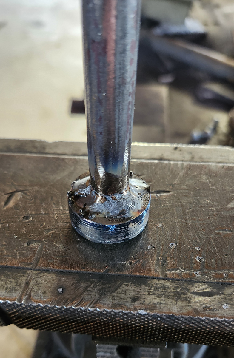

A few posts above this one shows the damage I did last night to the rod that supports the front guards. I found the original front guard support rod and then soon remembered why I asked Courtney at GWTC to send me a new one. It was badly damaged in shipping and it was near impossible to get the rod true enough for the guards to slide on. Luckily I have a bunch of 5/8" rod that I bought a couple of years ago on Craigslist for pennies and was able to make a new rod out of that.

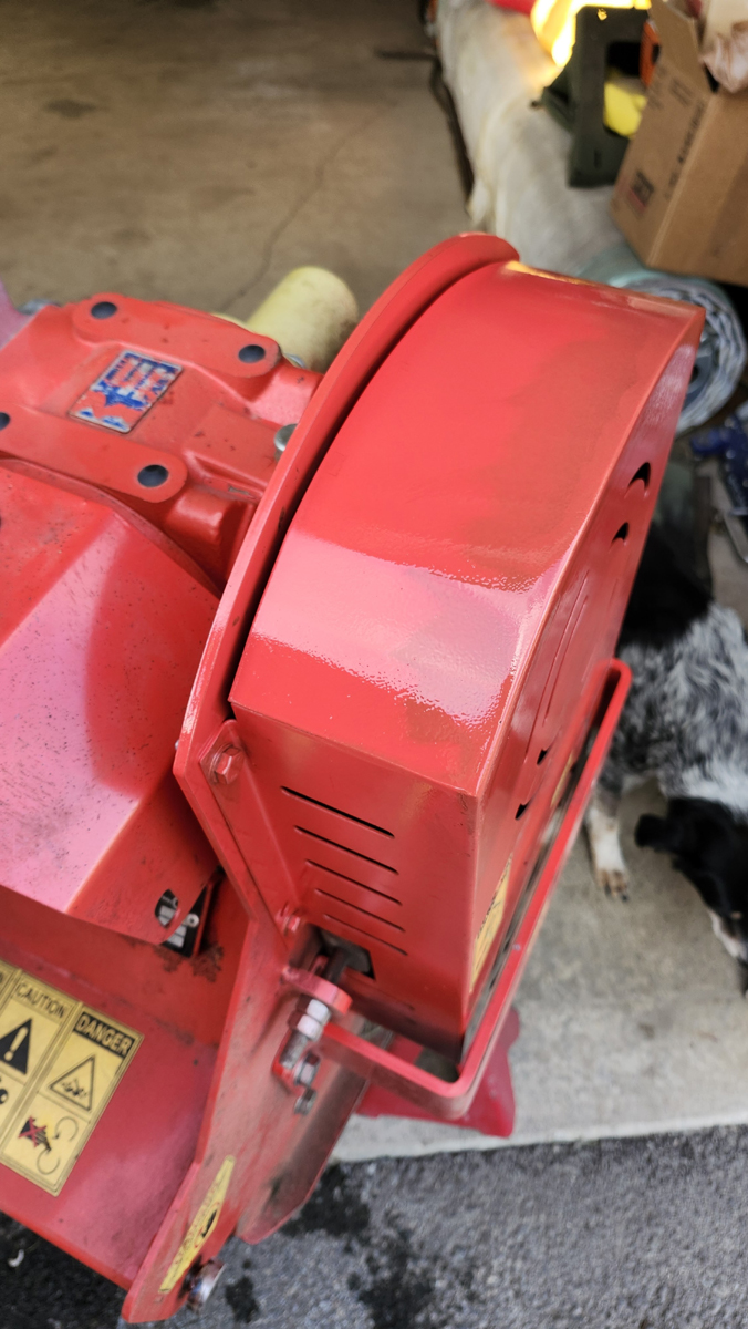

I repurposed the plug that I cut out of one of the pallet forks a few weeks ago. I rarely throw steel away, even small pieces, and this reminded me why. It makes a nice end stop for the rod. I drilled out the other end for a retaining pin. The belt guard was damaged during shipping too but I didn't fix it until this evening so it only took a little over two years to get around to it. :rolleyes: The seam around the top wasn't welded but was nicely done with a minimal gap. Since I had the welder fired up and was fixing the rod, I decided to fully weld the seam and get the guard back on the flail. I ordered color matched paint when I first received the flail since I needed to do some touch up. I'm not a painter but got one coat on the belt guard repair this evening. I'll put another coat on either tonight or tomorrow before heading out to cut a field for someone.
I'm pleased with the guard rod replacement and the work on the belt guard. The top rod is the original one that was damaged in shipping that I tried to straighten. The rod I damaged yesterday is shown in two pieces since I had to cut it to get the guards off. The rod I made is below that, and the stock I made it from is at the bottom.
I really like this flail, and the more I work on it the more I like it. It's easy to work on, repairs seem to be easy thus far, and it does a great job of cutting everything from grass to thick weeds and brush.

Nice job and being a fellow steel hoarder I am always saving any hole saw plugs for use too.

You get extra credit for painting, I seldom get to that.
