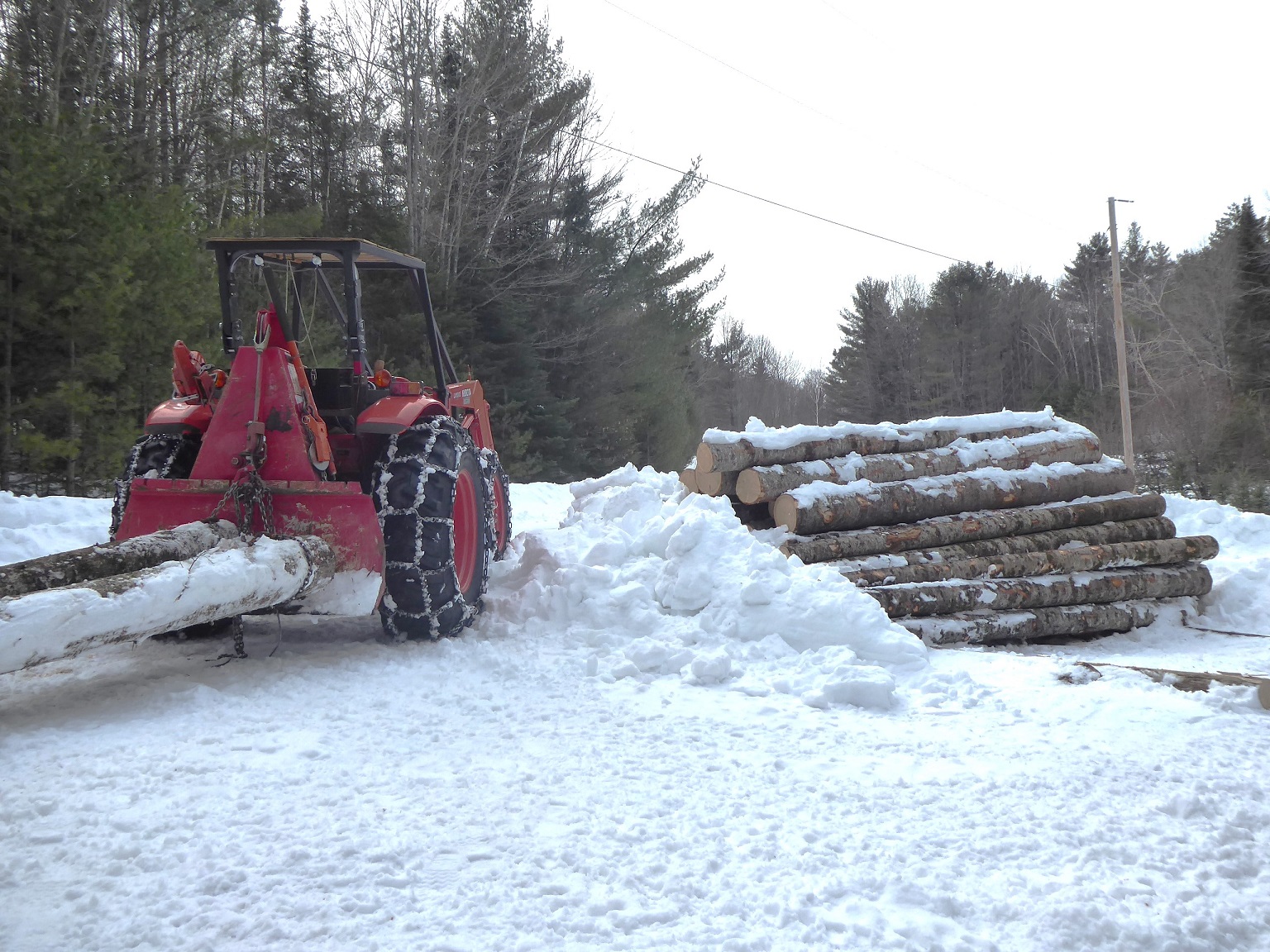

Thank you RCW. The logs are balsam fir which is in the S/P/F group (Spruce/Pine/fir) and used for dimensional (framing) lumber like you said. If I was a younger man I would have a sawmill. I sell what I cut to a local log yard or sometimes called a concentration yard. They buy logs, pulp, and bio-mass from local loggers and land owners. They then resell to mills far and wide. It's most likely that the final destination of my logs will be a stud mill. Here is a picture of part of the Spruce/Fir pile in the log yard in February 2022.
I am a very small operator. Here is a picture of one of my loads on the ground and me backing in to dump a second load. There is about 500 BF (board feet) in each load. They look silly up against that big pile.

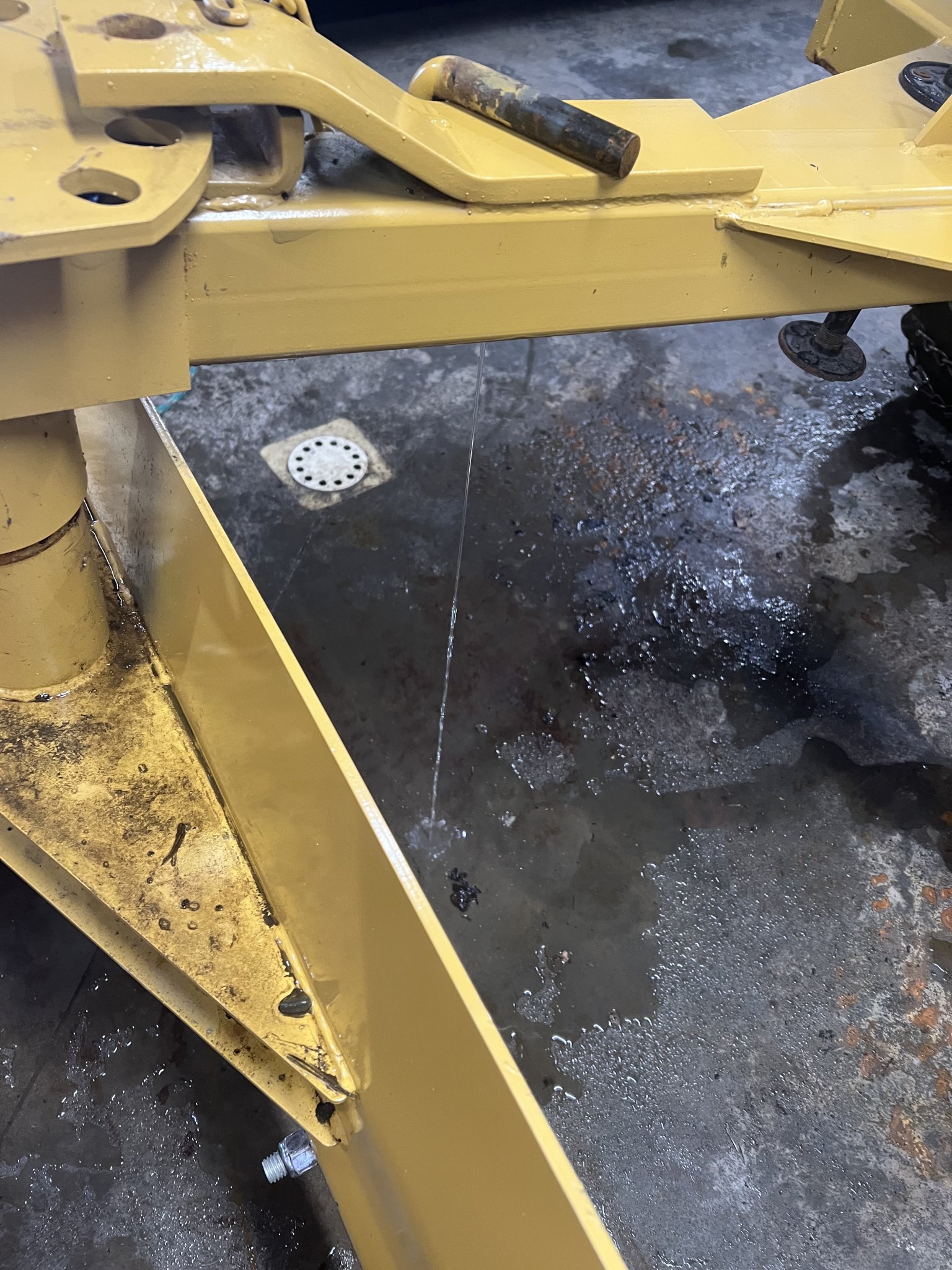

Realized the 3x3 boom on the 5 Foot County Line back blade was collecting water.
Drilled an 1/8” weep hole in it to drain water out. Bet there was almost a gallon in it.
It’s chilly in the garage…..I had to pee almost immediately….😳😉

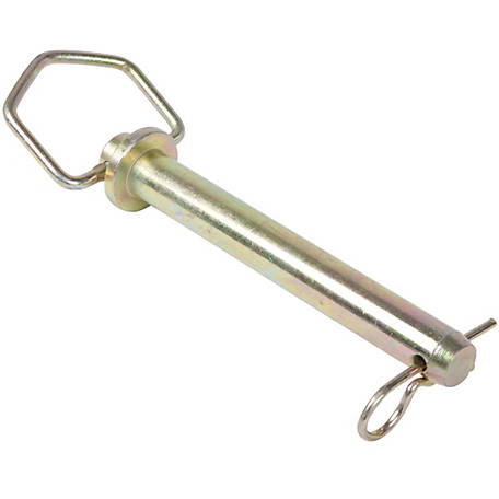

I did the same thing with both of my Tractor Supply (6ft & 7ft) rear blades. I also removed the original lock pin that is hooked on by the chain & welded on the top, replaced them with a 3/4" hitch pin that had a large diameter washer welded to it to keep the rain and snow from going down inside the square tube. I packed some grease around the holes under the hitch pin washer area to help defect water from seeping in. So far so good, it has help tremendously. By design its never going to not have water in it, the best that can be done is drilling a weep hole like you an i both did.
If i can ever get a picture uploaded here, i`ll post what i did when i replaced that pin. Its really easy and simple, and it really helps. I can copy/paste a pic of the hitch pin i bought from TS. At least you`ll be able see what it looks like.
As you can see, that wide washer will cover the hole pretty well and keep water shed away.
EDIT: i want to add, that i did have to cut the new hitch pin shorter to fit in the shallow hole.
I used a connecting link to reattach the chain onto the new pin.
