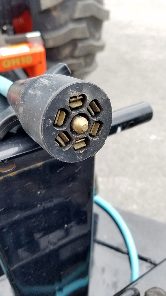

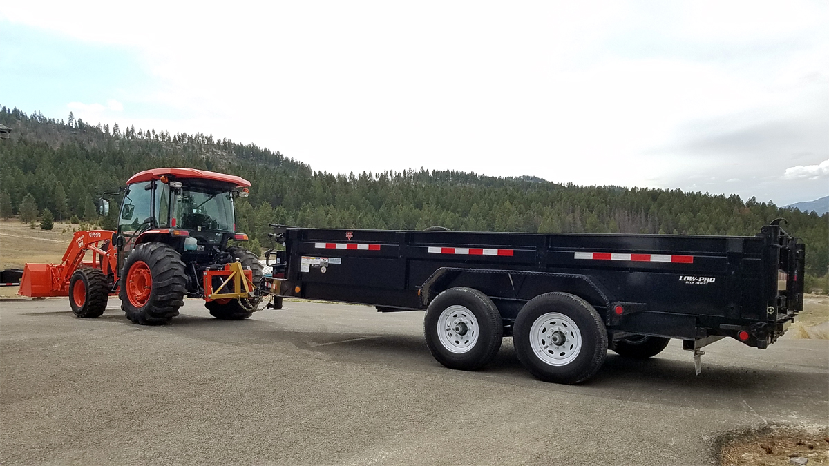

Last year I bought two remote kits for both dump trailers so that I can raise/lower the bed without the need to run the controllers and cables from the pump to the cab of the truck or tractor. I finally got around to installing them on the trailers and they're a game changer for sure.
I used the tractor this morning to move the 16' dump trailer, dump the gravel, wash it out and get it ready for a friend to use for a few days. I also discovered that the 7-pin plug on my trailers won't work with the 7-pin outlet on the tractor. Maybe Kubota has an adapter?
I bought the 10' single axle dump trailer to run behind the tractor and make trips to the dump, but it's much easier moving the trailers around using the tractor. I won't hook up the 16' dump for any reason other than to move it a few feet since it's big and heavy.

that trailer set up is awesome! :love:

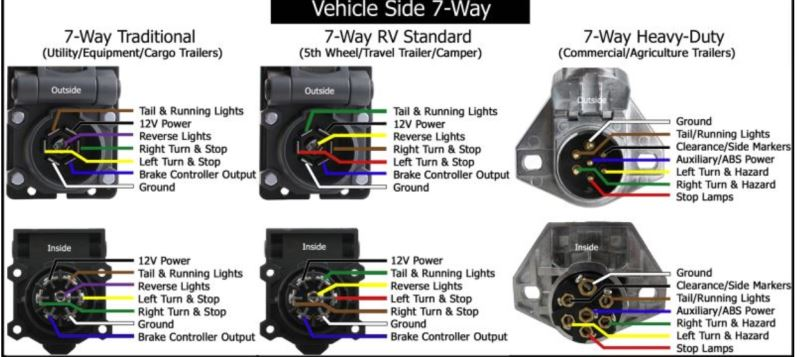

@mcmxi like this, 7 way agricultural to vehicle adapter
The 10' single axle dump trailer behind the MX is a really nice set up but the big 16' is too much trailer, but the remotes are seriously cool. So much better than messing with the handheld controller and cable. If only I could open and close the tailgate without getting out of the truck. That would make trips to the landfill really easy. :LOL:
Thanks for the link. I'll probably remove the Kubota installed receptacle and replace it with the standard 7-pin receptacle. The Kubota one is nice though being made from pot metal. One of the possible issues is that the brakes on the trailer will lock up unless I add a brake controller in the cab of the tractor. I have a spare controller so could do that.

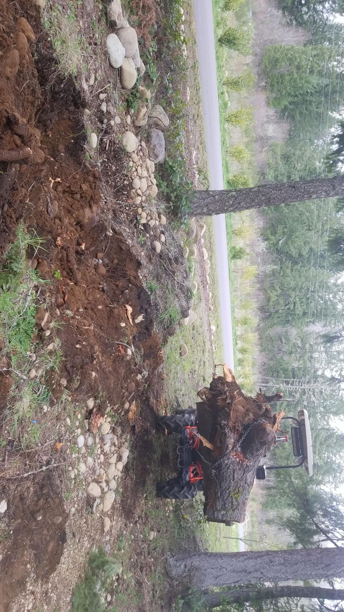

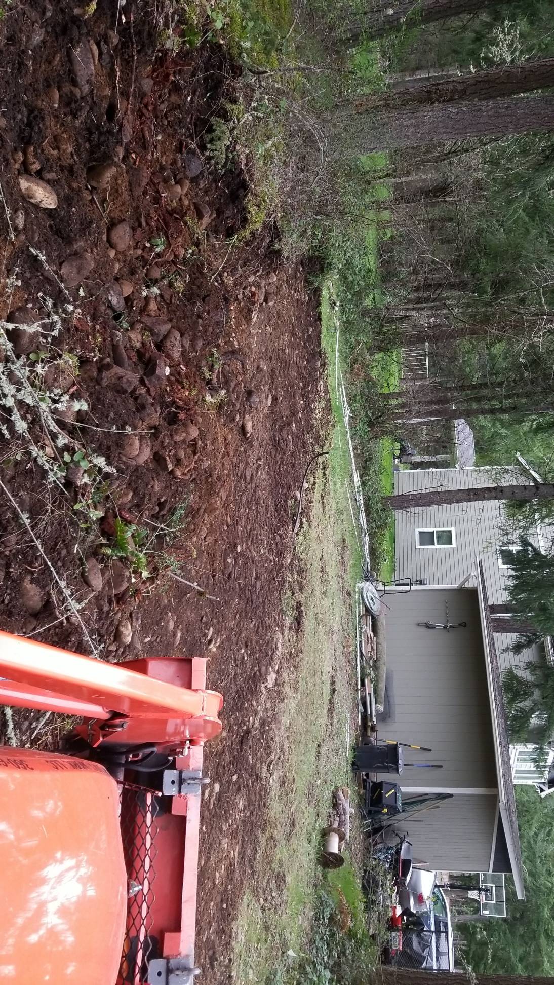

Just some pic's of a job I'm doing.....brush hoggin to start, then clearing out a spot to move the shed into.
Adding top soil and clearing out underbrush in the front.
After all that is done, I start thinning out the woods and removing all the dead/downfall stuff on the acreage 20220328_101320[1].jpg 20220328_110430[1].jpg 20220329_122658[1].jpg signal-2022-03-28-15-01-28-055[1].jpg signal-2022-03-29-15-14-47-781[1].jpg behind the owners house.

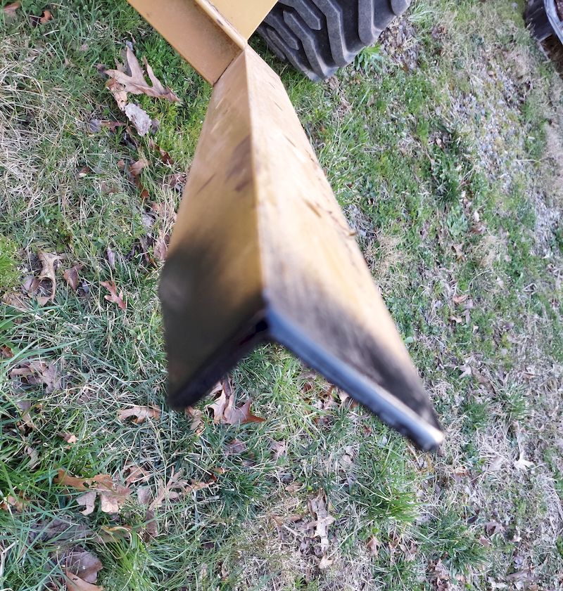

Yesterday I broke out the angle grinder and tapered the ends of the carry all a bit. Makes it much easier to get the arms into a pallet or tote. I just cut the bottom at an angle, then went to the flap grinder and rounded off all the edges. Works much better.
