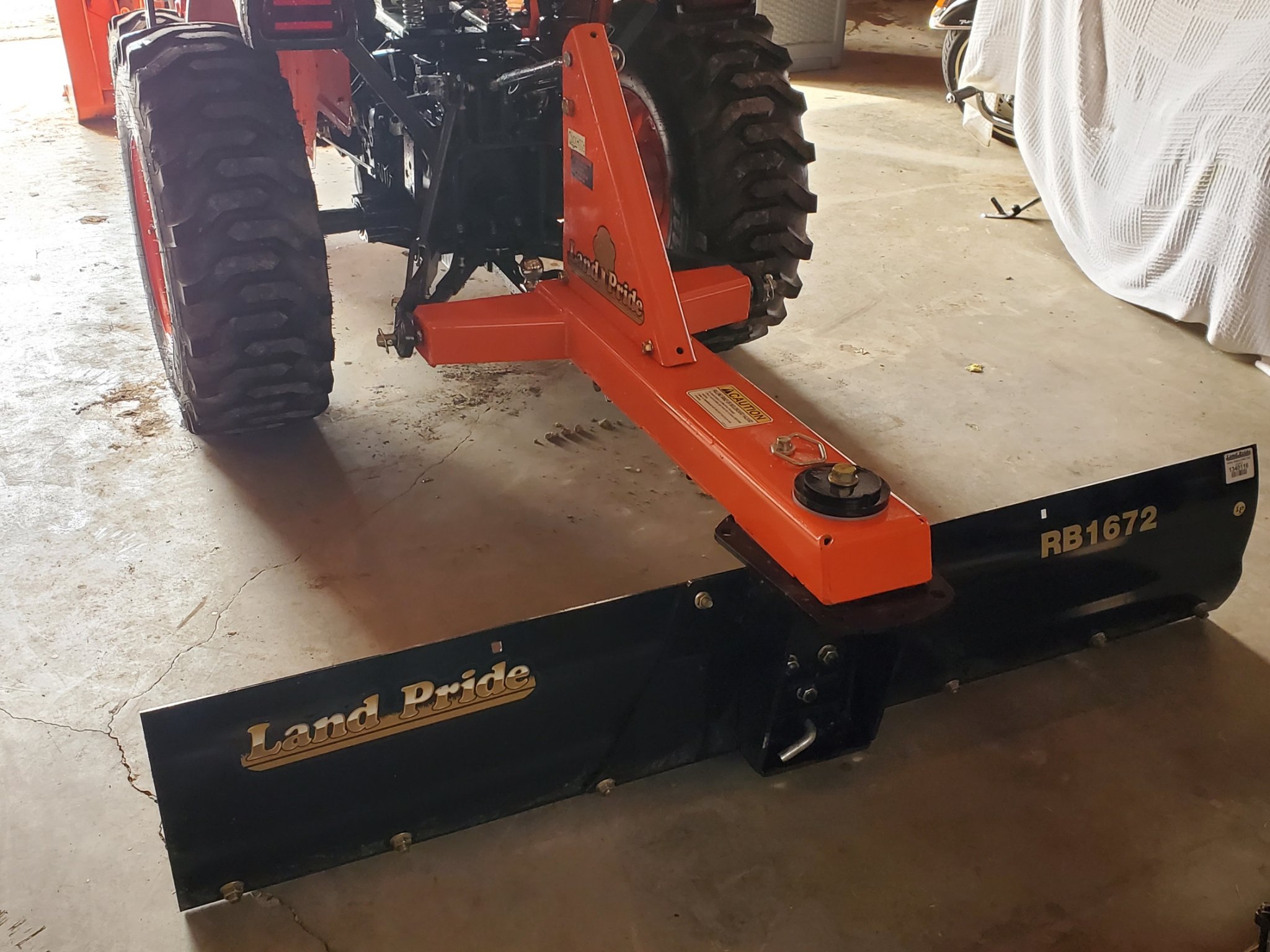

Got a pretty good deal on a LP RB1672 blade today for my little B from FB market. About 2 years old and used less than 2 hours (500 bucks!) STILL waiting on back ordered backhoe (BH70.)

Soon a gallon of diesel may be 500 bucks. 👍 great deal for that blade.

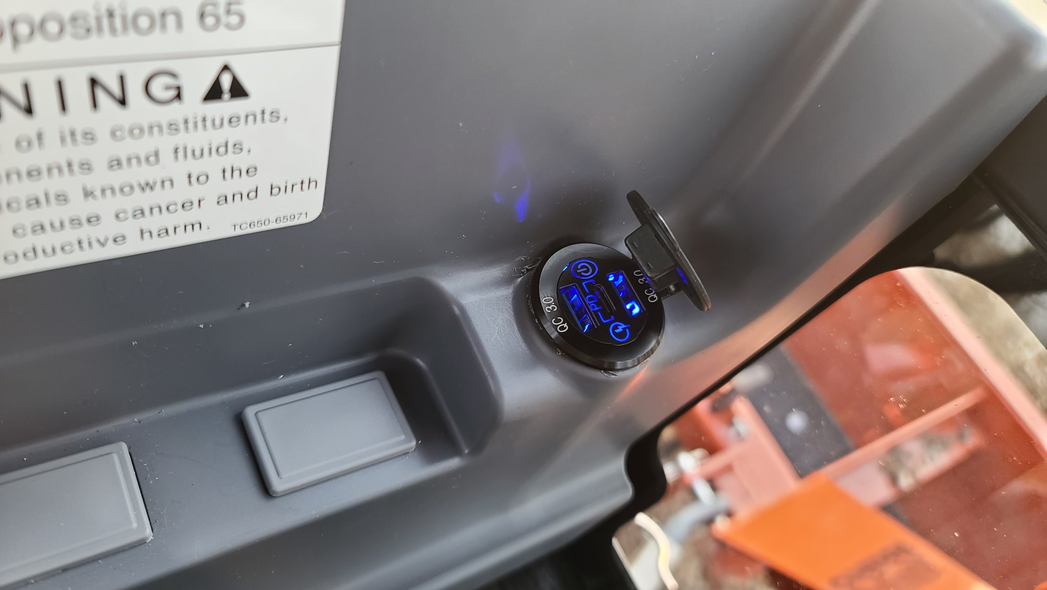

Got this installed today in the 70 degree weather. Works great just put two male blade terminals on the wore that came with it and plugged in to the plug up under the interior panel. Had to dremel the hole a little to as the factory hole was only 1 inch. This is 1.25. View attachment 76079

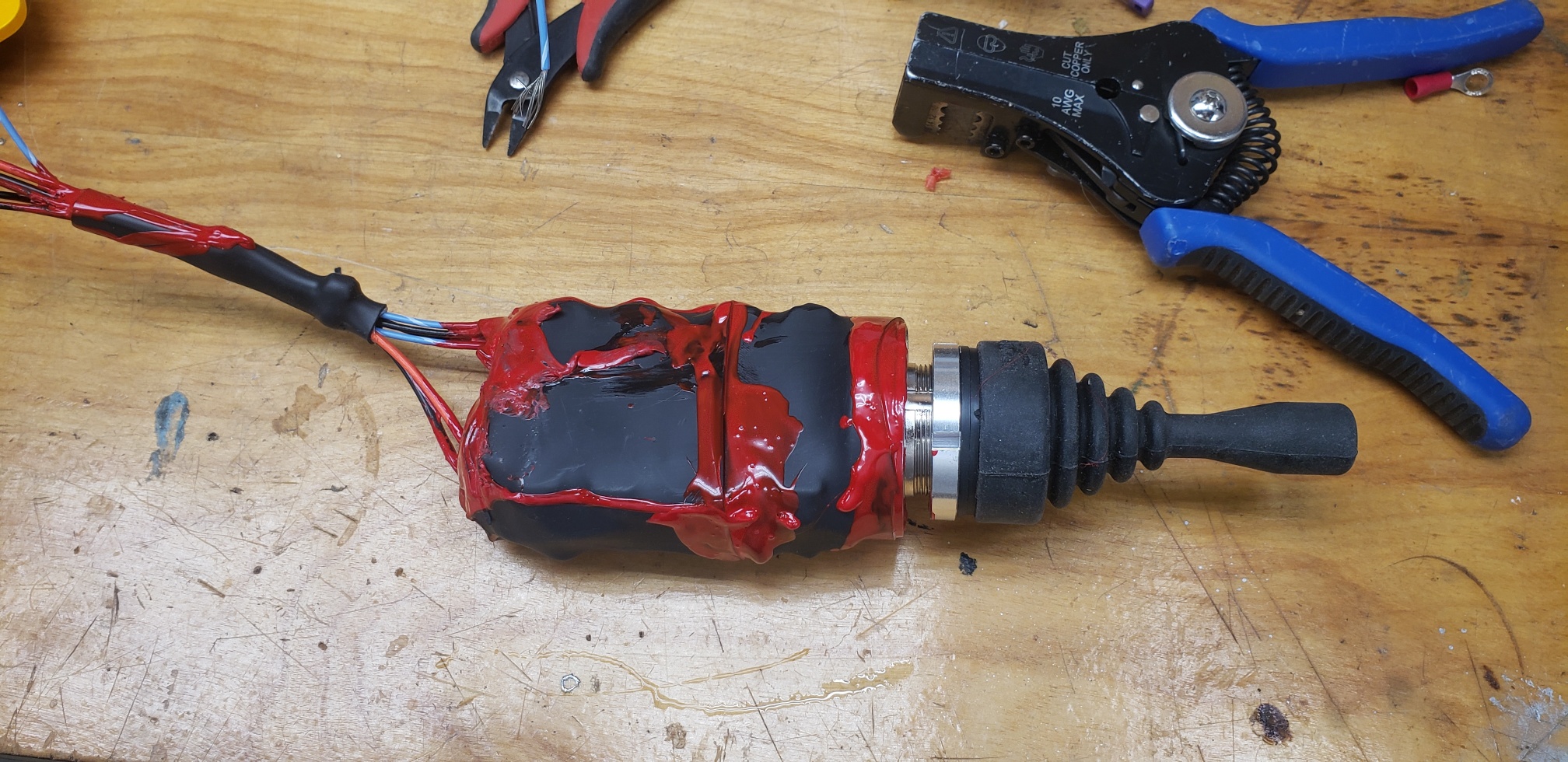

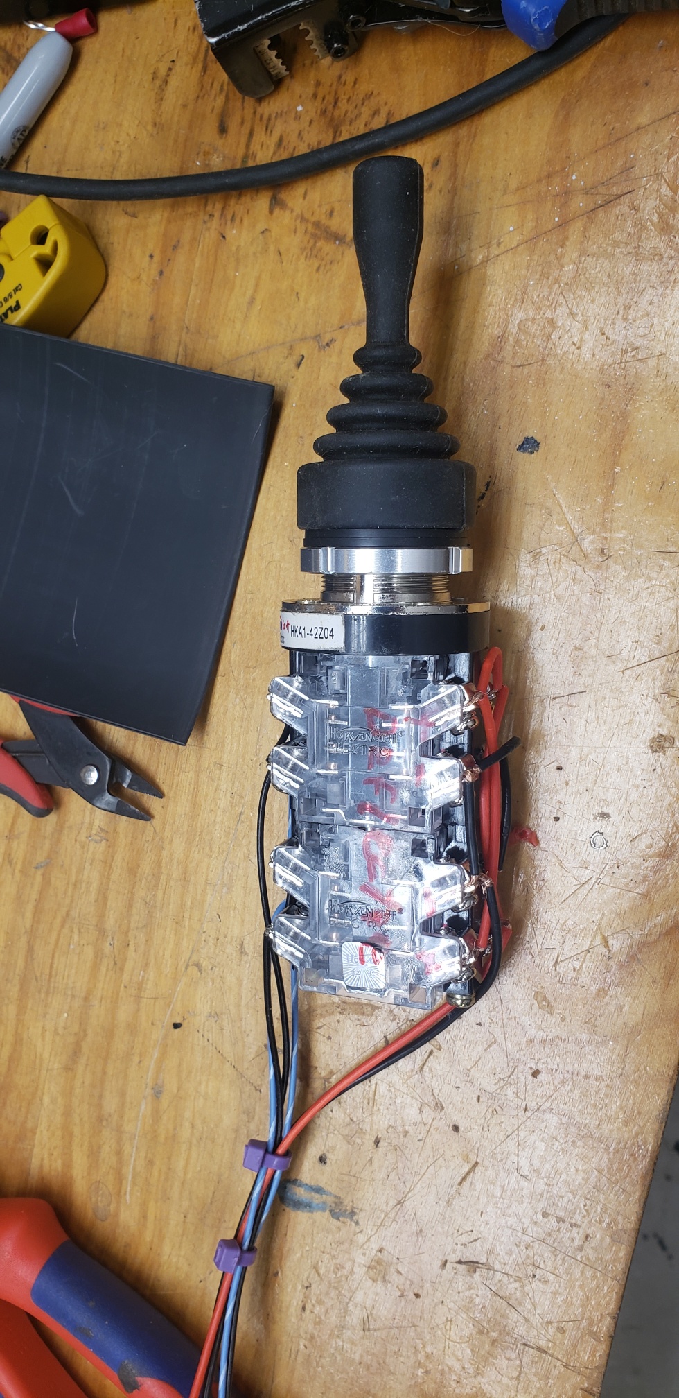

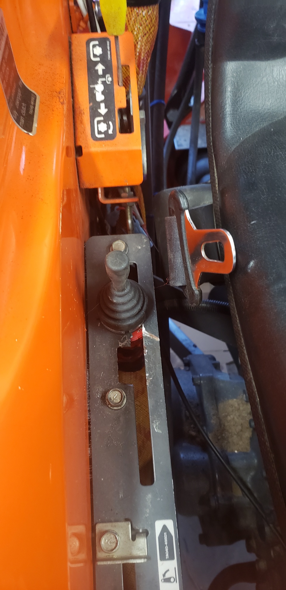

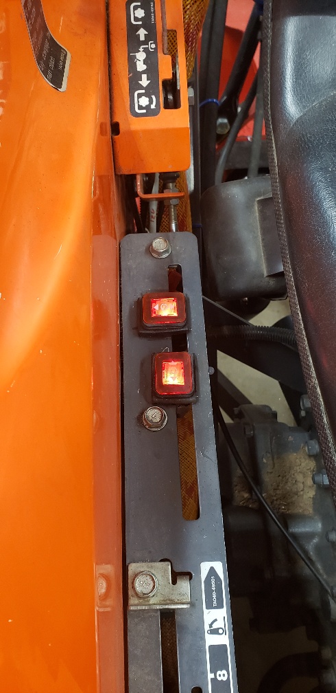

Today I finished the install of a joystick to replace the 2 rocker switches for my snowblower. When I converted the blower to electric chute rotation and deflector control I selected the rocker switches. They work but. . . the extra material at the fingertips of my gloves made it clumsy.
I found the joystick on Aliexpress and initially thought I was going to need a bank of relays to interface it. Turns out their switching description wasn't exactly spot on but perfect for my application, no relays required.
The original two switches:
New joystick
I used heat shrink to seal it. On the bottom open end I filled it with coaxseal and then painted over with liquid tape.
and installed
I need to touch up that bracket - the disk grinder almost wenttru it in an instant.
Good thing that I took a little bit of time and read your post. I thought from the pics that you made a bomb and delivery system for your tractor. :D

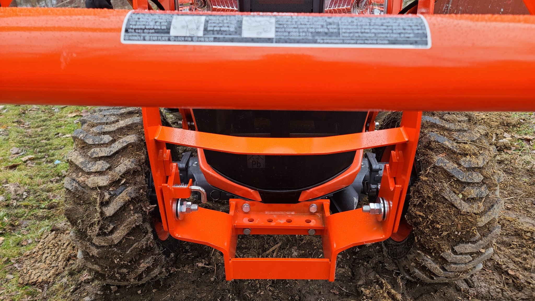

Ordered a et of LED lights/wiring and received my grill guard because I know without it I'd put a stick through my grill in less than 10 minutes of testing my grapple. Now that I have the guard I'm sure it will remain pristine.
Still at 2.x hours on the tractor since my ground is still too wet to get anything done without leaving ruts everywhere. I made my first payment though.
