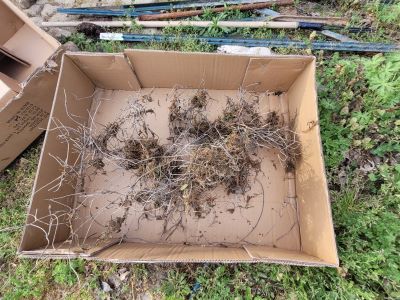

After I was done, cleaning up, I found that I had picked up a piece of fencing - not sure when or where. I didn't notice any problems with the tiller - figure that.
Cleared out that mess:

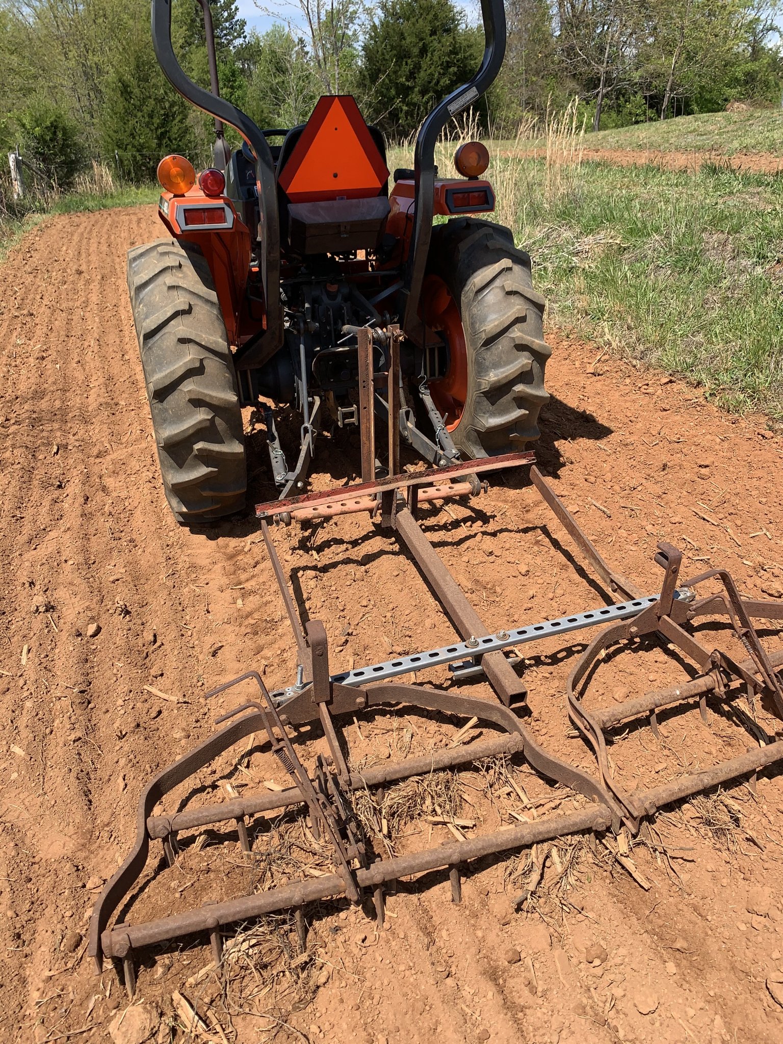

I’m not sure but I think that this might be my first post since upgrading from my ancient 70-year-old 8N to my newly acquired 2003 L3000DT. In reality, I don’t have enough acreage to justify a tractor. While the tractor is quite an update from the old, this basic Kubota model is about as close as you get to a modern version of an old bulletproof 8N.
So, now it’s spring and I am prepping my garden plots. First, I deep-tilled using my 7 shank scarifier. Next, I cut the clumps of grass-laden red clay soil with a disc harrow. Besides the red clay soil, this land spent nearly a century being compacted by the hooves of horses. So breaking down the clods is a challenge.
My solution...hillbilly engineering or “Fabricobbling!” Among my two-wheel David Bradley garden tractor collection, I have two drag harrows. Using my earlier cobbled trailer toter (rusty scrap angle iron), I managed to fixture the two harrows parallel in a manner that keeps them fully functional and in a way that keeps them intact for their original design and function. Overall, worked great AE5C4DA7-56BC-46C0-ADB6-A0BA7F6B49A4.jpeg

I love your definitions and usage of "ancient" and "Fabricobbling". I use the term "redneck" in a most favorable and complimentary way. (y) (y)

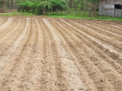

Rows!
I don't have a hiller, need to get one I think. But the cultivator does a passable job.

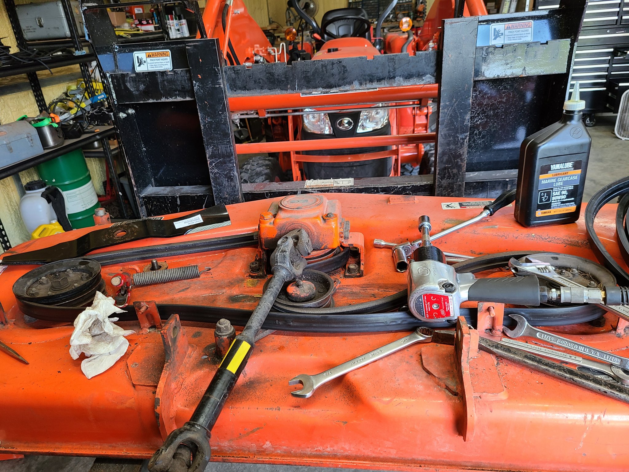

Doing the deck maintenance for the bx2200.. changed out the old worn out blades for new oem Kubota blades, was trying to figure out how the gear box comes off to change the belt, which is in better shape than I thought, had it all lose, decided to check the gear oil in it and it was empty!
Going to put it back together and see how it sounds, the gear box has very little play when turning the driveshaft to when the blades turn.. added the only 80w90 gear oil I have which is Yamaha outboard gear oil so I know that is good stuff.. whatever damage is done is already done.. going to let it sit overnight and see if it is leaking and go from there since I don't have parts for it anyway
I did flush the gear box out and very little metal came out... hopefully it's fine.
Glad I only mowed with it once, maybe 20 min, it is a bit noisy I figured one of the spindle bearings were bad, and ordered a few in anticipation of that.. so I know why it was noisy now..

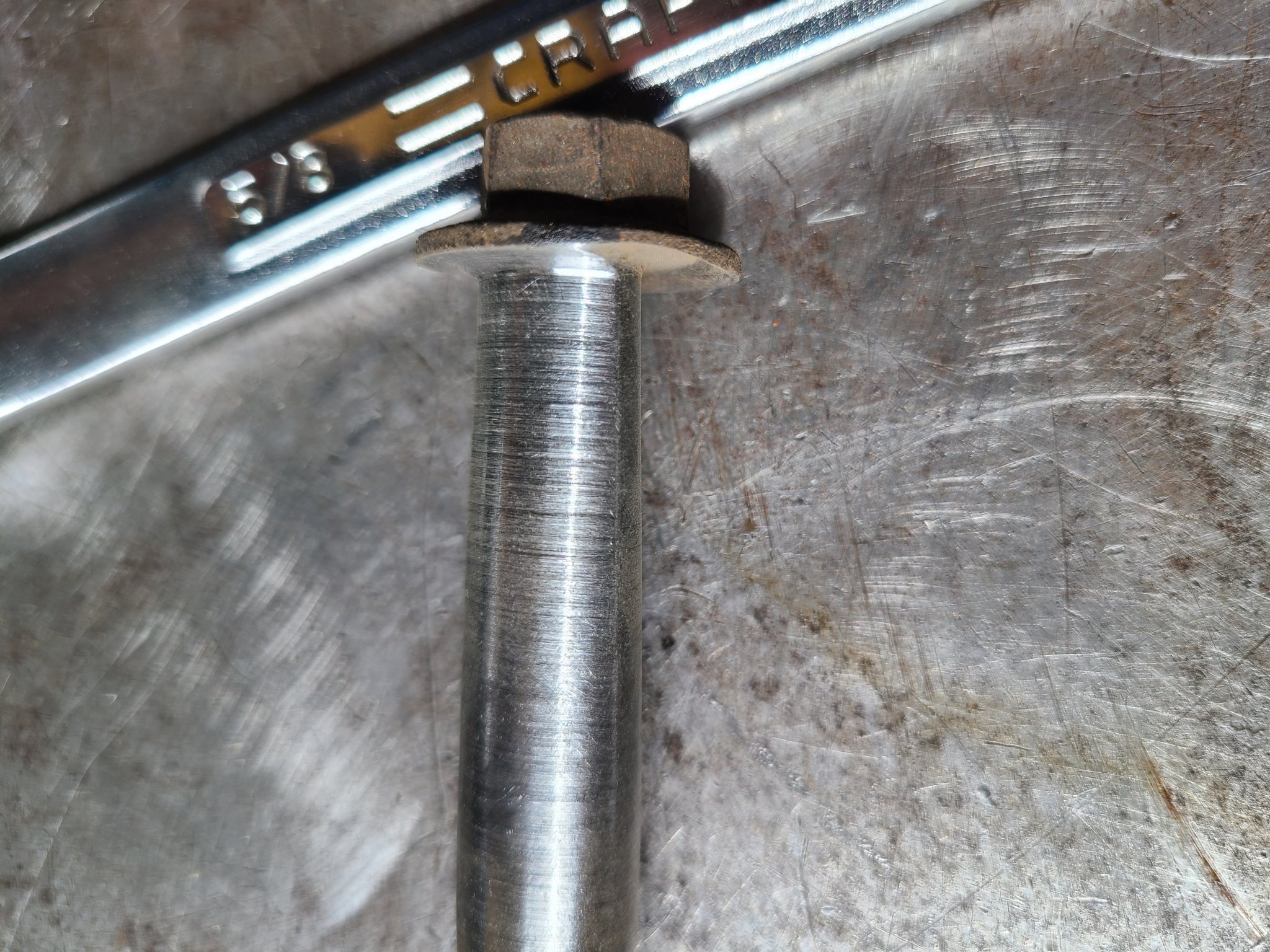

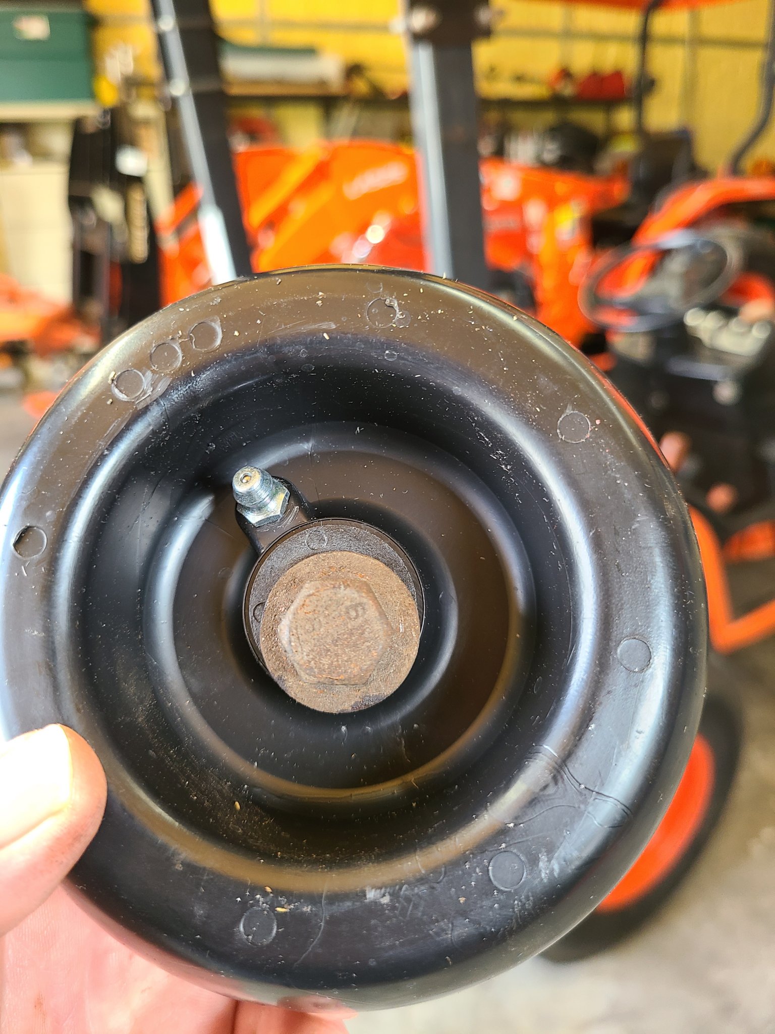

This is what happens when you don't grease your anti scalp rollers.. the bolt that hols the rollers looks like a cam shaft! Going to order new bolts for the new rollers and 1 more of the roller adjustment bars as it's bent and I didn't notice till I tried to take it out and it got stuck half way down..
