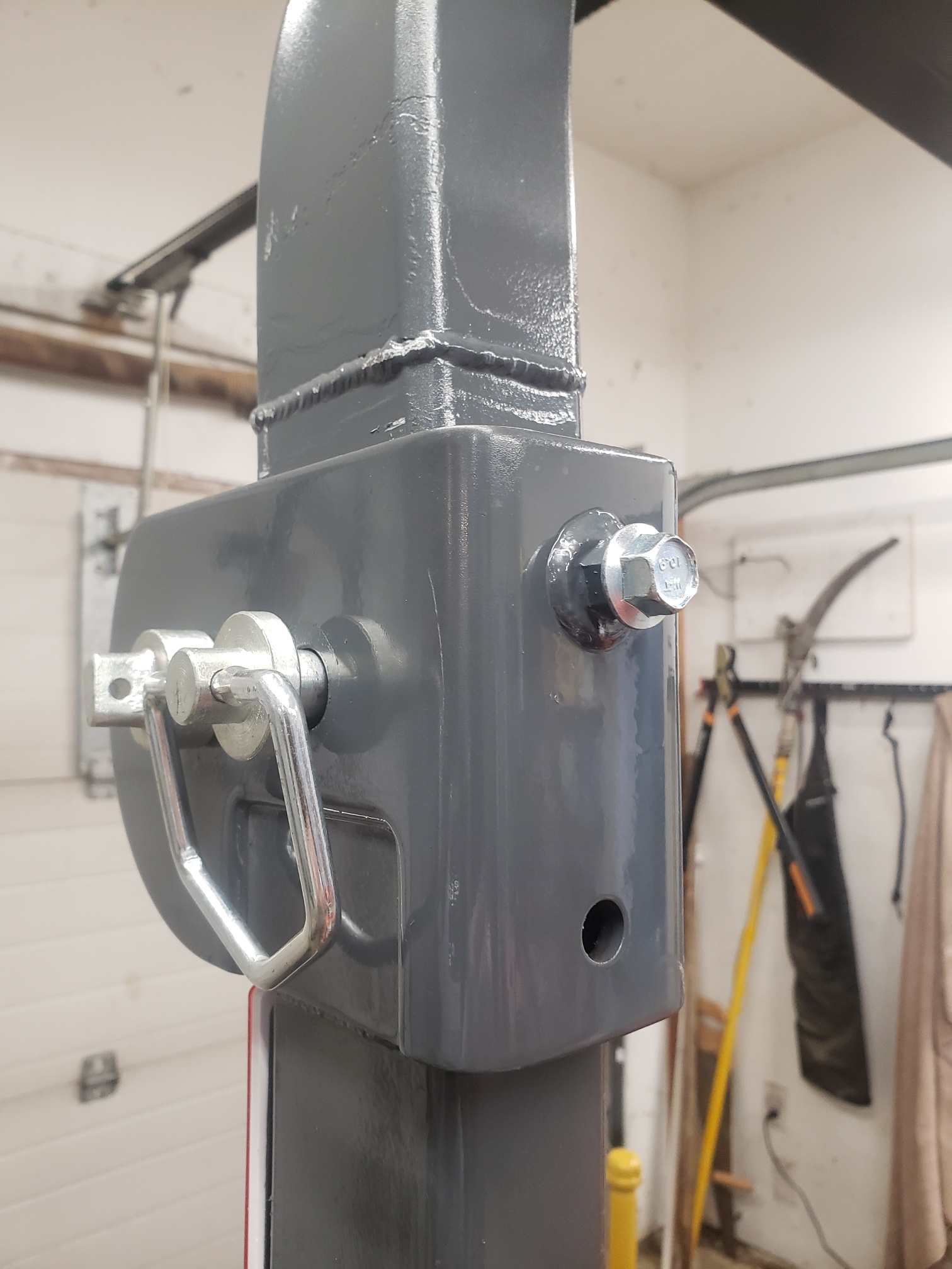

I finally got tired of listening to the rops rattle as I operate the tractor. Found a use for those 2 welded on nuts in the lower part of the rops. Inserted a bolt in each and tightened them down until they removed the play in the upper half.

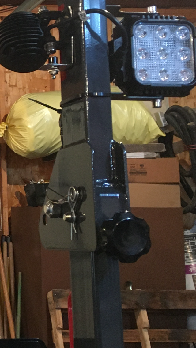

Mine came with the threaded black knobs.
