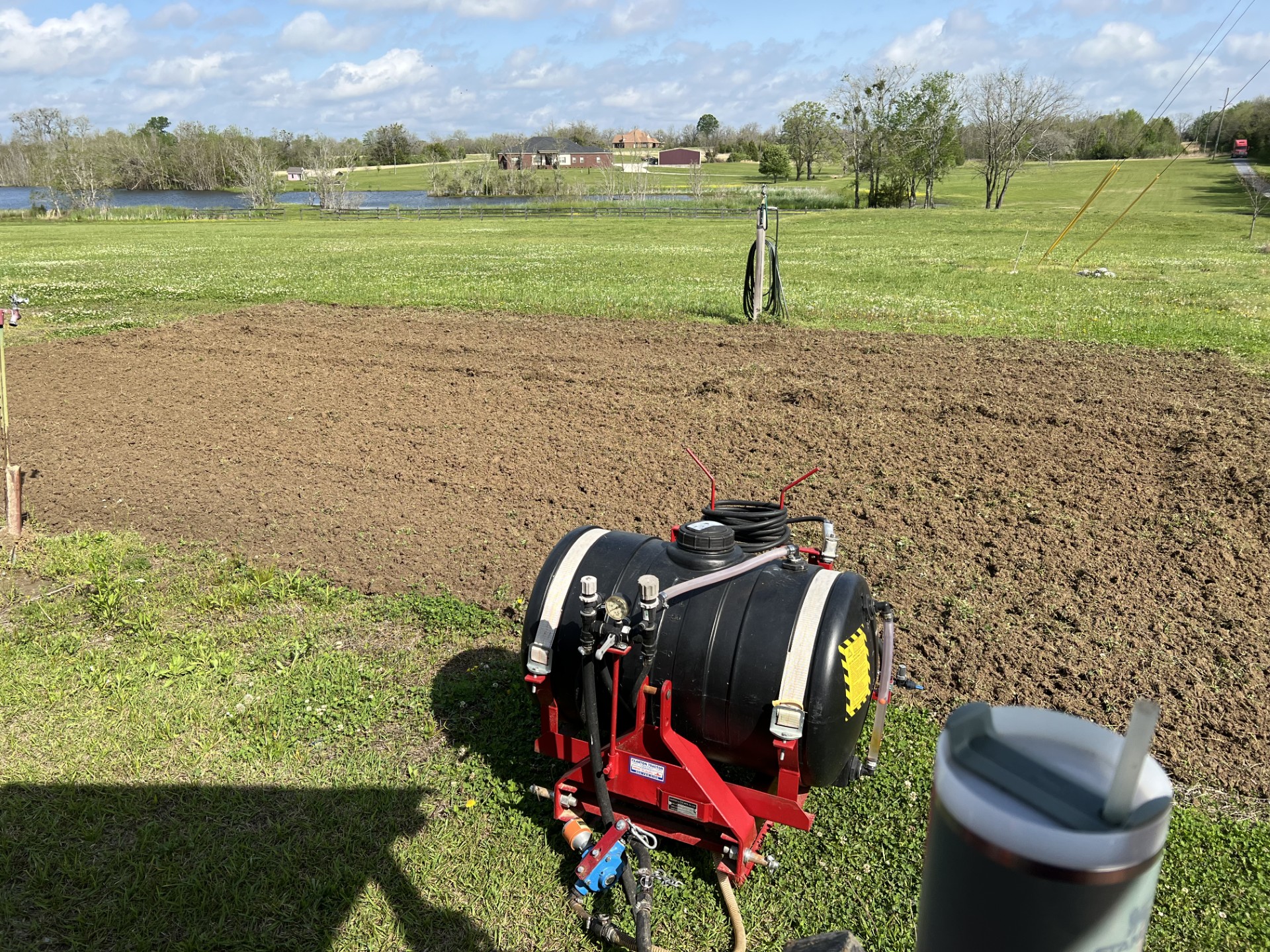

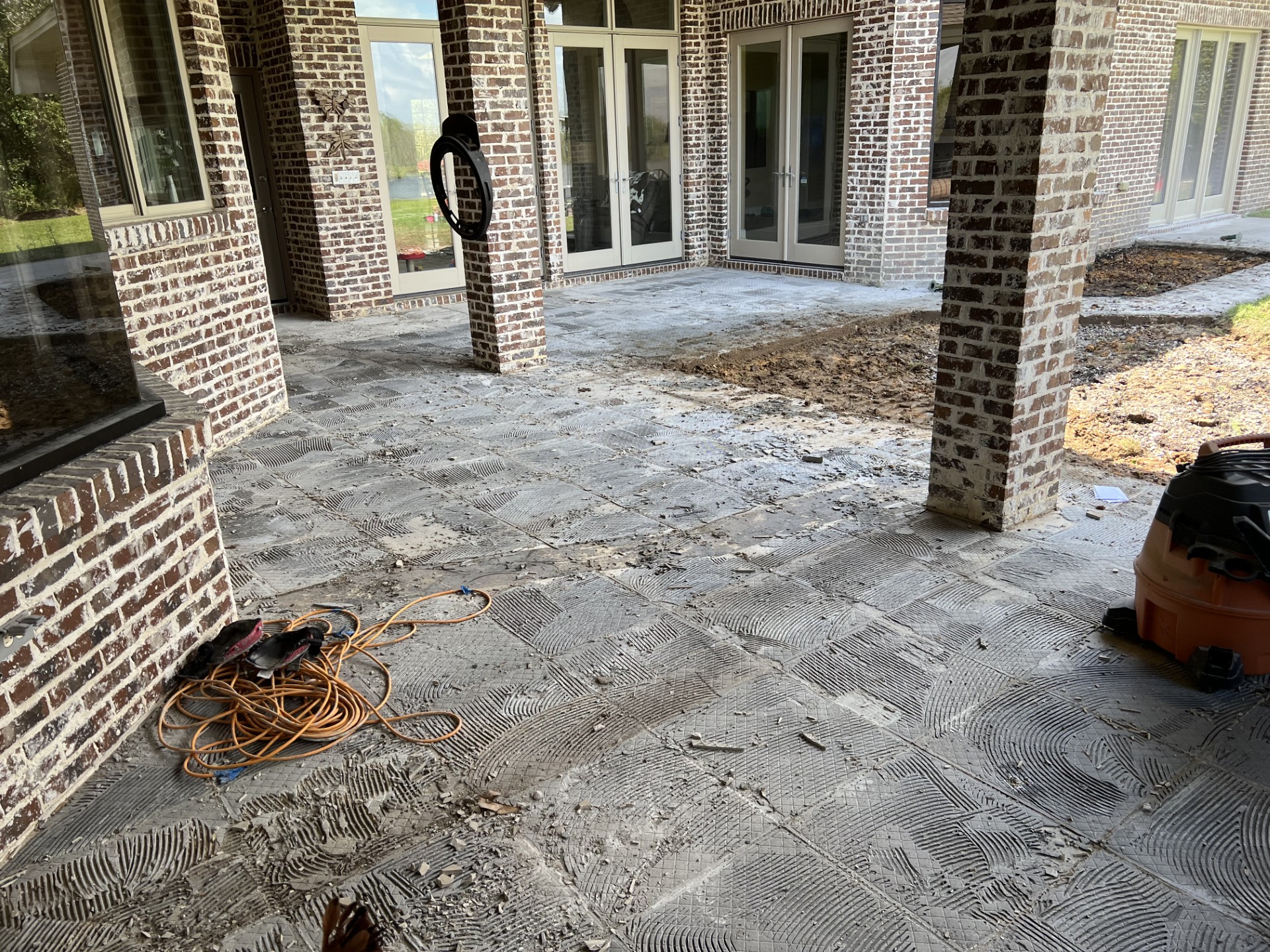

Remodeling the back porch so I don't get sued when someone breaks their $%# on the slick tile some moron put in. Paid a little extra to expand as well. Got a nice discount for hauling all the dirt away and digging it out with the FEL. Did the garden since I had to put the tiller on to break up the dirt.

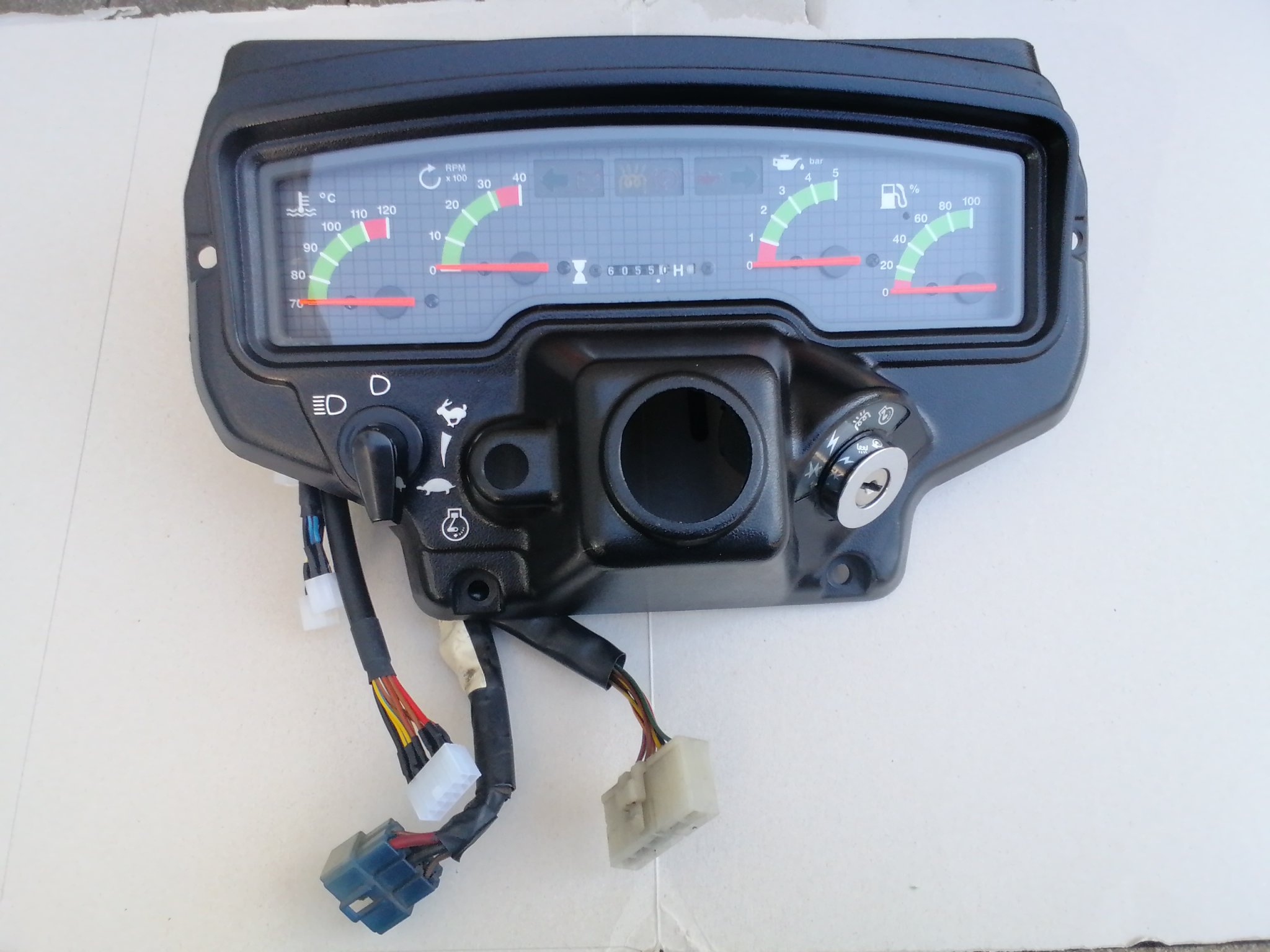

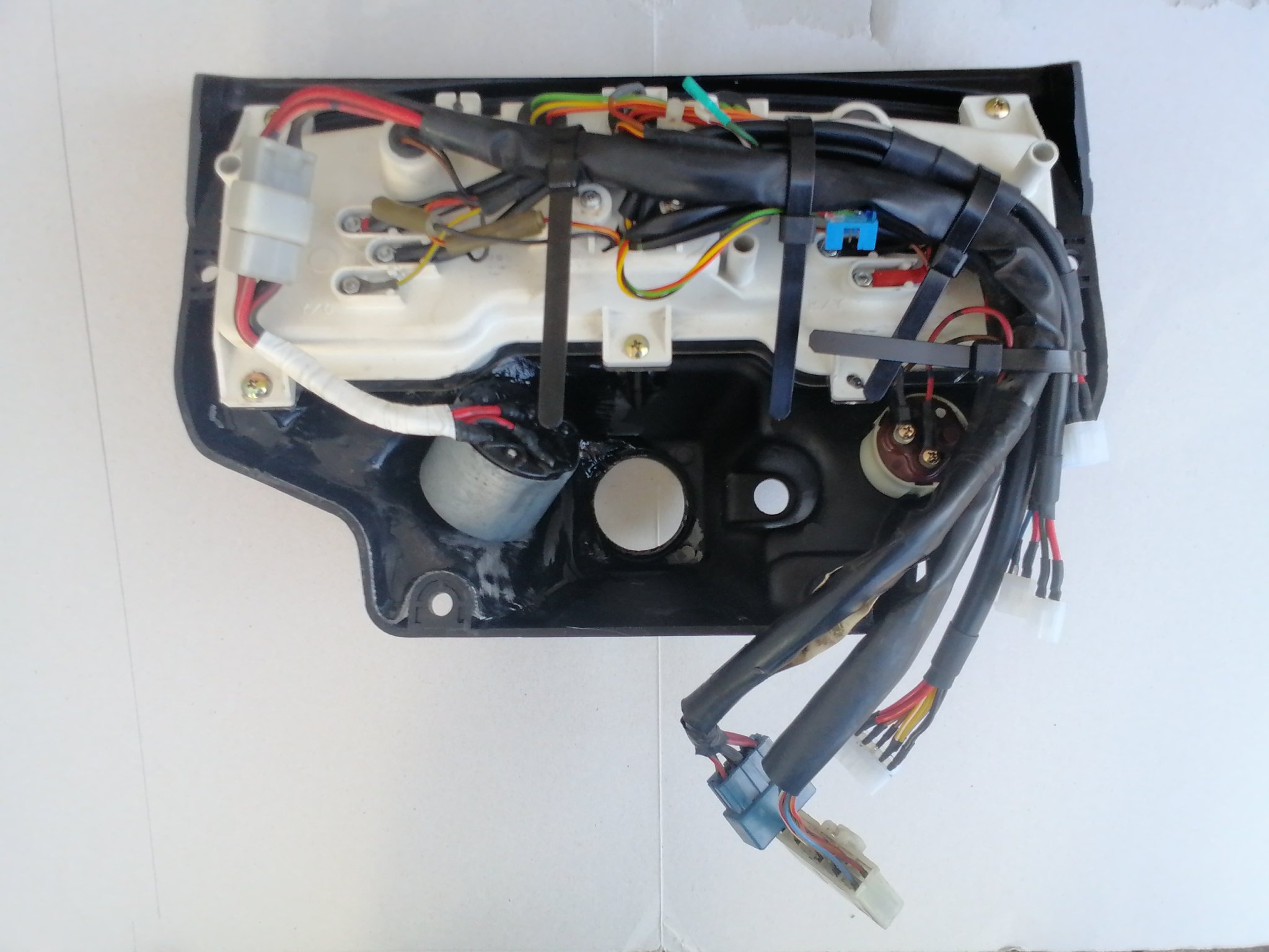

Finally finished the wiring for my modified instrument cluster and put it in the tractor. While I was at it I measured the glow plugs and found a faulty one, replaced it and white smoke after starting is gone now.
Starter did not always work reliably, thanks to the LEDs on my home brewed combination box the problem could be identified immediately as an intermittent contact on the glow position, a small software change and starter problem was gone (have to replace starter switch though).
Machine ran fine and I cut the grass. Instruments showed funny values sometimes, looks like a ground fault, have to check that. And having proper values on the instruments now I could see that the engine is running too cold, so will change thermostat tomorrow.
The G1900 looks a bit stupid now with the front axle done and the rear wheels rusty. Probably have to tackle the rear axle rather earlier than later :)

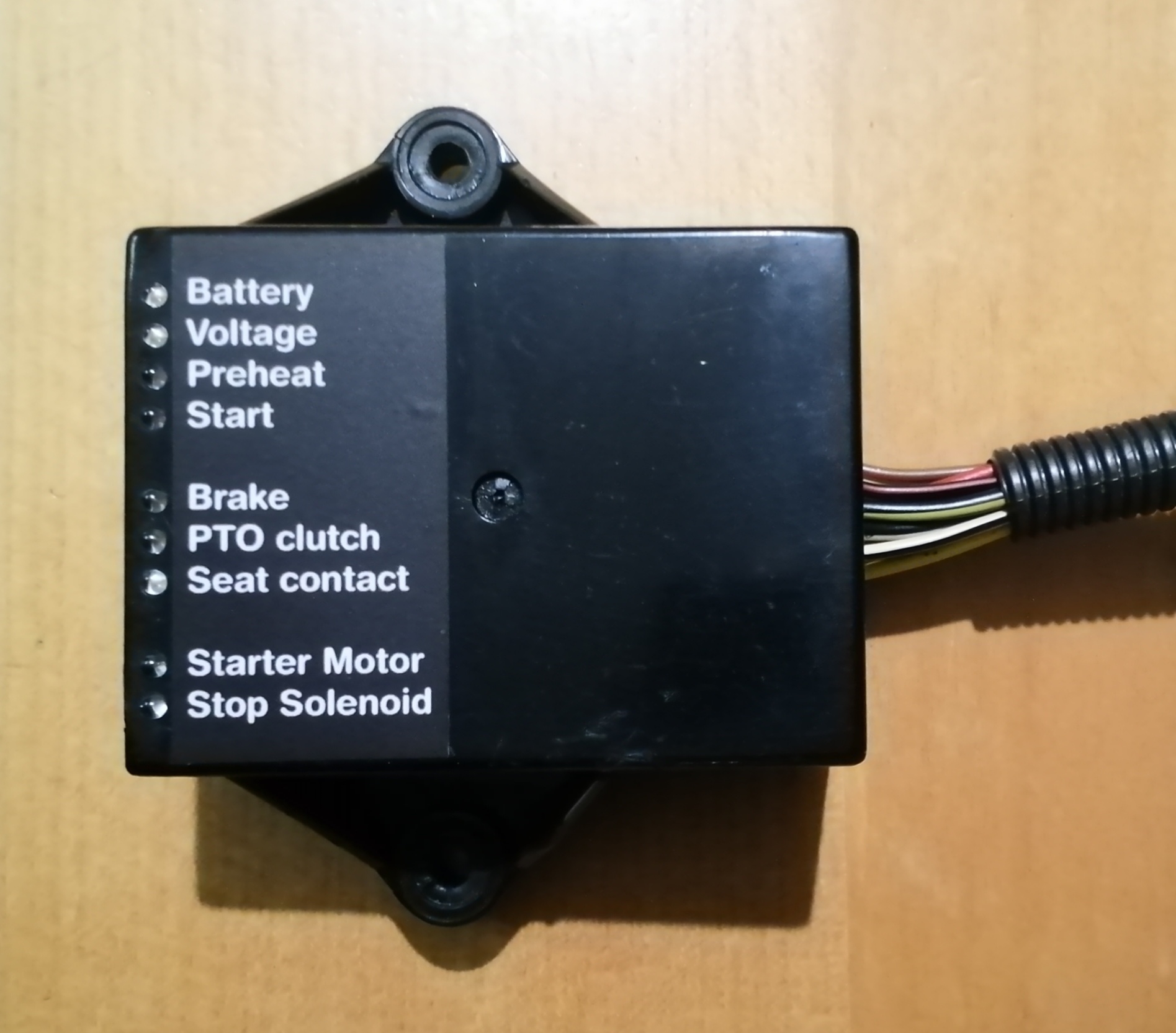

From your post it sounds like you built your own system controller also? (I may have missed reading about that?)
Not sure, Kubota calls this thing "combination box", the box doing the pre glow timer and the safety functions and the engine stop. Mine was faulty so I designed my own. I included the status LEDs, error blink codes in the dash board (with glow light) and an override start mode where you can start the engine despite safety switches not being where they should be. I described it here: G1900 combination box electronics
Below two pictures with the cable connected and electronics in the box, not potted yet, want to do further testing first.

Yours is phenomenal work, which makes me think Ho Li Chit.
You have mad skills.

@Hugo Habicht : What are you using to make those labels? The closest I've found capable of doing that is a NIIMBOT B21, though I haven't seen white on black labels that wide for that machine.
Maybe Brother TZE-355 or something by DYMO (3/4" max???)? Panduit and Brady don't have anything that wide that I'm aware of.

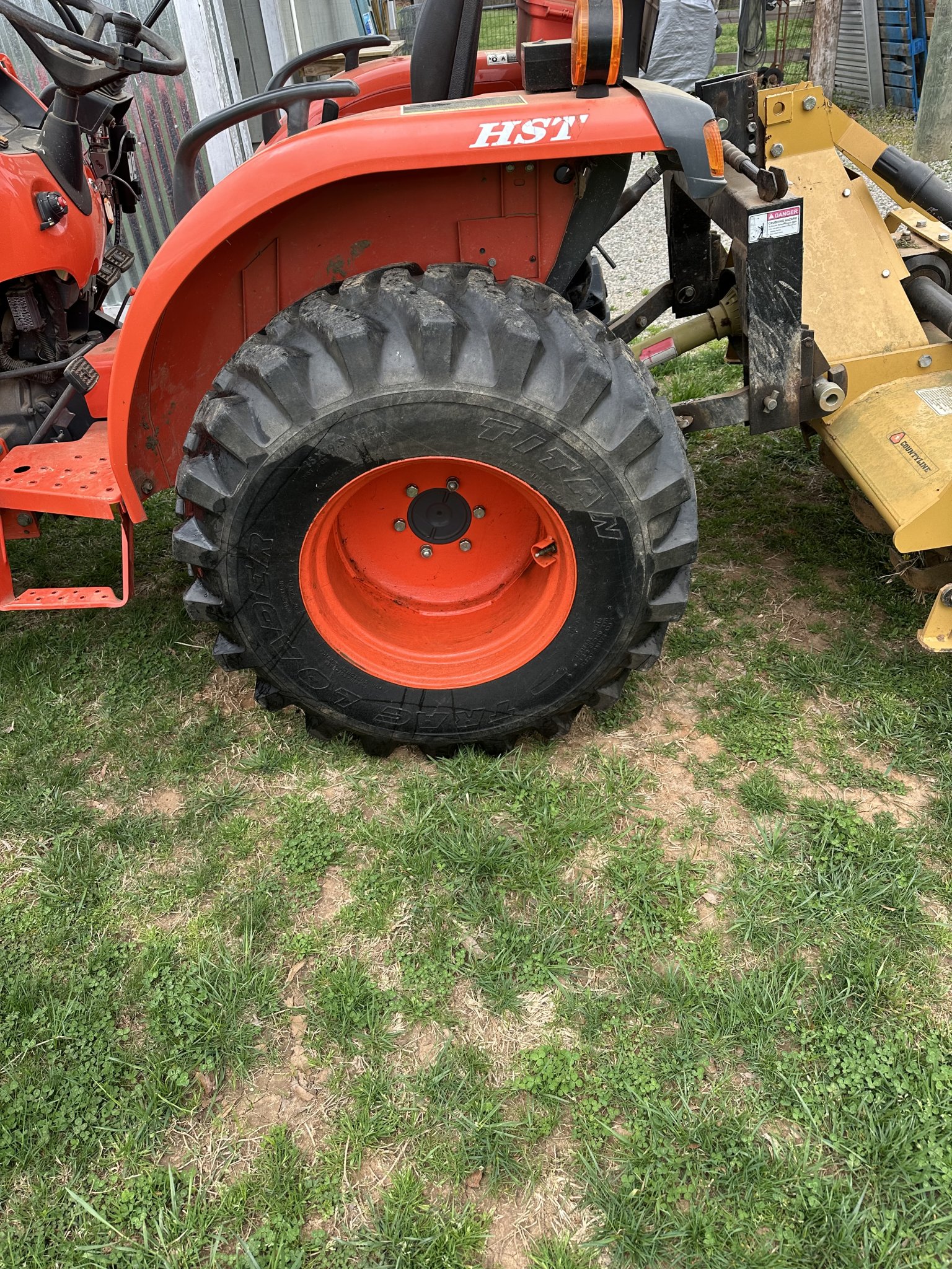

Checking tire pressures and general maintenance today. I found it interesting with the quick warmup we experienced today it was easy to see how much ballast was in my tires.

For the design I use Visio (Version 5, before Microsoft messed it up). For prototype stuff I use an old Minolta laser printer with laser printable self adhesive vinyl sheets. But those labels I got printed professionally by a company in Germany together with the overlay for the instruments. They print everything for you, any material, any size and at a very good price. Their web site is https://www.wir-machen-druck.de/ (I hope it is ok to post external links).
The material is actually white with black printed around it. They can also print white but the file generation is a nightmare, a friend working in publishing had to do that for me. I got white printed on clear foil for the dashboard lamps (like the original Kubota style) but decided for coloured symbols with black around in the end.

By profession I design electronics, mainly with embedded controllers, this makes it very easy to change functionality by changing software. But working on old Kubota tractors is way more fun :giggle:
