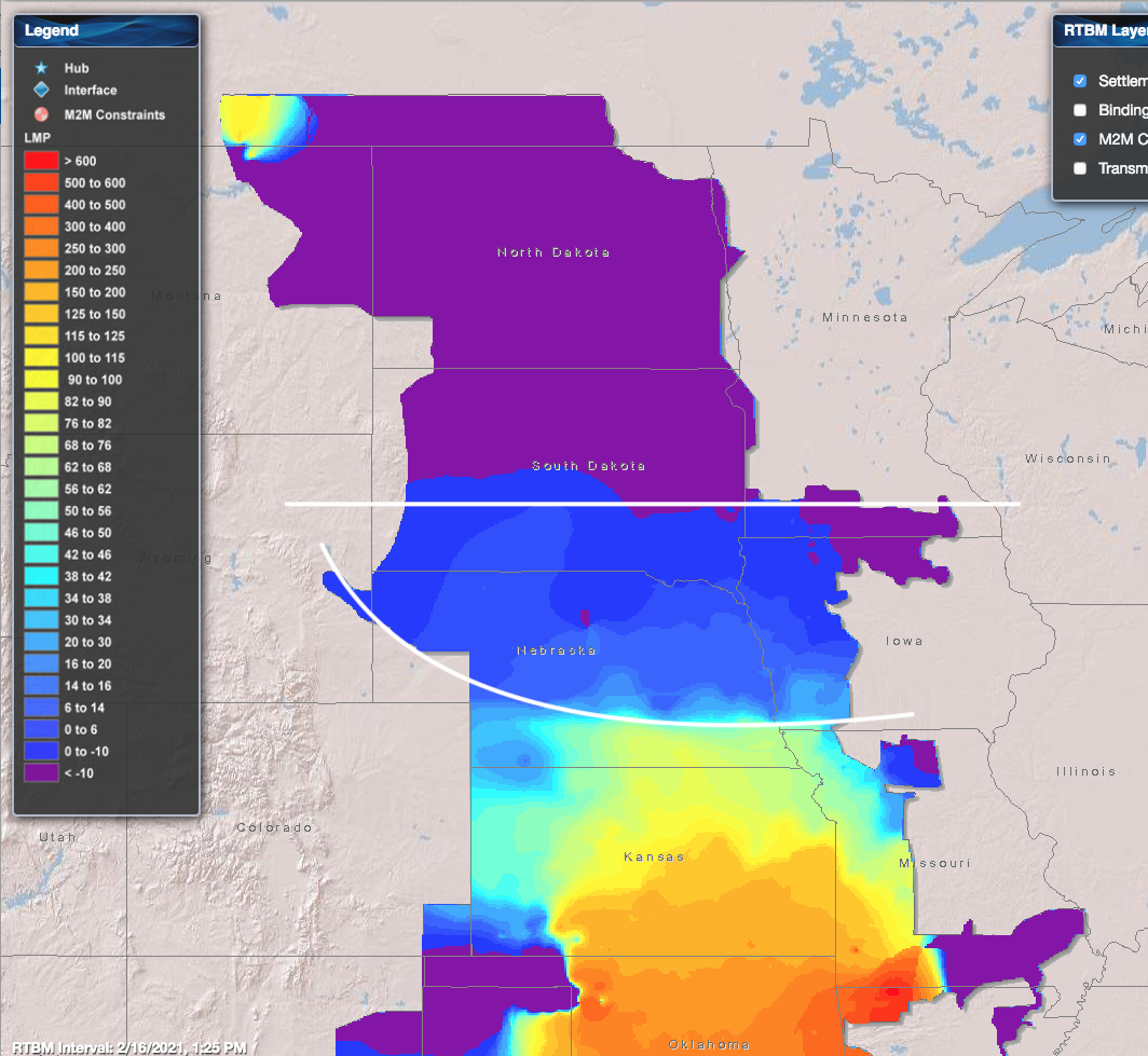

Those zones on that map in no way reflect actual physical boundaries of energy transmission. Those are just political/financial boundaries waiting for one gozillionaire to pay another for what they don't have enough of, whether temporarily or permanently. I know for a fact it's pretty simple matter of exporting power from Alabama all the way to west Texas. Southern Company makes a lot of money doing exactly that. Been there, done that.
Not exactly. There definitely are physical boundaries, since (most of) the lines shown represent places where the grids are (likely to be) running out of synch with each other and elaborate tie ins are required. Yes, energy moves across those lines, but much slower than it can move within the different areas.
In addition to that, there are bottlenecks due to the sale of electricity, called "market to market" or "M2M" constraints. Unfortunately, I took this screenshot before they finished loading, but I drew some white lines where the M2M constraints were in the figure below. Note that electricity in North Dakota and southern South Dakota is wholesaling for negative $10/ Megawatt hour. They were paying to have it dumped, yet down in Texas (which I didn't catch in the shot) it was selling for $600/MWhr. If they could have sent that juice from ND to TX the map wouldn't look like this. And, an hour later it did not.
You can see the current price contour map here:
http://pricecontourmap.spp.org/pricecontourmap/
and, today, it is mostly the same color but you can see the very few "interfaces" where juice can be sent across and how they form bottlenecks (to a lesser extent than crossing area boundaries, but very significant this past week)
I guess I have a different definition from "renewable" and "sustainable" from what MSM does. I'd prefer "RELIABLE" and "ALTERNATE" to be used to describe energy derived from non-conventional sources, with the emphasis on Reliable. I think this week proved neither solar nor wind is the correct selection in snowy/icy/windy conditions. I'm sure a lot of Texans are agreeing with me at the moment. I don't think we're quite ready to shut down all the fossil fuel plants yet. I'm more than happy to accept the use of solar and wind technology for peaking and supplementation, but neither is reliable enough to put human life on the line yet.
I’ll be the first to admit that I don’t know near enough, but I did spend 40+ yrs as a relay technician in the business. Those colored areas on that map are just as was stated: Operational Areas. It depends on what you call physical boundaries as to what those are. There are no walls, gates, etc., but there are service territories. They may operate differently where you are but I’d guess they’re similar to here in that the different electrical service providers have their own service territories; whether those territories are municipal or rural. And one service provider doesn’t overtly take over and extend their services into another provider's area without some formal agreement. And that does happen when it’s more convenient/cost effective and an elaborate metering scheme is put in place to keep track of the power flow to meet the terms of the agreement. Other than that, just about all power flow from one area to/from another is done through those high voltage transmission lines between those large interconnect substations. And when they involve more than two parties the metering schemes can become quite elaborate and tricky.
As BobInSD also stated and I completely agree, it’s complicated to ship large quantities of power quickly from one area to the other over large distances depending on the circumstances.
It no longer is just about pure watts (power) being shipped but involves voltage, vars, qhours, phase angles, and whether they’re positive or negative, etc.…..all of which are needed to get that power to flow in the right direction to where it’s needed. Thus, those operational agencies to facilitate that. There can be times when the VARs (pretty much useless power) are just as important as Watts in order to control voltage on the lines and the directional flow. And a minor mistake in the setup of those elaborate metering schemes can amount to a pile of money and hard feelings when discovered later and a resolution is negotiated between the parties involved.
I asked of and one of our retired system operators said he believes one of the very few if not only outside ties to the electrical grid that Ercot has is a HVDC (high voltage direct current) tie line across the border to Mexico, which concurs with what Russel King said in post 58 earlier. He also said that every year that they were sent for additional training a whole day/segment was spent on both the ERCOT and California systems which were used as examples of impending disaster should the right conditions come together to cause system failure with little to no means of outside help. Maybe Southern Company was able to sell power to Texas through Mexico. Or it could be that it was shipped to the part of Texas that isn’t within the Ercot grid. It would be interesting to know the actual details.
I like your description that you use of the two basic types of power. When people ask me my thoughts I respond similarly. But instead of the term “reliable” that you use for the conventional generation I like to use the term “Essential” for the base load capabilities of those fossil fuel, hydro, or nuclear facilities. People will soon (if not now) have to decide where that line between “essential” and “alternate” energy should lay and what the actual costs of each can amount to. What’s happened in Texas illustrates what can happen when there’s too much of one and not enough of the other without the proper safeguards, backups, management, planning, storage, etc. put in place. Government subsidies for the green energy make it seem reasonably priced and have led to much advancement in the industry. But its growth has sort of overshot its reliability when it's depended upon for supplying base load power without the means to temporarily store its green energy. The lack of new "essential" base load generation because of the growth of green energy and the cost of EPA restrictions has now shown what can happen when that green energy is relied upon for constant power to supply those base load needs and #%%!! happens.

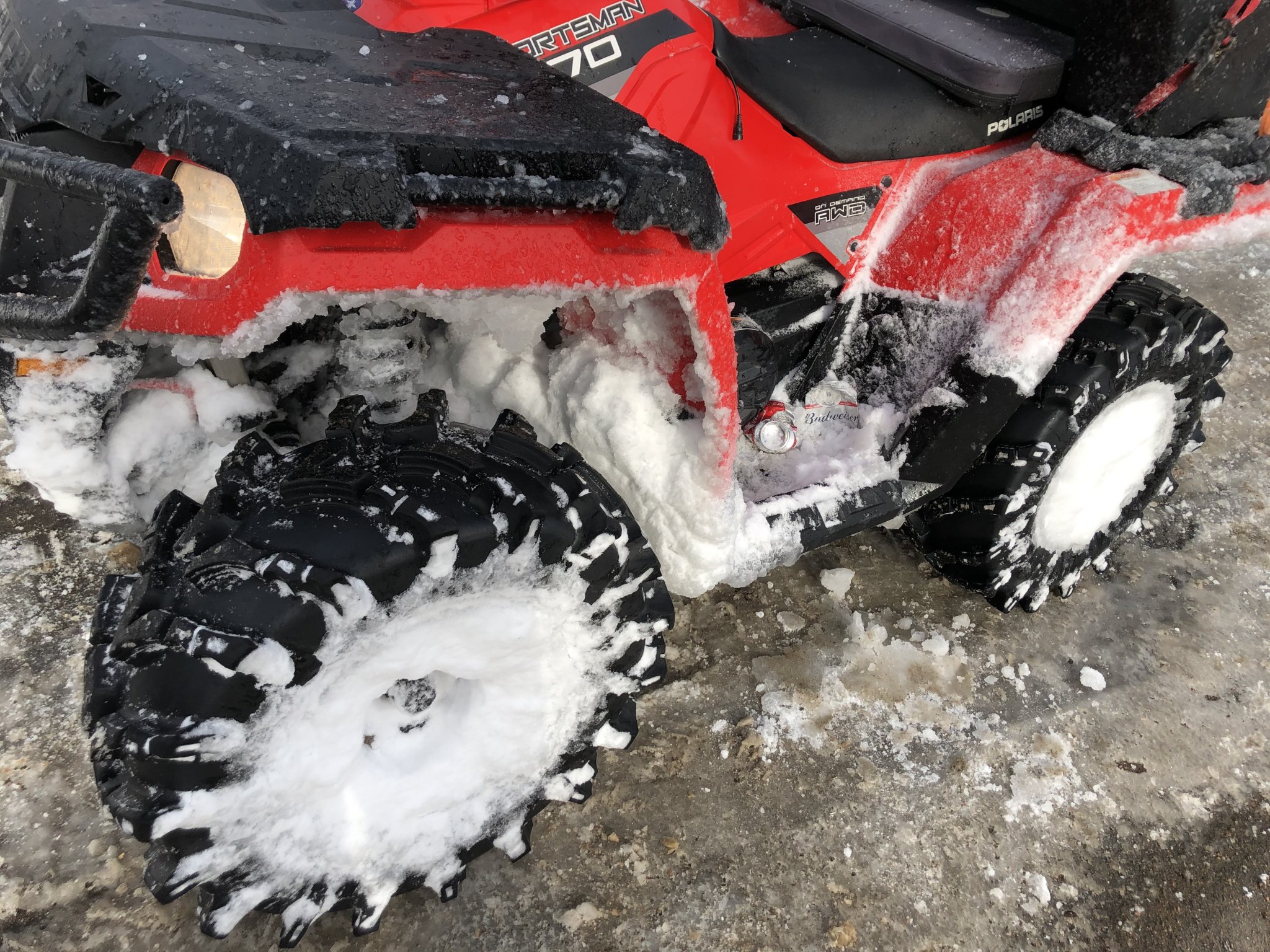

Cold day is right. But always a good time on the hard water. Yesterday was hard on the machines. There was 18” of ice with 12” of slush with almost another 12“ of snow on top. Warmed up to -4 c so it wasn’t too bad. E3FDC4C5-A5EB-4E86-AD77-739840DA9CC0.jpeg
that’s all solid ice. Thinking im done with the ice fishing this season.
