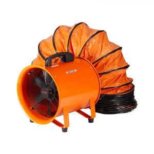

Hugo, one of those squirrel cage blowers would be helpful in your situation also, to push the nasty stuff out under a garage door... I've seen portable ones, about 12", with a plastic housing and a handle on top to move them. They move a LOT of air.
Are you talking about a carpet dryer? I use one to ventilate my basement. Push the air out one of the foundation vents. Works great.
Once in a while there's a good deal on the furnace blower on Craigslist. Usually 3 speed, and they move a ton of air.

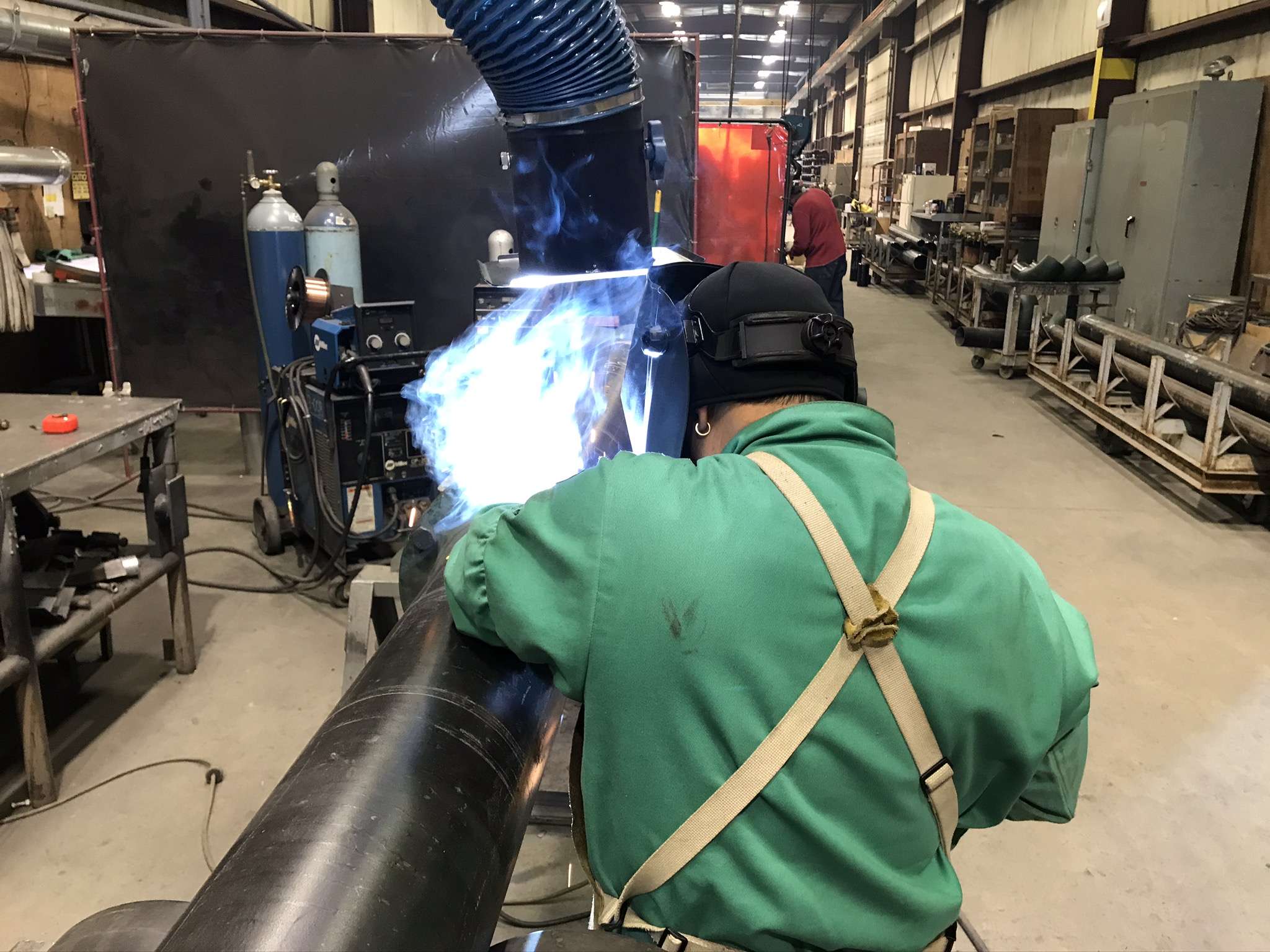

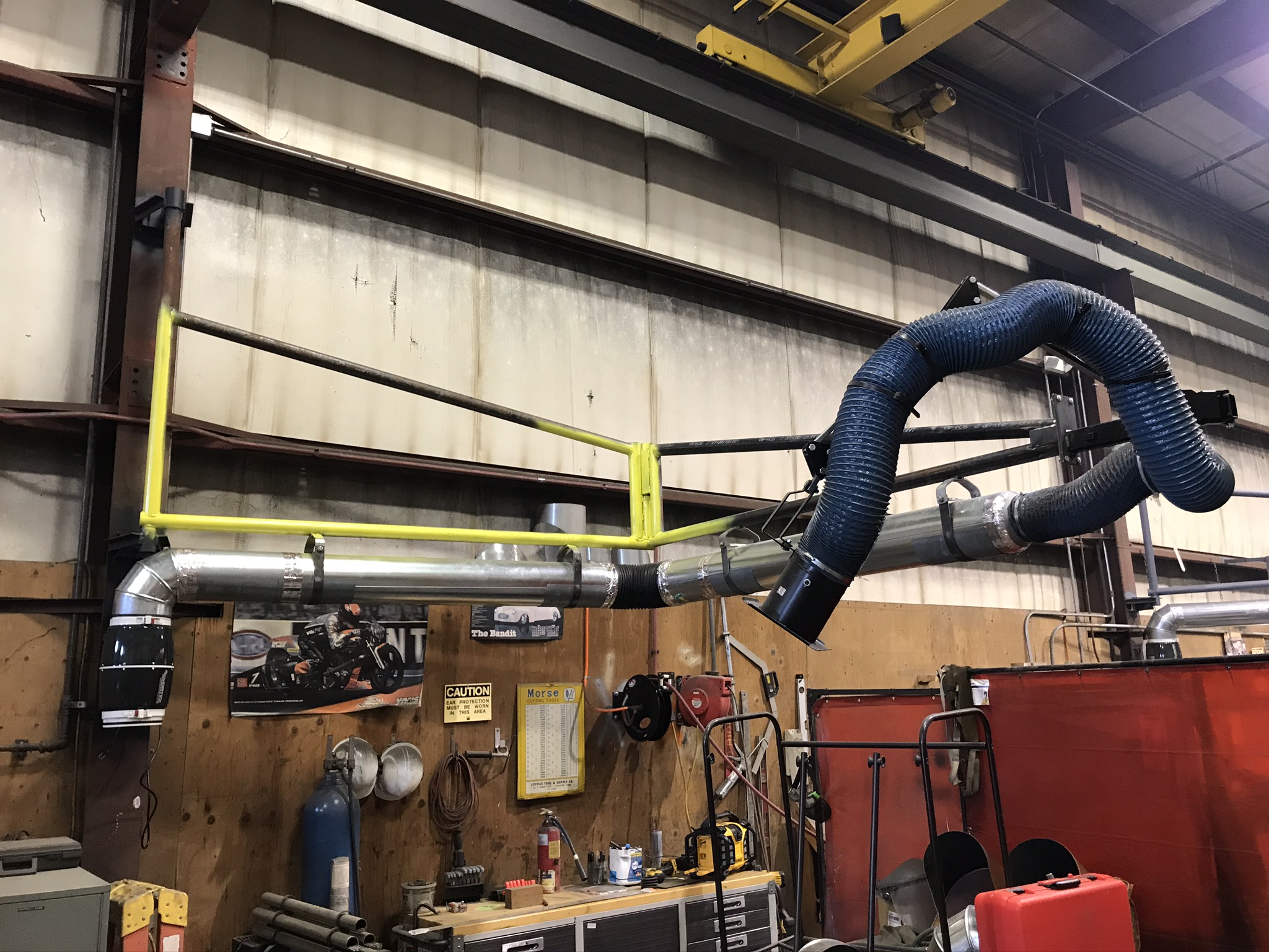

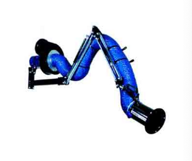

If your welding is mostly done in a given area it wouldn't be too hard to rig something like we did at work, on a smaller scale. I bought a few of these "Monkey Arms". For our application we needed to cover fairly large areas. Each of our guys had a large table for some work and an area near the table for welding larger things and using pipe rotators. I used inline fans that we mounted to building steel and fabbed larger swing frames from pipe. The one picture below shows the setup (prior to running the discharge out through the wall). We had large exhaust fans that were OK in warmer weather but sucked too much warm air in Winter.
Being a hoarder of things that may some day be useful, I have a couple gas furnace draft inducers with 2"-ish connections that could work for such a thing.
Monkey:
I literally just bought one of these last week to exhaust mig welding fumes and smoke from the shop.
Works well with the end of the hose out the doggie door flap.
