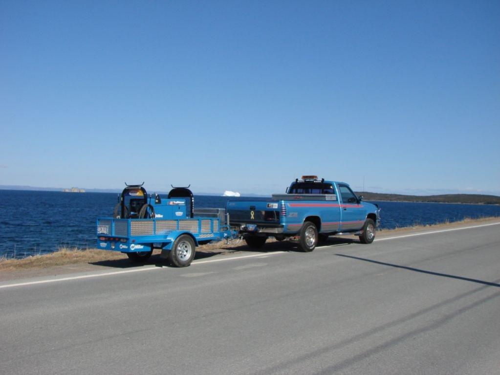

Wildfire
I've always said that the greatest compliment I have ever received is when people post saying I've inspired them so that you very much for that.
You gotten some great advice here. Just make sure you get yourself a 220 volt unit. I'm partial to Miller. Their gear has never let me down. I'm not a welder by trade although you'd never say by the amount of welding work that comes in our shop but that's the same as machining and fabricating.
You can't go wrong with wanting to learn. You'll greatly benefit learning welding and when you do learn the basics keep practicing and you'll see an improvement each day.
Here's my mobile unit. Look closely at what's between the trailer and truck ;)
