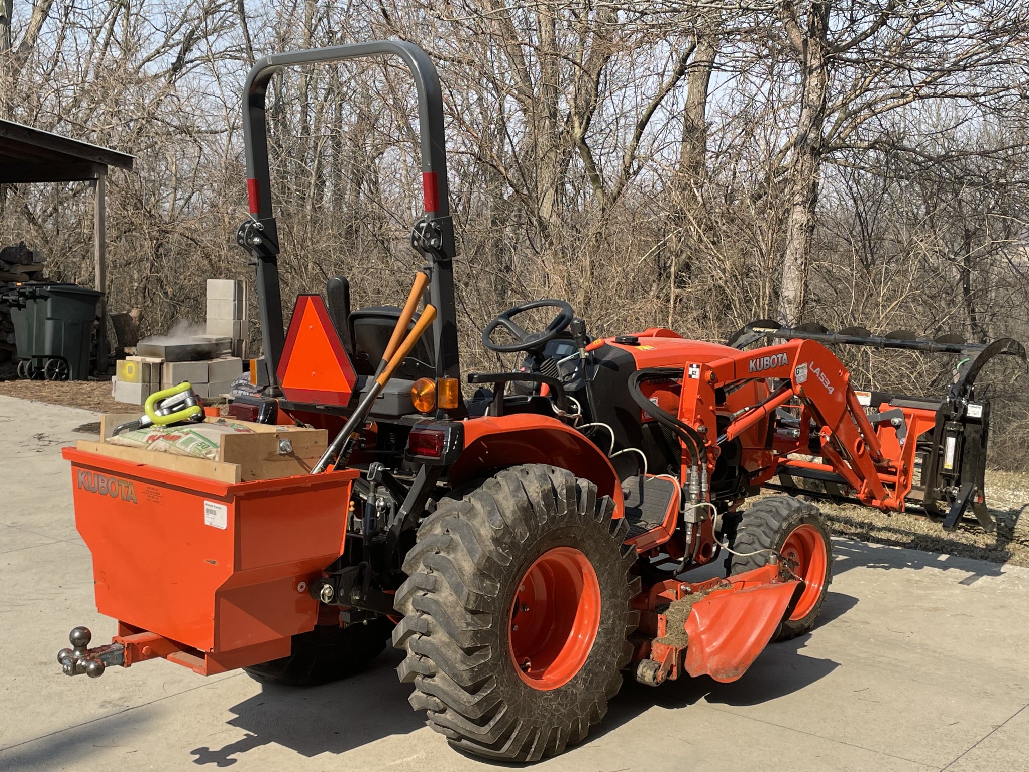

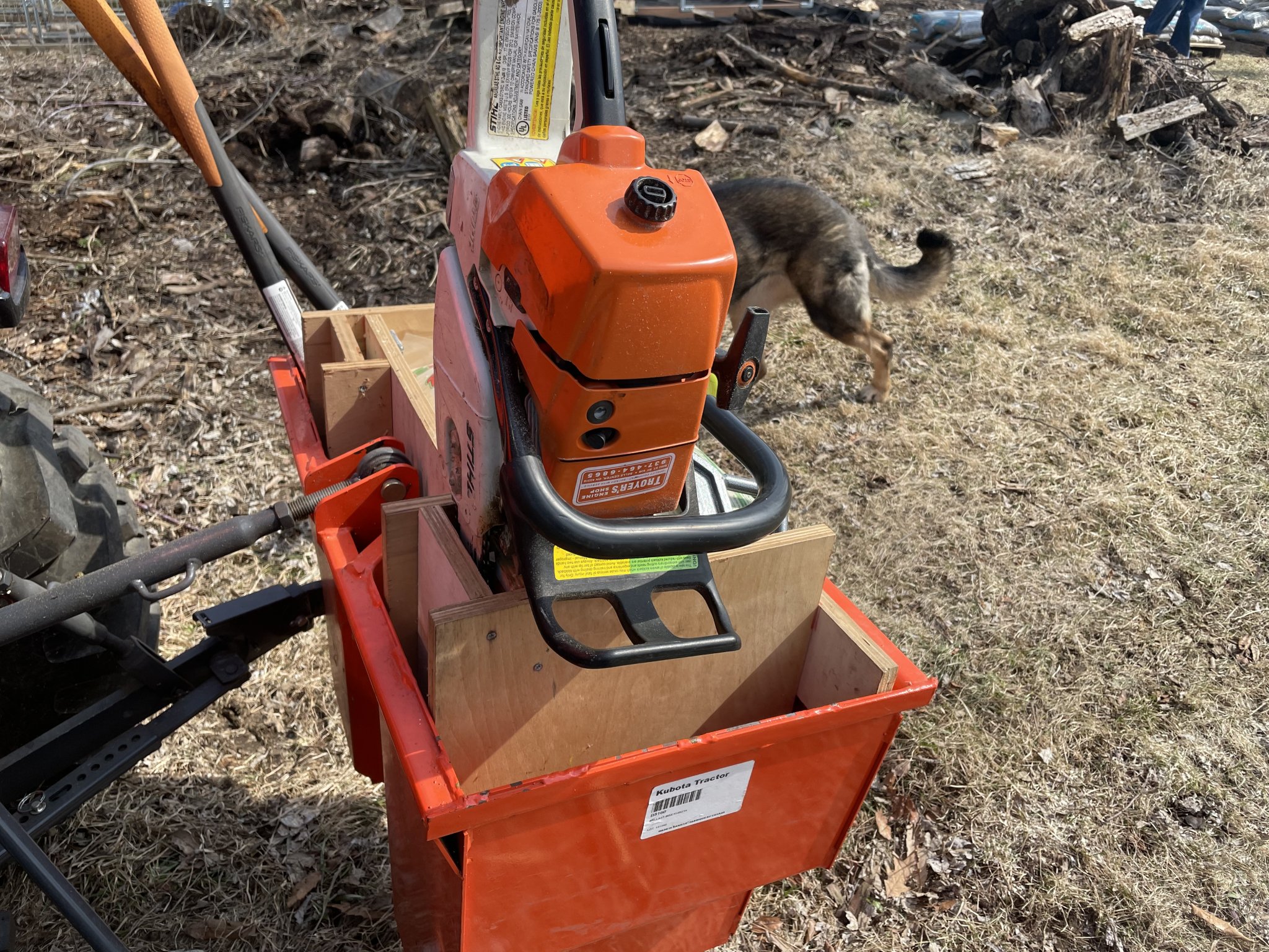

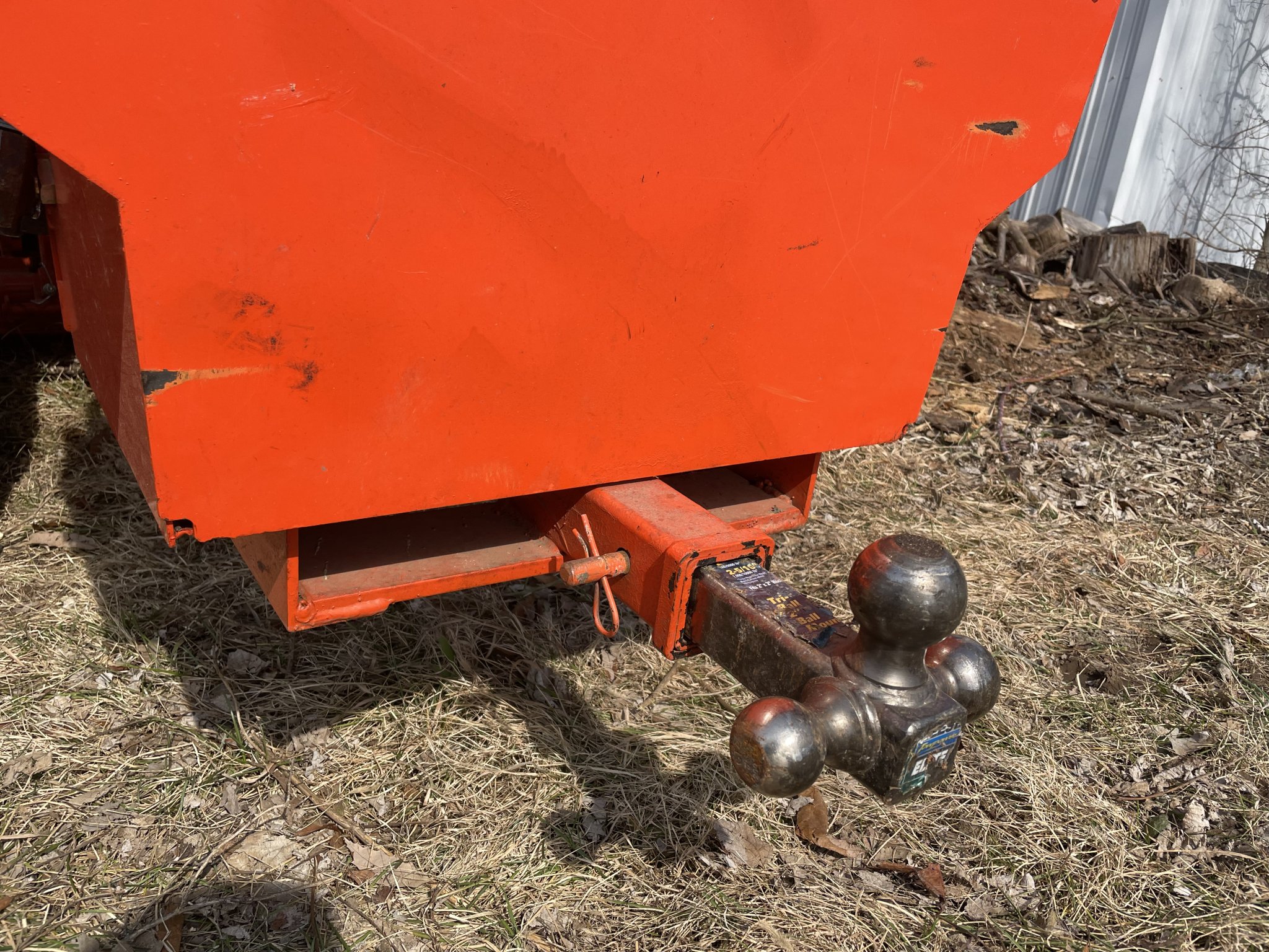

I know, I know, I'm a cheapie....Found a new-condition Kubota ballast box on FB Marketplace, used big rocks from the yard to fill it. Mine is the older style, apparently doesn't work with a QH. I just have to remember to pick it up before I try to drive away! :rolleyes:
GrumpyFarmer
3,233
4,487
I had one of the odd shapes that did not work with QH…actually I sold it when I added Pat’s and it did not work with Pat’s. There should be a pics if you look through the ballast box threads(there really good ideas in the older threads that some have done…much better than what I did on the cheap with reclaimed materials, but its functional for my uses). I put cheap inner framework in it which held the sand in the center then left the ‘ears’ as storage trays and I had a lid to keep water out…I added a hitch too. Good luck and share some picks back what you do with it.
Here’s old model and new…
