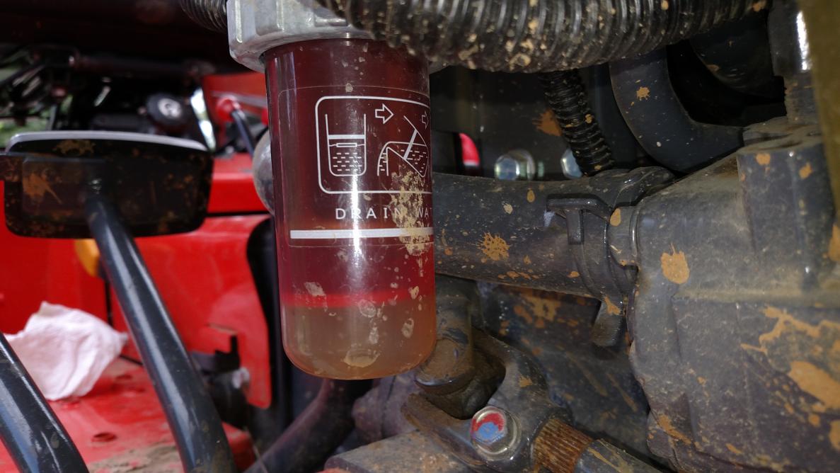

I'm here with a question regarding my brand new L2501's fuel filter. Like many new tractor owners im sure, I spent a lot of time watching youtube videos and reading stuff online in my pre purchase research. On numerous occasions I came across pictures and videos regarding the Fuel water Separator on the L series. It has a little floater inside the small resevoir, and a line on the outside - when the floater reaches the line you were supposed to empty the reservoir. You guys know all this. My question though is regards to the fact that I guess in the last couple of years Kubota changed this on the L series, as mine does not have this same system with a floater, shut off valve, etc, and only has a similar sized little reservoir with the little fuel filter inside. The owners manual also mentions nothing about "water separator" when reading about the fuel filter. Owners manuals of slightly older L series does mention the water separator and its usage, so it clearly is a change. Im just curious as to why kubota done this, and what the idea was behind it? I would think a fuel water separator would be a good thing. I guess the new little fuel filter setup to me just looks inferior to the old one of I guess a few years ago. Just looking for some thoughts on this. Ive tried to research why this change was made and stuff but just haven't come up with much.

For some picture references, this is the older set up with the shut off valve, floater, etc that I feel looks like a better setup:
another pic of same thing:
And here is what the new/current fuel filter looks like, with no shut off valve, no floater, no markings, just a lot of plastic and the tiny filter:

Well in the course of making the post and pulling up some stuff on this topic again I MAY have answered my own question but not sure.... It looks like the water seperator as I showed in pics 1 and 2 above are still present on the L3301 and L3901, leading me to conclude that perhaps the L2501 has NEVER had this water separator and I am mistaken. Is the water separator exclusive to the 3301 and 3901 perhaps? I was thinking I had seen it on the L2501 but must have been mistaken?
Yes, Because the L3301 and L3901 are common rail high pressure systems, where the L2501 is the old mechanical injection system, and it's super important that little or no water gets to the high pressure pump.
Ah ok, well that answers it then. I guess I wont worry about it then. While on the subject of fuel filters, does anyone have any input on this product:
