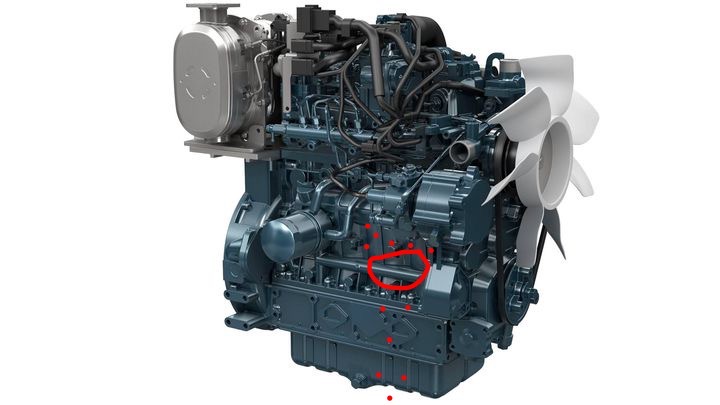

So I’ve checked the water line hoses for the oil cooler and all the water pump hoses . I’ve also pulled the water pump and changed the seal on the back side. I’m still getting coolant dripping in these areas . See picture . I don’t see any leaks from the head. Help

Sorry you've had no progress. Answering the 4 questions above would help me, maybe others. No. 4 is asking for a photo of the leak, not roughly where it is on a new engine. So does that mean that you don't know where the fluid is actually emerging from? Until you discover that, I don't think I can be of any futher. Good luck, I hope others can help you.

Up on the front of the head there is a freeze plug that could be leaking
It could be a freeze plug in the block.
It could be the thermostat housing.
It could be the water pump itself, look under the bottom of the center section to see if there is a leak at the weep hole.
