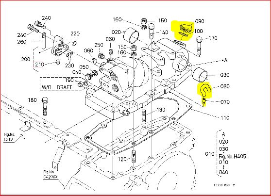

It may be getting in around the shifter boot, or the vent for the transmission on the fill cap. If it sits outside a lot, that's usually the cause

It could get some water in the vent on the top of the 3 point and maybe if the cap was left off.
I would suggest you drain all the hydraulic fluid and see how much water really is in there.
