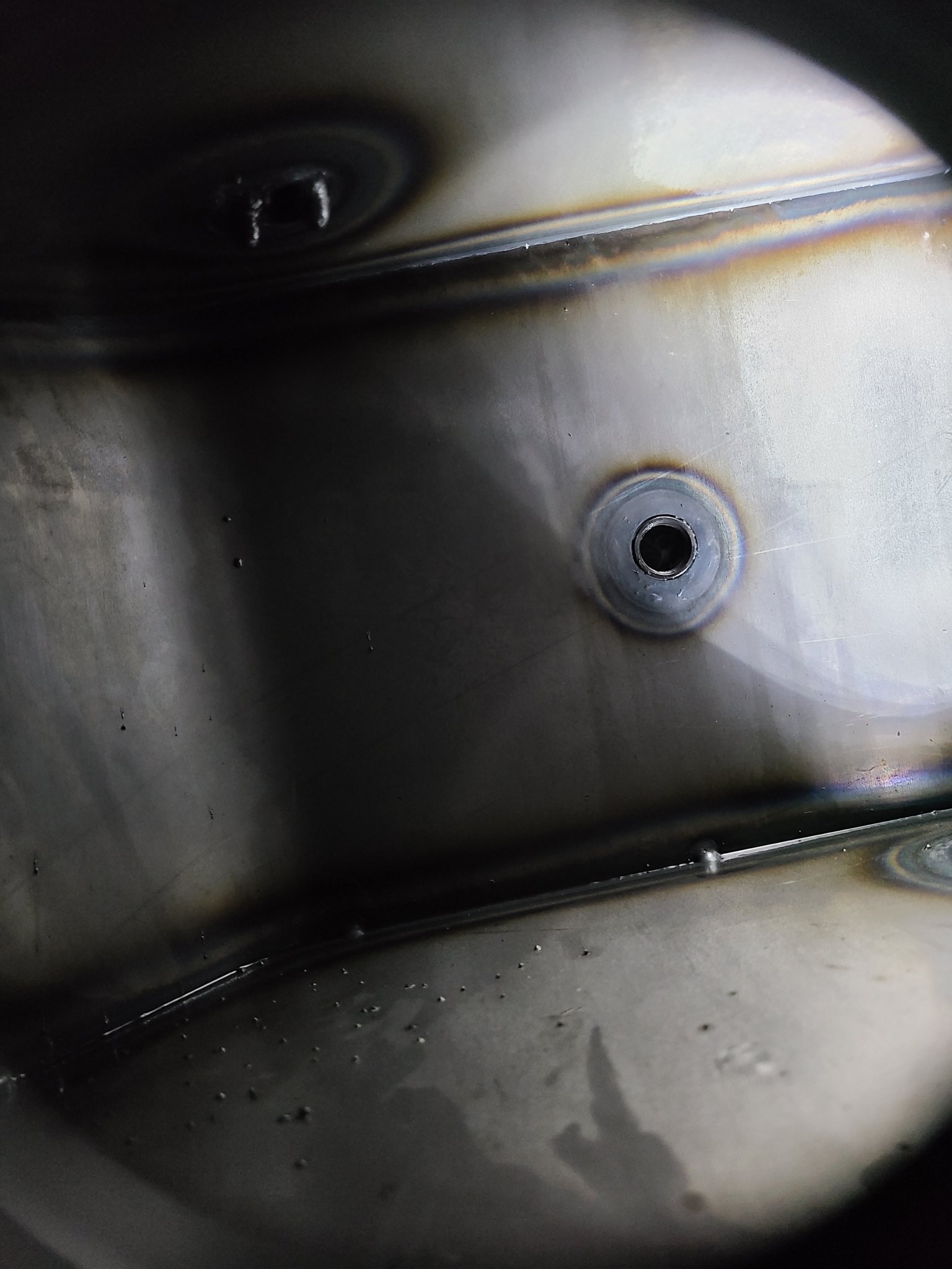

This is the inside of the tank after I cleaned it out. I didn't use anything special, just some brake clean in a spray can. The interesting thing is the weld spatter in the tank.

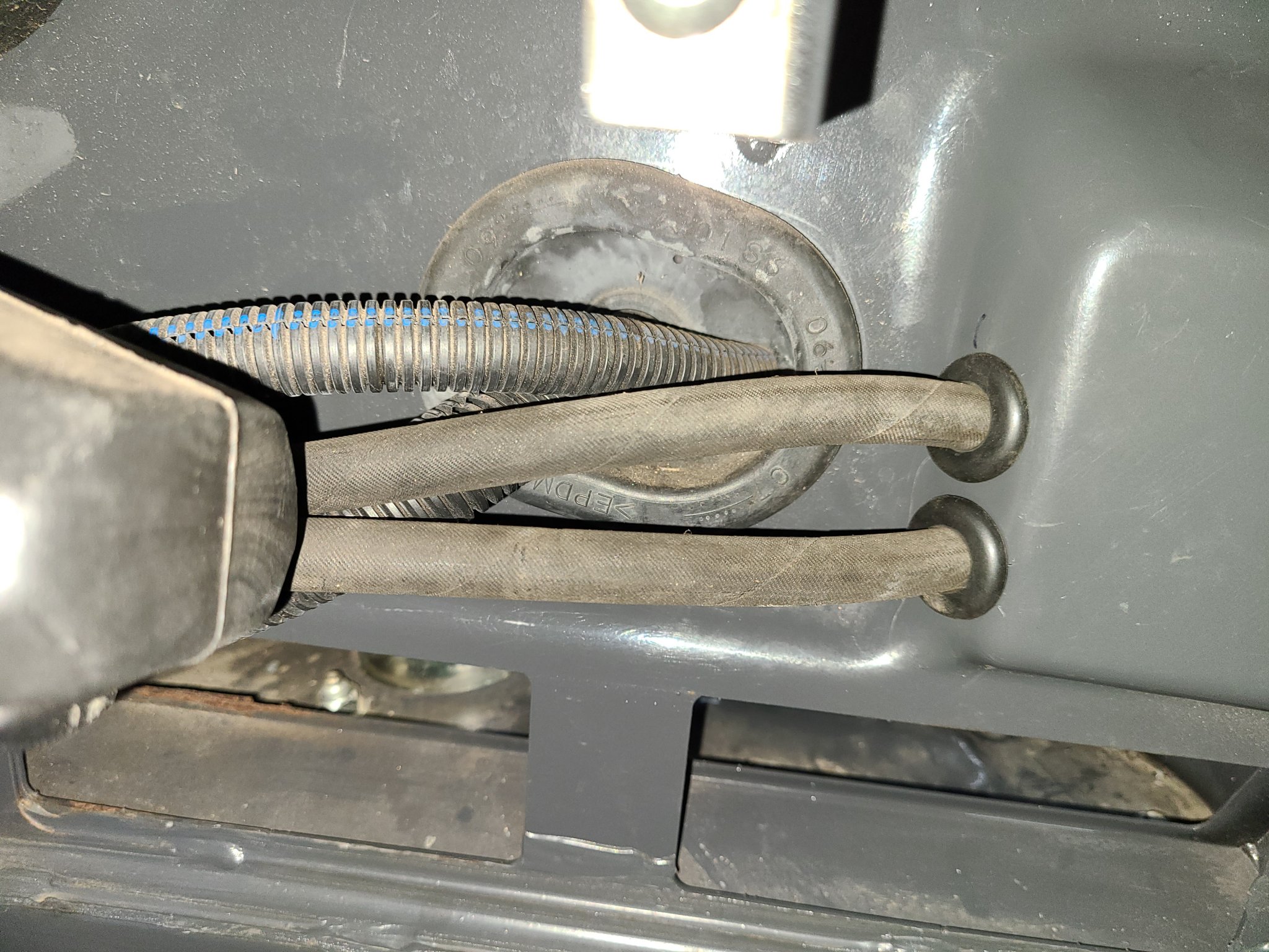

This is a pic of the plow hydraulic lines that I rerouted that were originally run through the vent (the square holes right below the two lines). I had drilled the firewall and added some grommets. Rerouting the hoses will make the vent functioning again but because of the number of years that the lines were in place the rubber flap was ruined and the flap had to be replaced. That is why the hole is open at the moment the pic was taken and you can see thorough the firewall. My guess is that the install was completed by the selling dealership and they took the easy way out.
