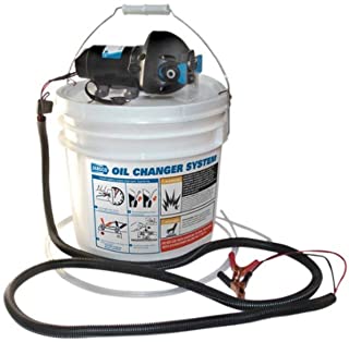

Have you considered using a boat oil sucker bucket to remove the hot oil from the crankcase via the oil dipstick? You pump out the hot oil, and then wait till the engine is cold to remove the oil filter. Saves you a lot of time since you don't have to go under the machine to get to the drain plug. Many of the high end cars, such as Mercedes, etc. no longer have drain plugs, and this is how they remove the oil by sucking it out hot. The first time that I did it with my Explorer, I pulled the drain plug and barely got a tablespoon of oil out of the oil pan. Been doing it this way successfully for at least 15 years. Sure beats burning your hands and arms with hot oil.
Jabsco 17850-1012 DIY Engine Oil Change System, 3.5 Gallon Capacity, 12 Volt , Black
yes I use a version of that at work, daily, many times a day. Time saver! And much cleaner, a lot fewer dirty rags that have to be disposed of. That evacuator has made me more money than any other tool I own, period.
I made my own out of an old air tank and a pneumatic vacuum pump venturi but it can be electric or manual operated pump too, it doesn't matter as long as the tank has less than atmospheric pressure so it can "suck" oil out. Mityvac makes a couple different ones; actually that's where mine originally came from, I broke it and robbed the venturi off of it to make my own. Mine pumps in (sucks) and pumps out via air hose.
