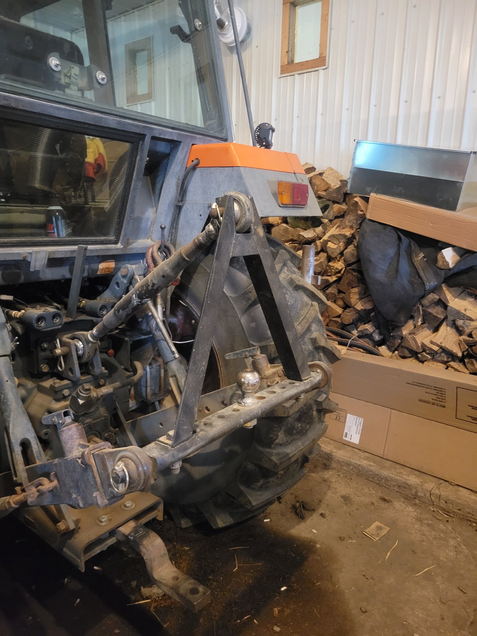

I don't use my drawbar and leave it off the tractor. It limits my turning ability because the attachment point is inside the tires. I use a 3pt 2" receiver on a 3pt quick hitch. This keeps the attachment point out past the tires so I can make 90 degree turns if I need to. I have various ball mounts and even use one without a ball for pin attached implements. I even use it with one mount I made with a ripper for pulling roots and digging trenches.
i am brand new to OTT, first post. I have never pulled anything with my L3901, but have a light trailer I use around my property I usually use my 4 wheeler to pull it. I have a new MX6000 Cab coming next week and have been wondering about pulling my trailer. Old Machinist do you have a picture of your setup?

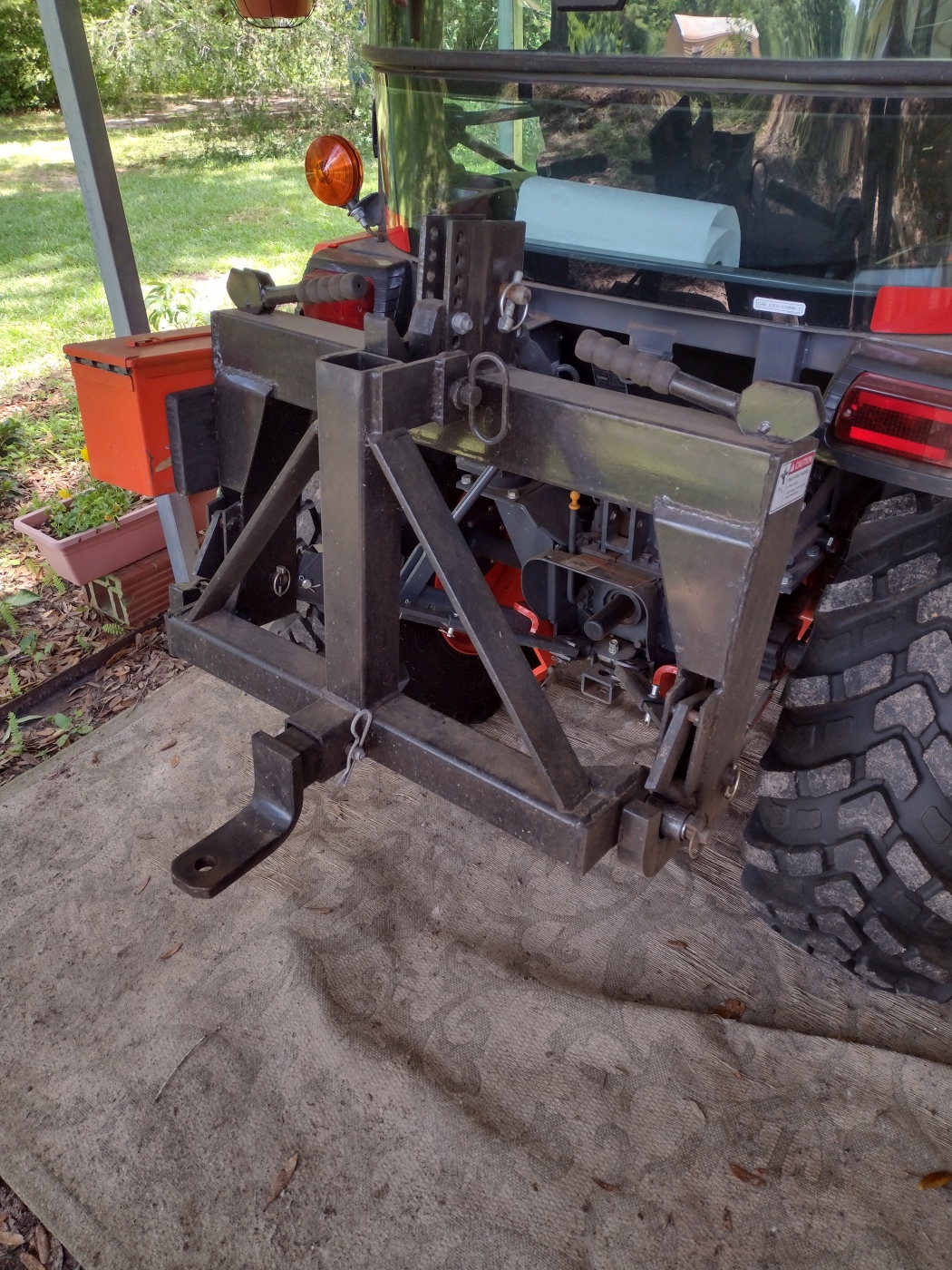

I only use mine for pulling an offset Swisher mower and sometimes a seed spreader. I also have a 2 inch bar with a single ripper I can use in it.
I wouldn't hesitate to pull either of my trailers with it. I can't imagine them having a damaging lift effect stopping at tractor speeds.
You can find 3 point 2" receiver trailer hitches pretty reasonable. Make sure and get one that has the pin connections tabbed forward for quick hitch compatibility. I had to weld on gussets to the bottom pin tabs on this one and the top link had the wrong size hole so I welded plates over it with the correct size hole.
Thanks! Very nice!
