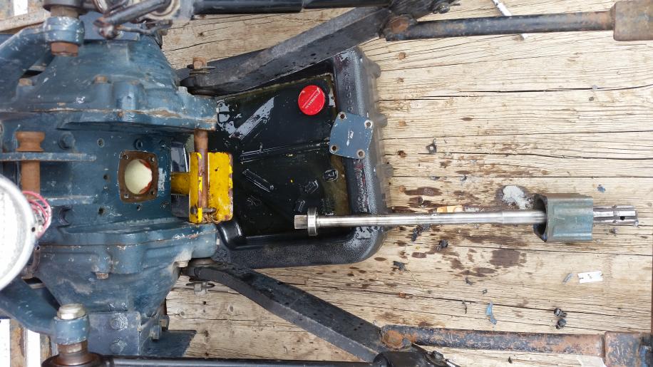

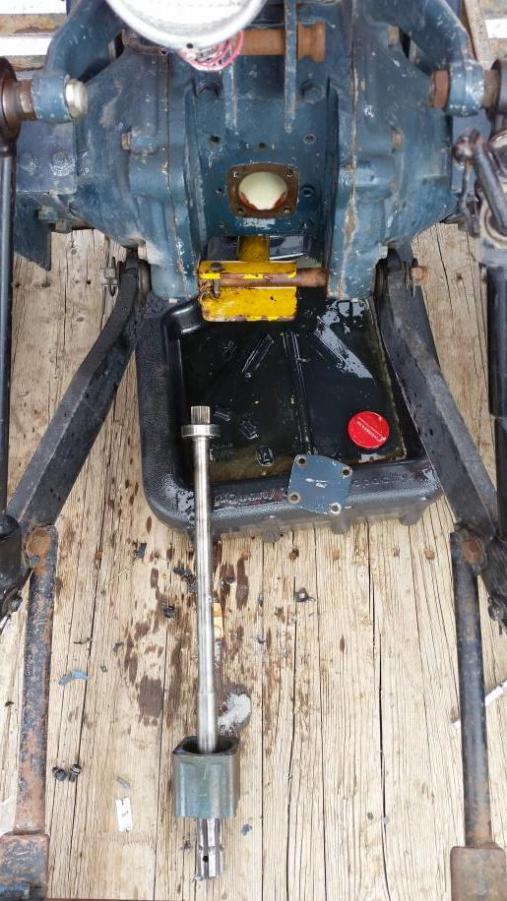

Hey everyone i just got my first tractor, kubota l175. It looks like it was a super base model? No PTO, or hydraulics. So im looking to add them as the tractor i bought is extremely clean. So my question i guess is what parts do i need to get to upgrade it. And how do i go about installing it?
The guy i bought it from had bought the pto output shaft but i feel that there are some other internal parts missing, i went to install it this afternoon but it wouldn't slide into the housing, and the pto range selector doesn't feel like it is attached to anything inside.

Apparently you have the wrong PTO output shaft.
I don't use the PTO on my L175, so I can't tell you about how it should feel, but without a shaft it seems like you wouldn't feel any resistance.

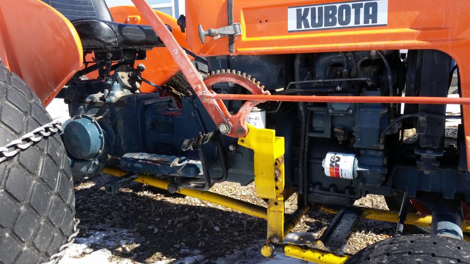

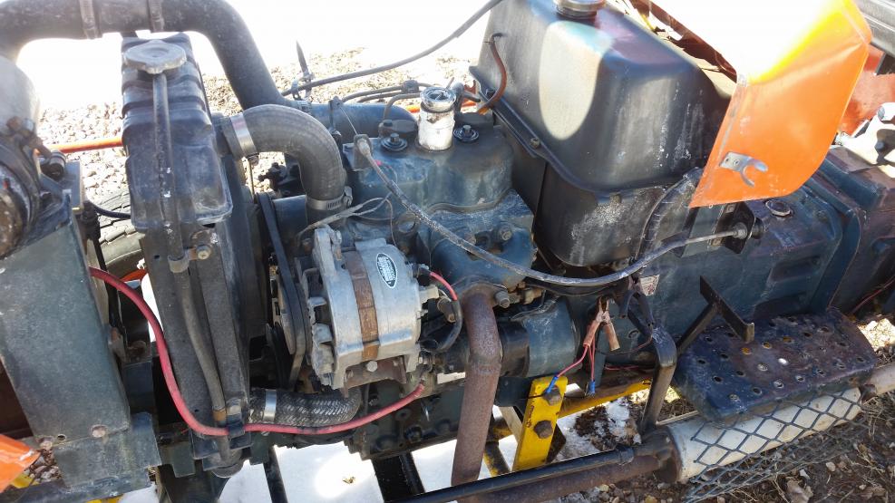

WOW it appears that someone has gutted that tractor, I'm not seeing any of what should be on it.
The PTO and Hydraulics were stock, not optional add ons.
I don't see any hydraulic lines.
Post a picture of the right side of the engine.
Infact post as many angles as you can of it.

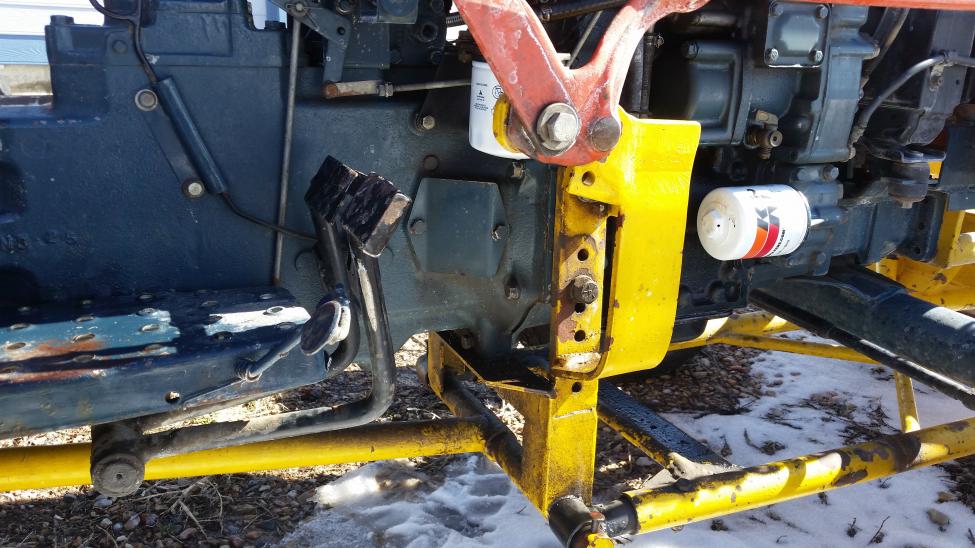

33,278
8,634
Sadly you're missing some serious key parts.
Hydraulic pump
Hydraulic pump gear drive
Hydraulic piping.
Looks like the PTO shifter has been cut off too. :eek:
Just to name a few issues.
Still trying to figure out why someone messed with the oil filler cap, PVC pipe fitting is really odd!
Those parts are not going to be cheap or easy to get in their entirety, there are a lot of little parts that you will need.
