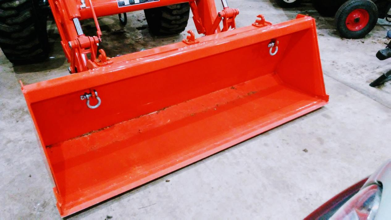

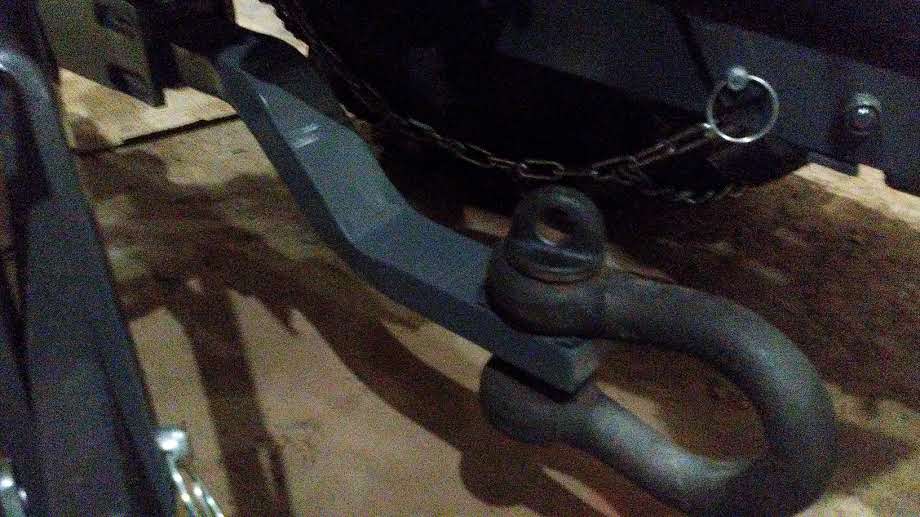

Was going to weld hooks to bucket but liked the idea of bolt on. I thought the clevis in the bucket would be useful when I saw it on here.

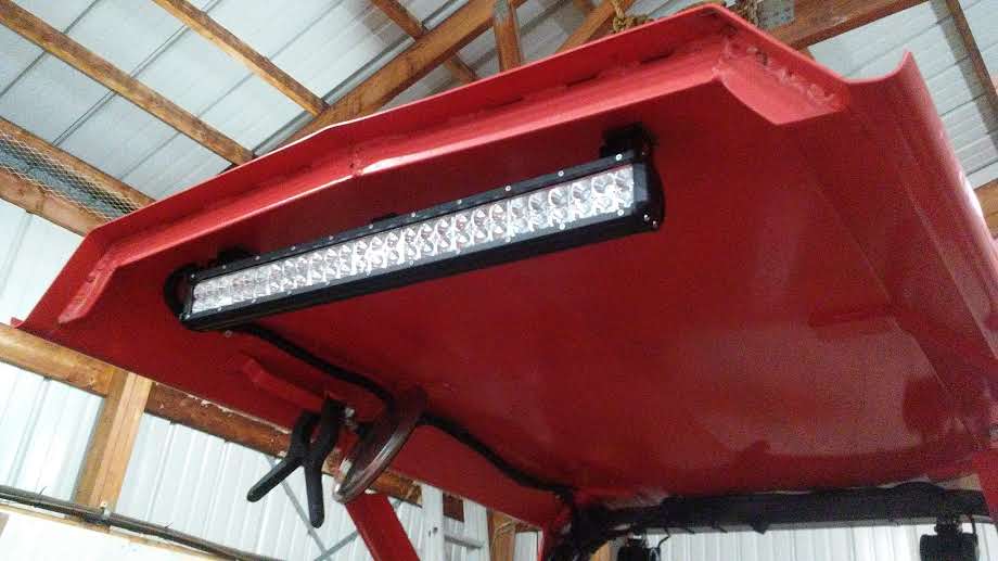

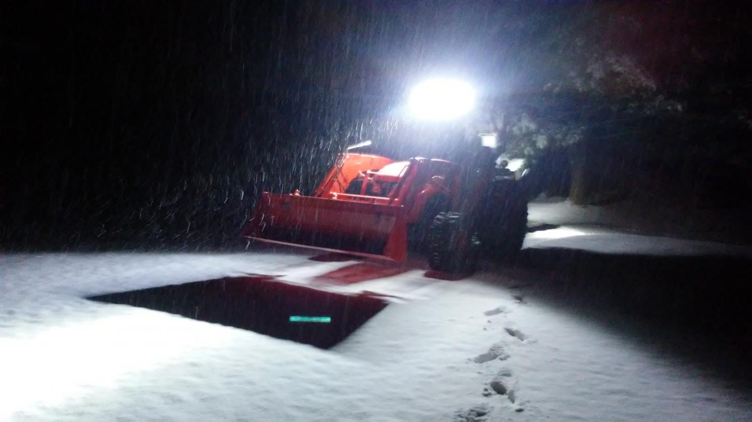

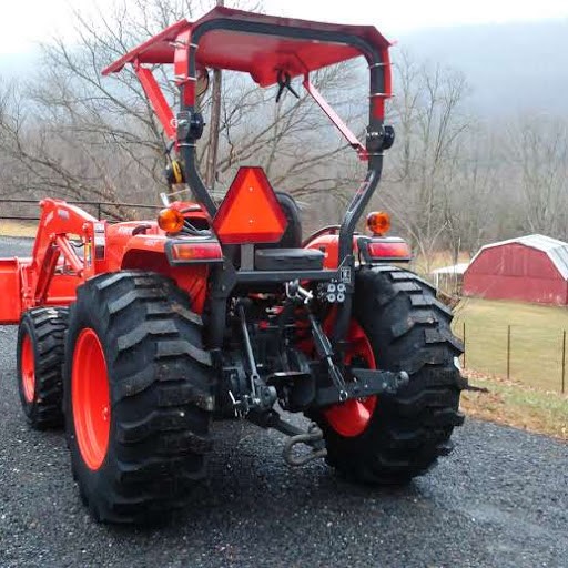

Made the roof for my L3700. It was a stretch but she fit the MX. 1/8'' formed steel with 2" angle supports.

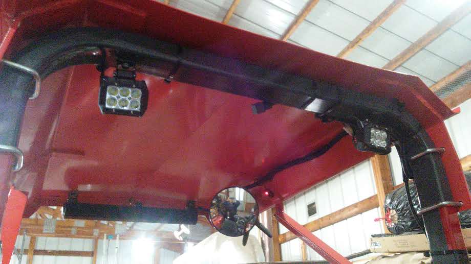

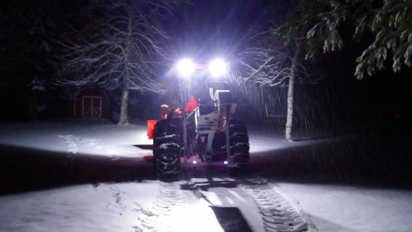

25" bar light in front and (2) 4'' in back. They all work off a remote and can use as backup lights when on trailer. I have a dump bed on my truck so the front light won't blind me;-).
They also have a strobe function. That will come in handy.
No clear light mount pics but you can see how I had to spread the roof an extra 2-1/2'' to fit the MX

Looks great! How much were chains for your MX? Where did you buy them from? I'm looking for a pair for my MX5200. Can you get some pictures of the mods in good lighting? All you can see on the first two is snow and bright lights. It'd be great for the rest of us to see the actual mod. Thanks!

Bright Lights is the point:D
Tirechains.com Bought originals for a B1700, bought the L3700SU and extended them. Now the MX, had to extend them again. So probably $500 by now. LOL
I'll work on those pics:)

More pics of modifications:
Front light bar
Rear lights and mirror

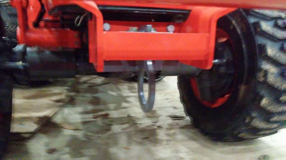

Front chain tie down for hauling on trailer
Rear drawbar with 4'' offset to use clevis that doesn't interfere with PTO while hauling on trailer.

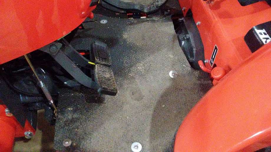

1/2'' rubber mat on floor
