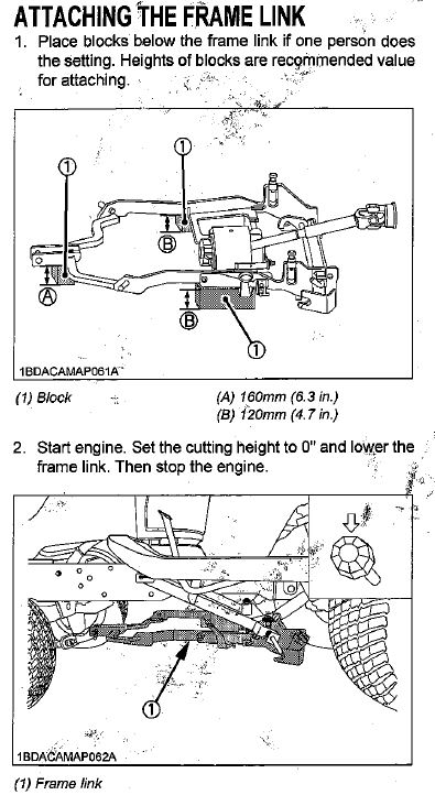

I have the BX2370 with the 60" drive-over deck.
So I'm somewhat familiar with the MMM linkage and PTO shaft setup - but I can't see anyway to knock the PTO shaft out unless something is broke or bent.
Be sure to check for bent/broken parts - and a misadjusted frame. Picture just to illustrate what this setup looks like - for those who don't know (not intended for instructions to check your frame installation)
The frame Link shown stays on the tractor when the MMM is removed. The PTO shaft is supported on both ends with MMM removed so no harm if it is spinning without deck attached. Although it would be better to disengage mid-PTO if only rear PTO is being used.
