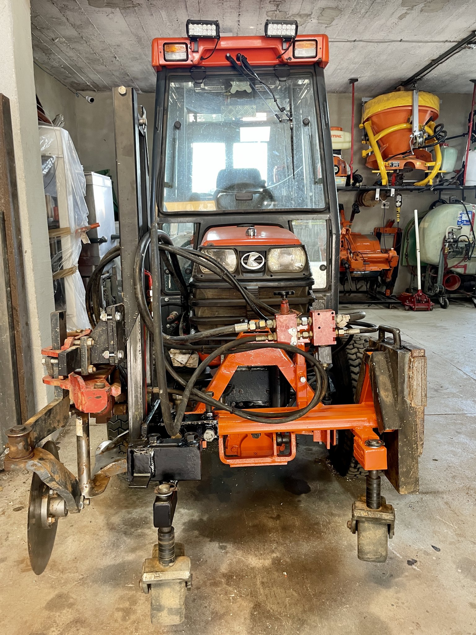

Thanks mate, I love to do stuff like this but again, it is important that it is functional and it eases my life. :) There are some video links up the thread of it in action when I had it built on the back...

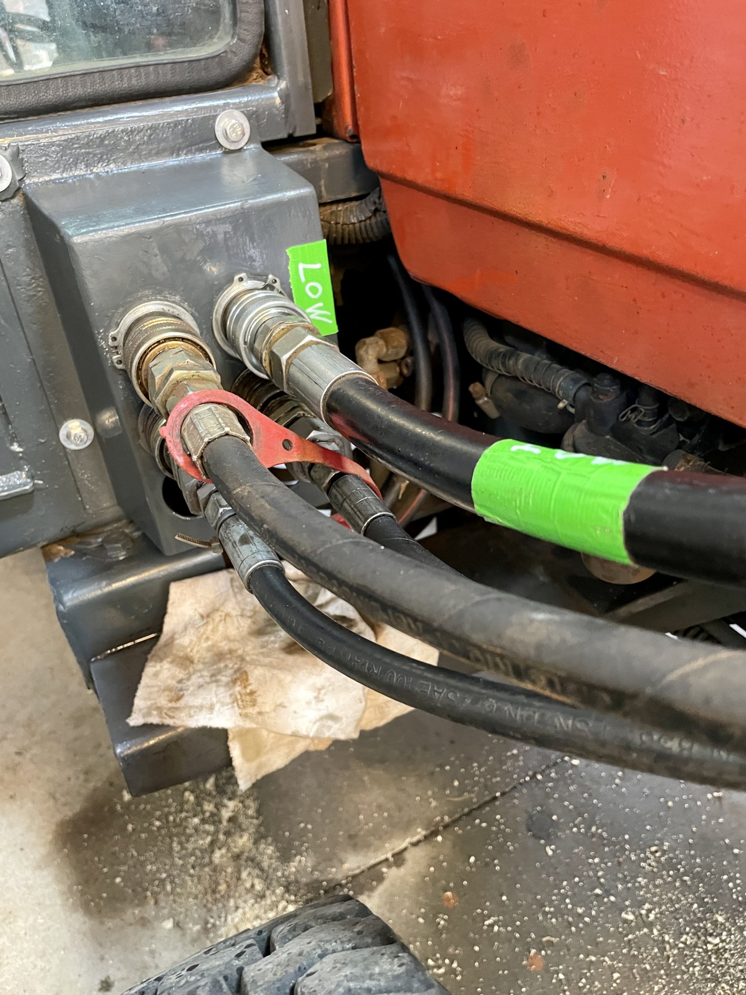

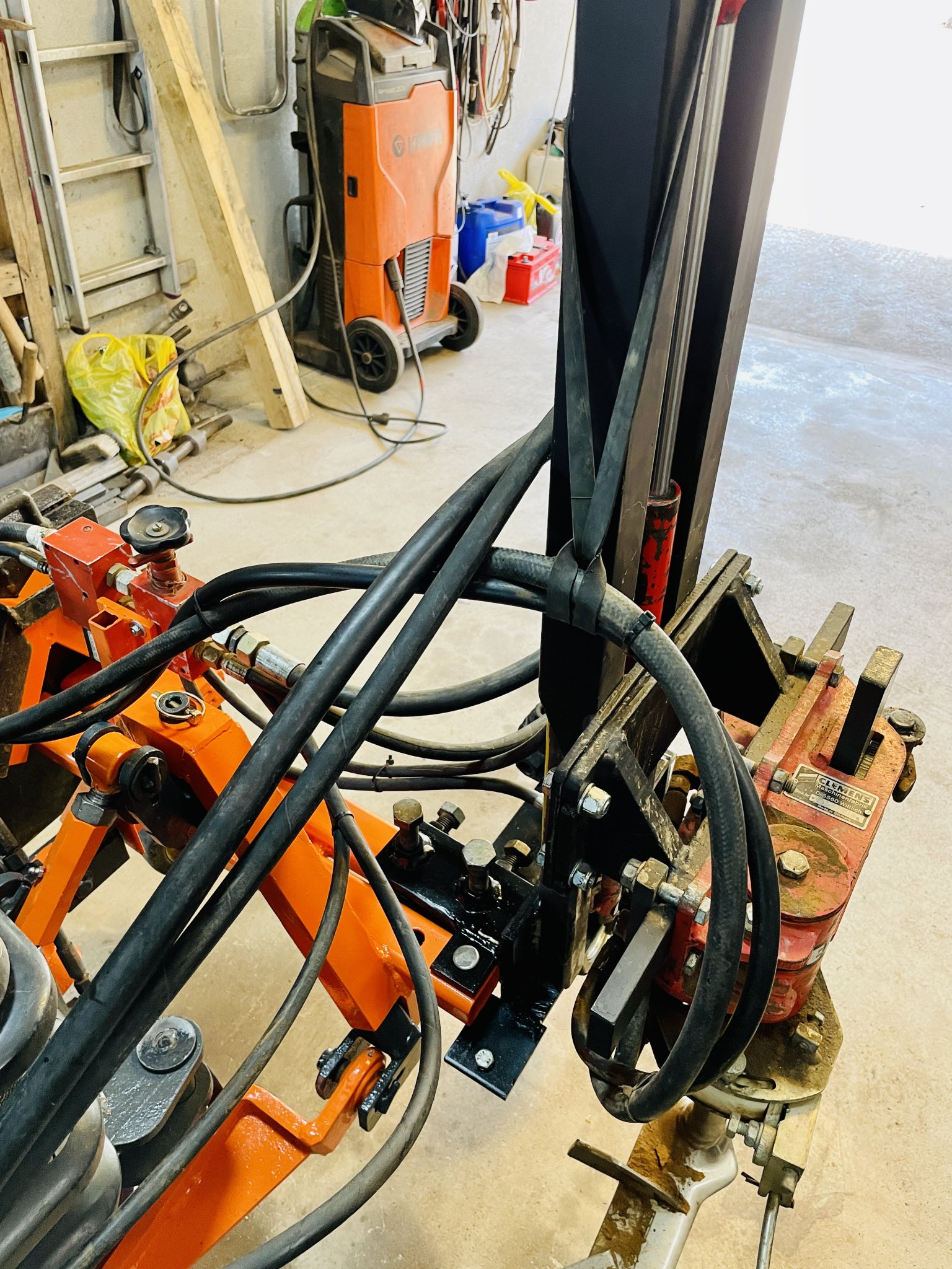

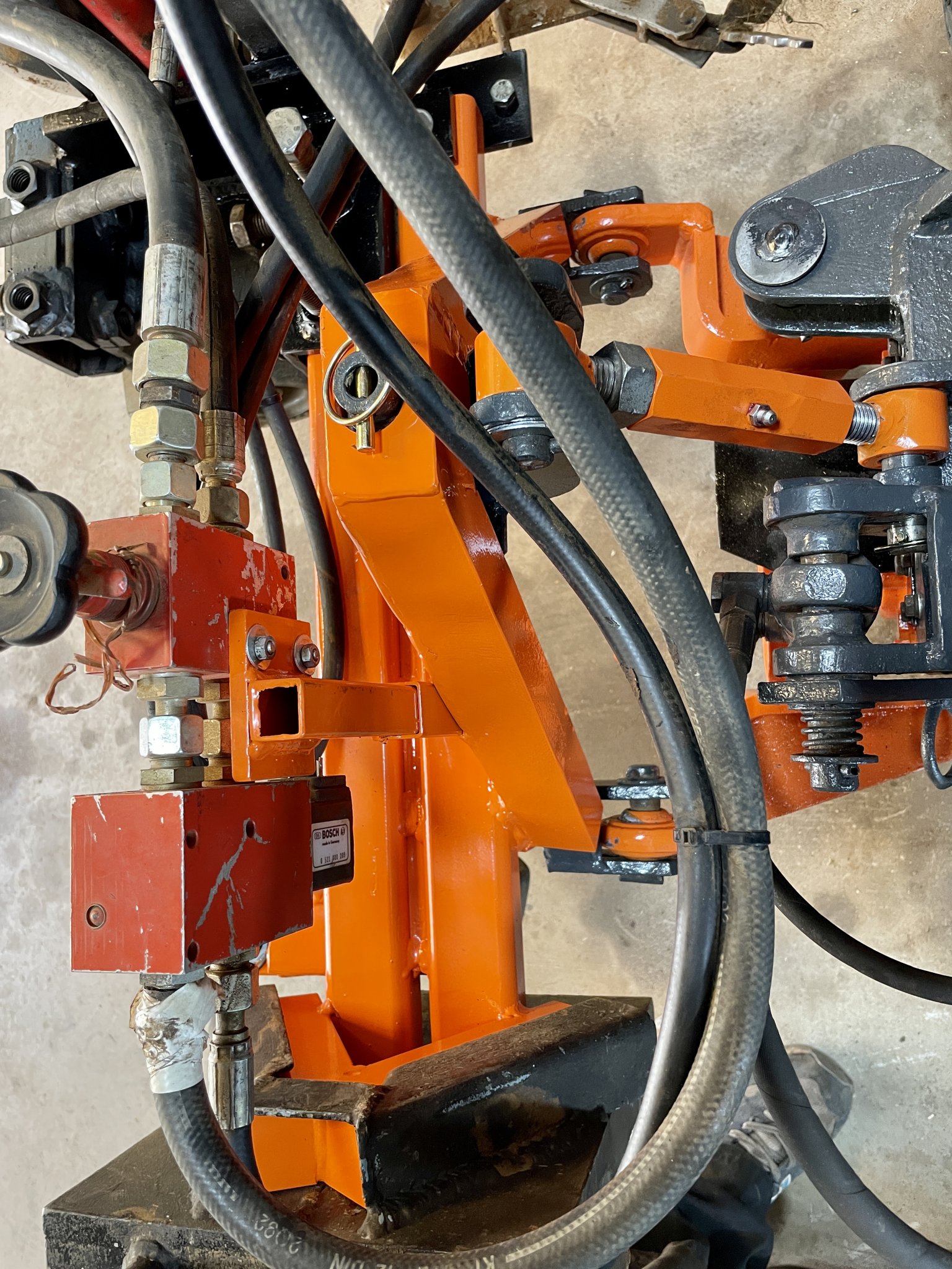

Some more photos from today, painted everything and some minor tweaks, had to install a different solenoid and power, had two new hoses made and hooked them up under the tractor up to the front... all tested in the garage, works great. We will see it in action in the vineyards, next week, I hope, when the rain is over...
